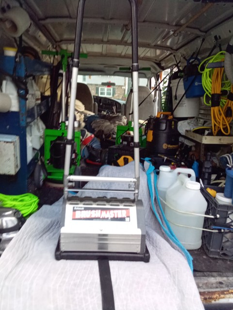

There are guys out there getting paid to clean carpet just using a Oreck Orbiter and the VLM Method
That's another reason why I like OP's and CRB's
Looks much more Professional than a buffer and you get better results with a CRB and OP
A good CRB like the 14'' Brush Master Pro 35 does all the work. It has a faster brush rotation, is built like a tank and heavier than most CRB's. The added weight makes a positive difference. It makes it a more aggressive scrubber and helps it dig out all the crap the vacuum misses
I can't imagine using the VLM Method without using a good CRB
I used a CRB when I was HWE
HWE - Prespray CRB Wand
VLM - Prespray CRB OP
NOTHING beats a CRB with the right brush for scrubbing
And a CRB is CRI APPROVED. I think ???
LEESS water MORE agitation !!!

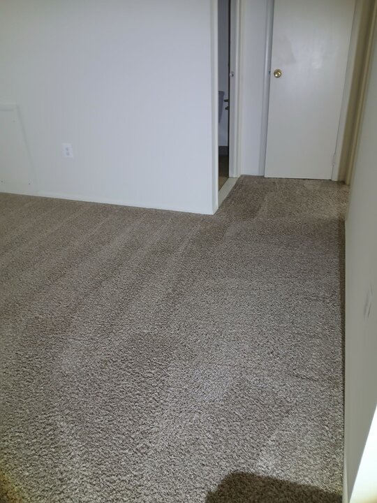

Looks good for what it is, but calling that “extraction” is doing a lot of heavy lifting.
Two bedrooms, hall, living, dining on 3 gallons total isn’t flushing soil, it’s lightly dampening fibers and moving stuff around. True extraction is about rinsing and removing suspended soil, not just scrubbing in encap and wiping the tips with a bonnet.
VLM absolutely has its place, maintenance on CGD, interim cleans, etc., but using it as your only method on residential and comparing it to HWE is like using dry shampoo and calling it a shower.
I always chuckle when VLM guys use terminology like “extract.” Smear, disperse, or hide would be a lot more honest. 😄

Your VLM picture doesn’t prove what you think it proves. Sure, there’s a visible difference. But is it actually clean? No. I can vacuum a hammered room and have the homeowner walk in and say, “Wow, it looks amazing!” and I have to tell them, “We’ve only vacuumed, we haven’t even started HWE yet.” By your standard, that’s done, because it looks better and the customer doesn’t know any different. Just collect the check and move on, right?
Like I’ve said repeatedly, I’m not anti VLM. We use it. It’s a tool. It has its place. It’s just not the magic answer to everything, and it doesn’t replace proper cleaning.
The carpet in your pic is disgusting. I’d hate to think there’s a baby crawling around on that, VLM clean, but I’m guessing that doesn’t bother you much as long as you didn’t have to buy a truckmount and the profit margin looks pretty.
