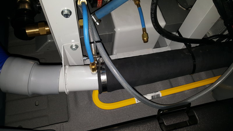

are you using 2.5 hose the first 50 feet off the truck or 2 inch?
i ask because i just looked at mine and noticed it has 2.5 coming down from the waste tank to towards the panel mount but chokes down to 2 inch for the port.
i think i will head over to the shop and have some fun with the plasma and weld me up a new 2.5 pipe for the panel mount, if i have time.

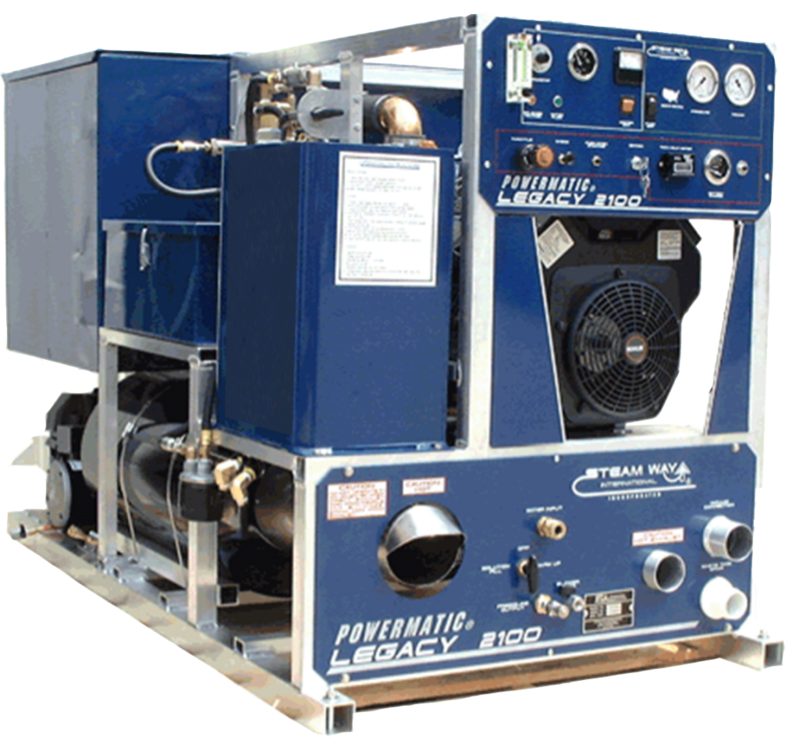

It won't heat up at all if you don't put a load on it. You have to warm the machine up around 10 HG while setting up your hoses. If you're doing 3-4 jobs per day it gets hot. It should hold 210-220 on stairs and upholstery. If you want more heat you have to go up to a bigger unit that burns more gas.

Call me old fashioned. I still use 2.5 inch for 50 feet and then 2 inch to the wand. And if that is not heavy enough, I use 3/8 inch Goodyear Neptune pressure hose. No titanium wand either. Still using the Greenhorn 5 jet.
Never have run a heat exchanger truck mount. Now that is really old fashioned!

Loren, I use to work for a company in Denver that had that same Steamway Powermatic 2100 back in 1994. It had a kerosene burner. Even though they perform well, I don't like fuel fired burners. To much liability IMO
