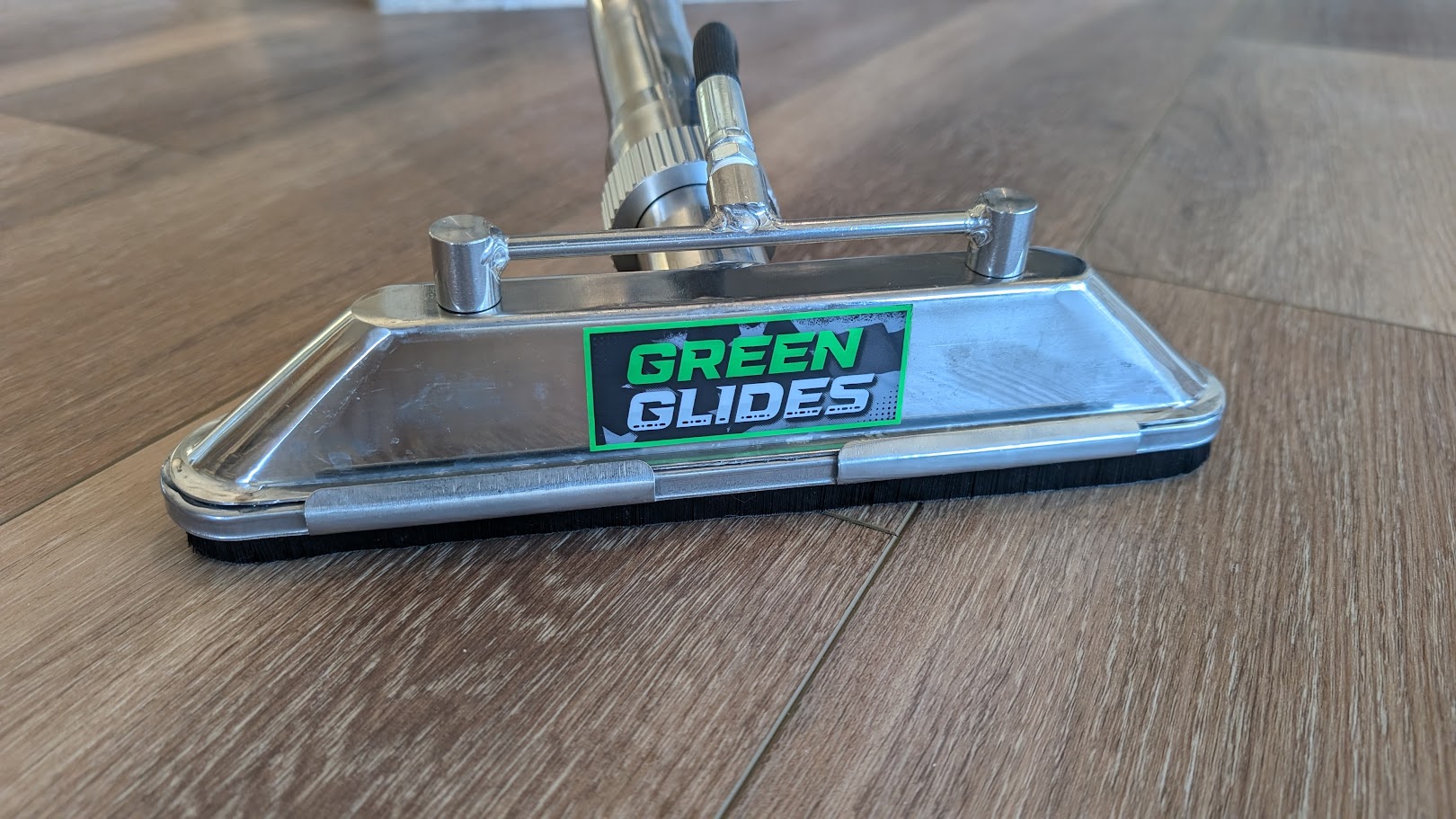

Speaking of wet passes...
I watched a bit of Mark's new HS video.
Tom's $1400+ HS wand leaves way more water on the floor than the World's Greatest $420 HS wand. :eekk:
At the RMH we were playing around with it on some LVP at 1000 PSI and it was leaving the floor 99% dry with one pass.
It's also much lower to the ground and gets all the way to the edge under cabinets unlike Toms, and there is no blow out through the side brushes due to perfect jet placement.
Had this wand been out from the beginning, I would have never bothered with making brush glides and Tom would have never made that $1400 wand. Fact.
View: https://www.youtube.com/watch?v=NKGaXH0qFpI
