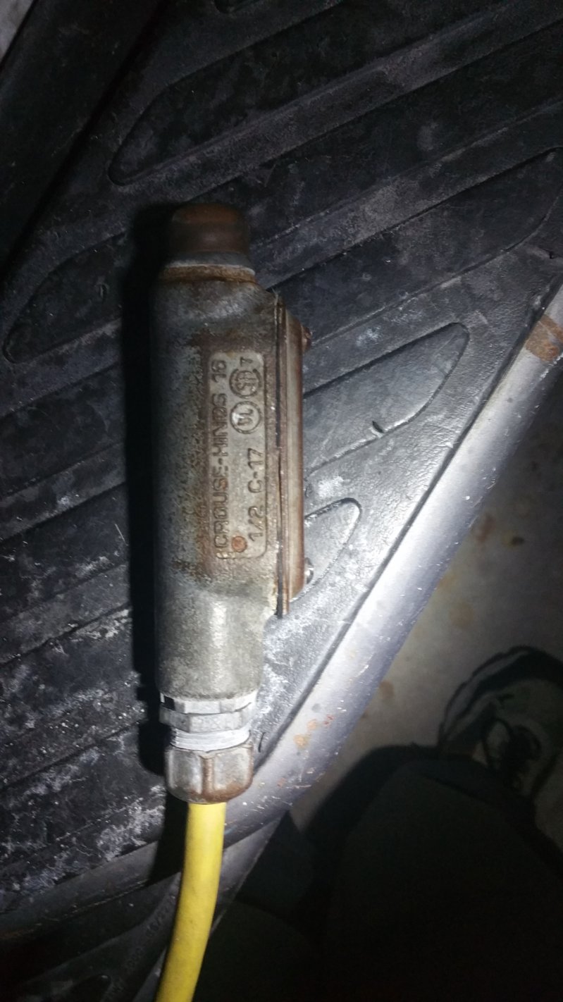

that push button switch does not break as easy as you think..and the last thing I want to do is to have to lean into a reel to push a button....2 broken teeth and a permanent blood blister on my lip is what happens when you are forced to stay to close to the reel holding down a button and a cuff breaks....that is the entire reason I go with a heavy duty hand held switch..so I can stay back from the reel....and still control the wrap of my hose.......

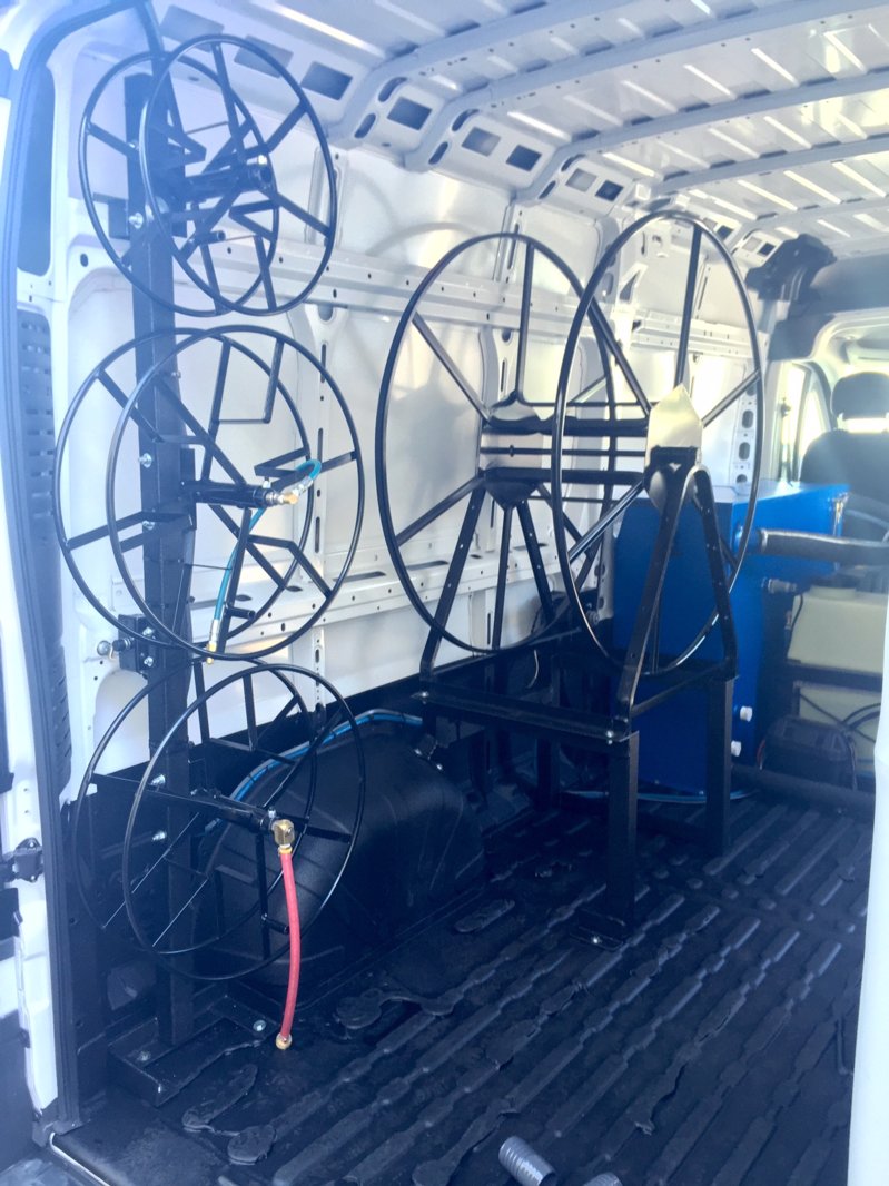

My new set up with a better hook up to the front now...

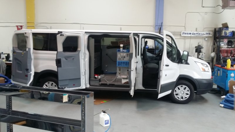

I really, really, REALLY like my vac hose reel out the side, but that is a sweet set-up with the shelving like that.
50,041
I really, really , REALLY DON'T. I've always worked out the back and this new TM I have is a side mount.
Of course, I didn't care for the Zipper much at first either, and love it now. So, this side door set up may grow on me eventually.

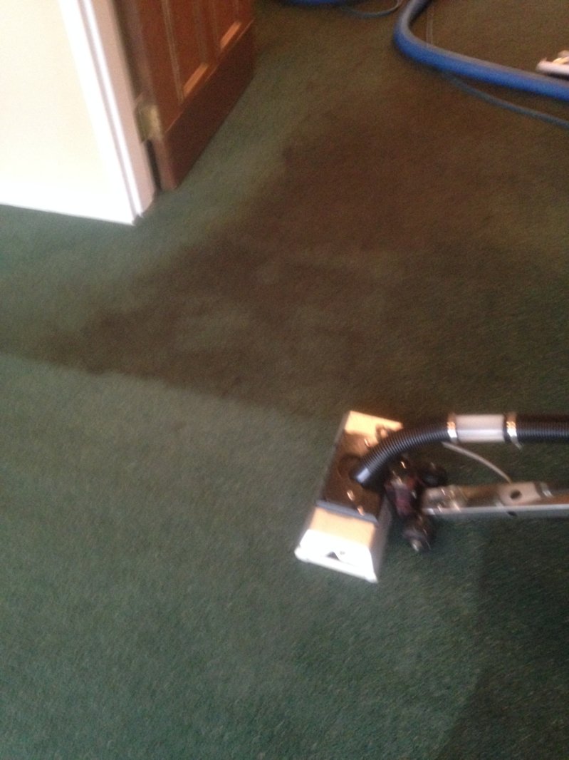

Some side door Xipper work this morning:
