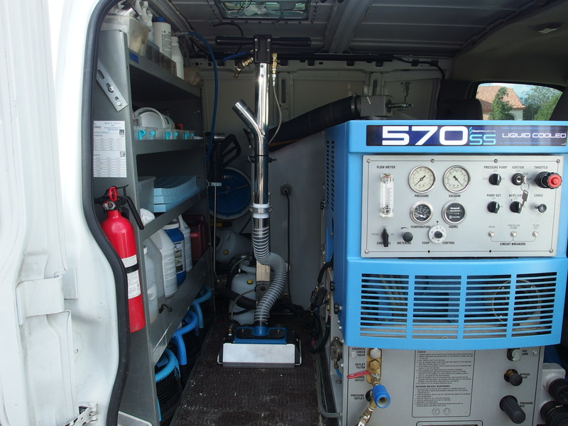

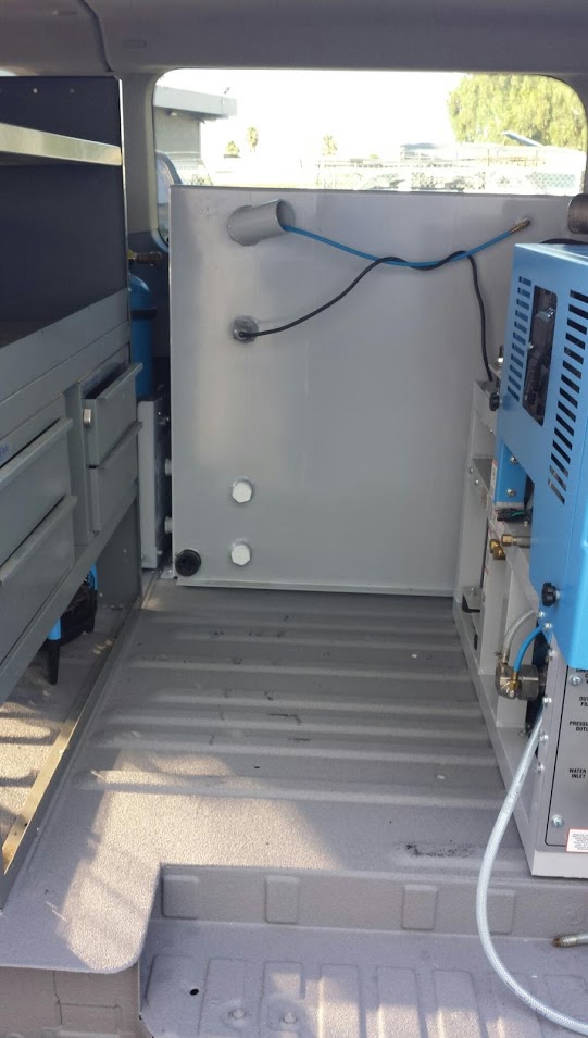

How is that hose reel going to make your oil changes? I almost wish I would have nixed the submountt on mine and put my hose reel there. But I like the reel out the back too.
We are going to move the drain tube to the other side of the crankcase. The tube will be between the seats.
Reactions: Charlie Lyman
117,039

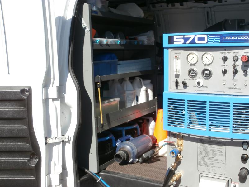

Adrian Steel shelf kit.
Oil change access is behind the passenger seat
Yes, electric reel from Rokan.
Jim Martin
Jim Martin

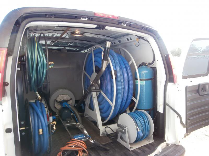

you need to flip the shelf....and put the reel in the back...
your going to break your knuckles on the back of that shelf when you have to reel up your hoses...not much breathing or service room if you don't pull all your hoses off of the vacuum reel.....and your going to be cussing yourself out every time you have to get your big self in and out of that van just to get something off the shelf if it is pointed backwards..........
117,039
I really don't want the reel in back, maybe putting the vac reel on the left and the small reels on the right..
They must come off easy?

Definitely the second way!! Servicing it the other way would suck because you would have to remove the reel.. I still would push the vac reel back as far as possible and do something else with your solution hose..

Is that a mid height van?
I never liked the hose reels on the floor that's prime space right by the door..
Edit: looks to be standard height.. I would stack them on the right side or put them on the doors or mount them to the ceiling..

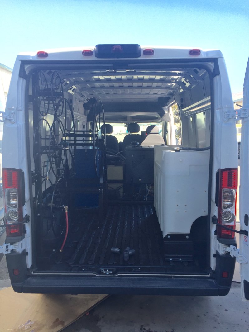

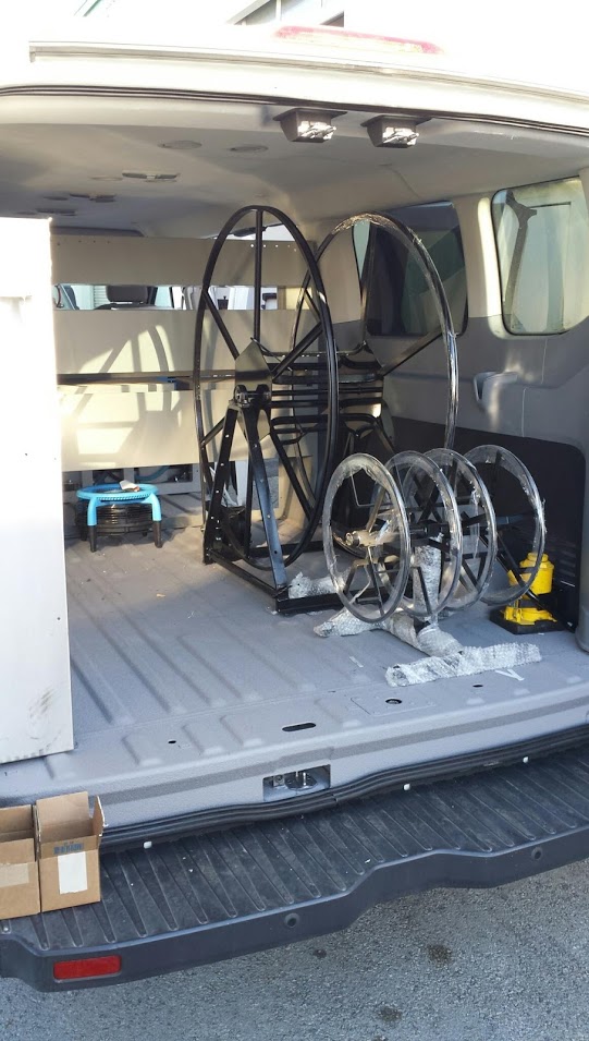

Get rid of the floor bracket and do not use a stack bracket. Have rays guys make you a stand or call me and will will ship one already made ray might need to cut it down as I don't know the height of that van. Worth every penny of the $175 we charge. That's lined.
Reactions: Cleantechsk
117,039
it's a passenger van with upholstered ceilings (with hvac and lighting)
117,039
Photo?
John Olson
6,281
John Olson
The solutions stands this one is for trailers or tall vans the standard holds 2 300' reels. Jim has one he made. We used to powder coat the but lining is actually more durable
117,039
Ray, can Jr build a tower bracket like Johns?
I really like that idea, frees up 2 square feet of floors space

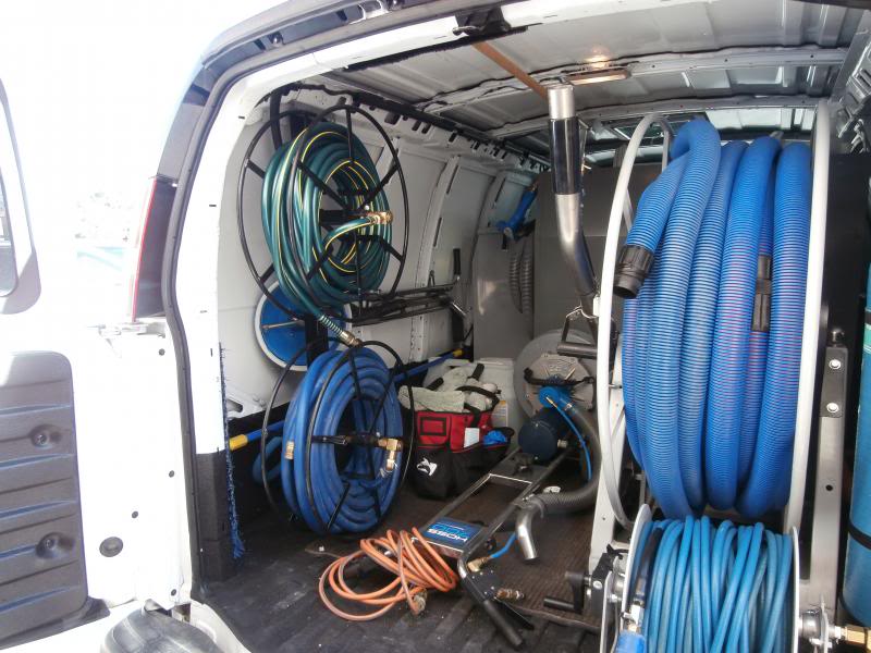

Since you are not carrying water would go to the left with John's style reel deal and to the right with the powered vac hose reel and push it as far back as you can.. In the pic John posted, you need to be in the van to get the hose on the reel right(or it will spool on the right side of that reel)..

What side would you want the reels? Looks like the vac reel is a long reach.
We can build any thing.

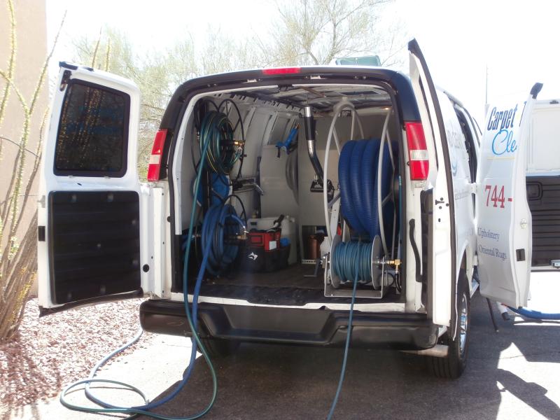

when I made mine I made sure that the vacuum reel was on the curb side and the smaller reels were on the street side..that way I could just move the lines over and shut the door on the street side and not have to worry about the wind or something blowing them open and having it hanging out in the street......

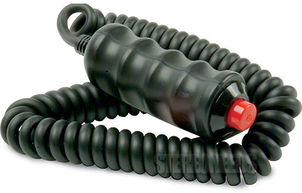

He shouldn't have to reach anything.. Put a switch on a tether, either foot activated or push button.. Only spool it so you can reach the vac hose.
Understood and that's the plan.
Don't want the customer climbing in to the van to spool the reel when they use all the hose. It has to be within arms reach. IMO
