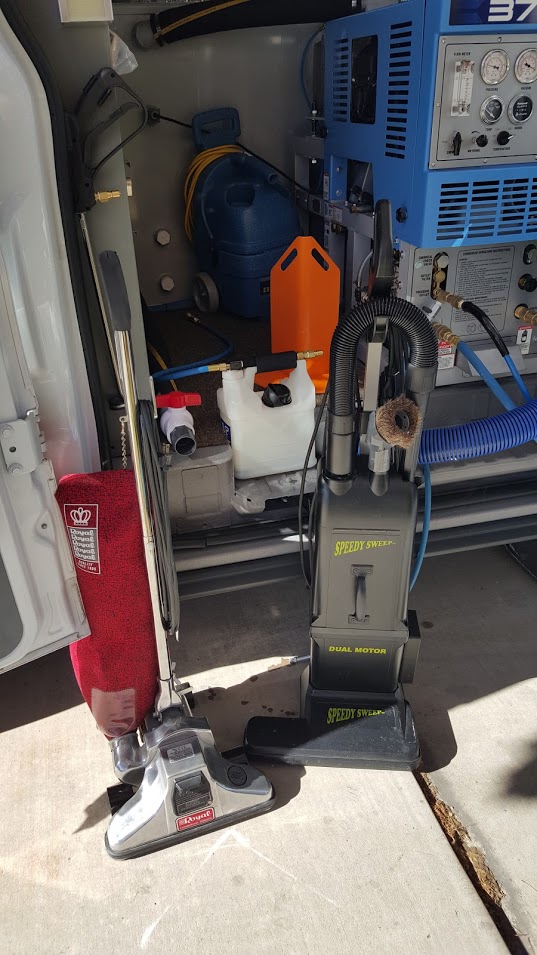

I used the Proteam Vacuum first for edging but I was not happy with how it was NOT digging into the matted pile so I whipped out my new to me Royal. This was my first time really giving one a go and I was very pleased. Much like a Kirby but feels so much lighter. Almost like using the Brush Pro 10" actually. Dug and fluffed MUCH better than the Proteam...Really no comparison on this carpet..

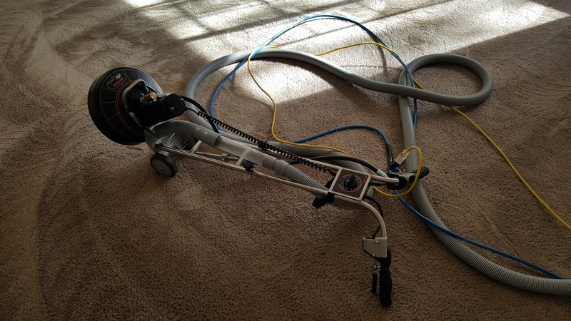

After vacuuming I proceeded to prespray with a mixture of Procyon and a Harvard Pet/Deo that Sagier sent me,(thank you very much) at 320 PSI.
Followed up with the Brush Pro..

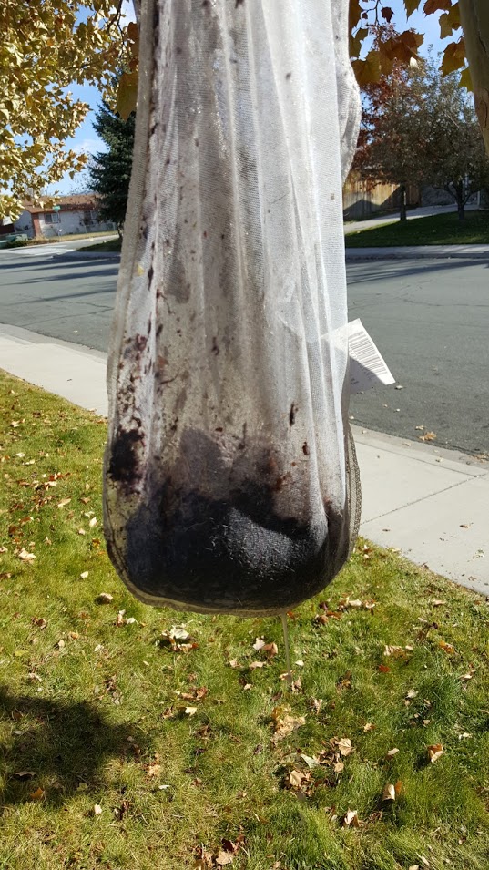

Even after the two vacuumings I still dug loads of crud and poly fiber out..

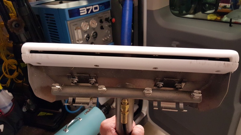

I used the PMF Mach 12 on the bed rooms and edges in the living room and tested out the Rotovac 360i with the brush head to deal with the heavy matting..
The 370 never skipped a beat and when ever I went out to the truck the heat was at 220. 50" of 2.5, 15 of 2" and 25 of 1.5. A total joy to use the Mach 12. So easy to use, only way to make it better would to have a Tom swivel on it. Fantastic airflow and thanks to the two piece glide, it has great edge cleaning and crud pick up with it's wider than normal opening.
Much like Tom's wands, this was created to only be used with a glide so the vacuum port is considerably wider than (most) wands that glides were an after thought for. Big difference and something all other wand manufactures should be implementing in their future designs.. (pissst, the future is now btw)

Hard to tell but that lump was the size of a cantaloupe (or a baby head for your meat heads)

that was a solid lump in there.
The renter asked if he should post vacuum
Dont bother I told him..
So if you vacuum, CRB scrub then pad you would have left all that in the carpet? Was it a new filter and new hoses or was there hair in the hose from the last job ? I am always amazed how much junk I get in my Dev Filter even after vacuum and CRB
116,024
no I used a groomer when all done
I did wand/dry stroke over the RVi"d areas though.
again, I only used the RVi in the LR,, all other areas were "just" wand rinsed...
11,304
I've gotten amazing results with my 10 CRB its to easy and really digs crap out, yes a 175 has its place but at well over a 100lbs its a pita for carpets and it doesnt do steps.
The crb makes wanding easier because it pulls more stuff out. I've done a few hammered carpets nuked it with juice and scrubbed, rinsed and looked like new. Its better on pet hair and embedded crap. I have a hoss on one truck and a 360i in the other. I love those, but I think the CRB is my new favorite tool. Thanks Mark, Mike and Rick G. at excellentsupply.
