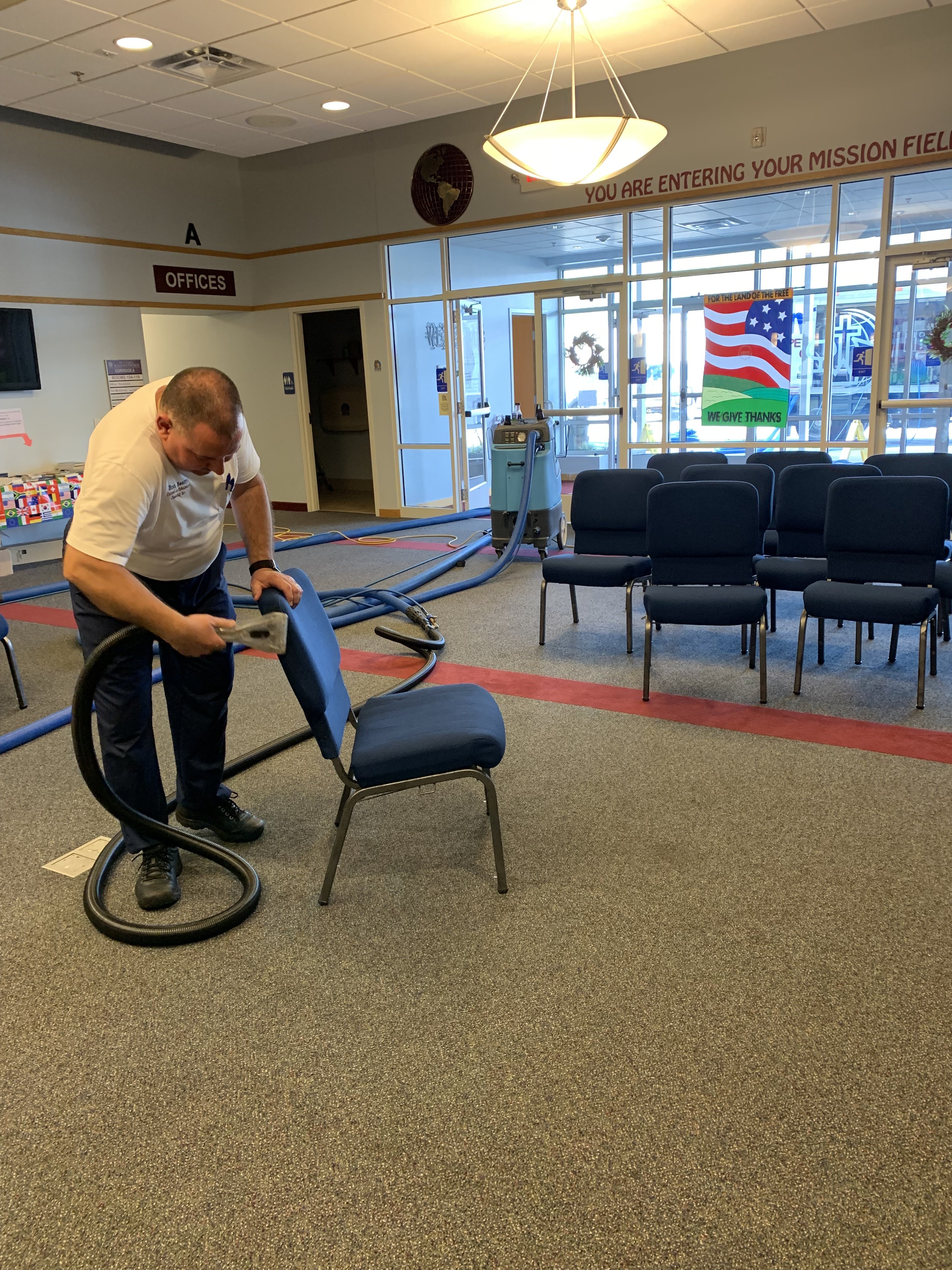

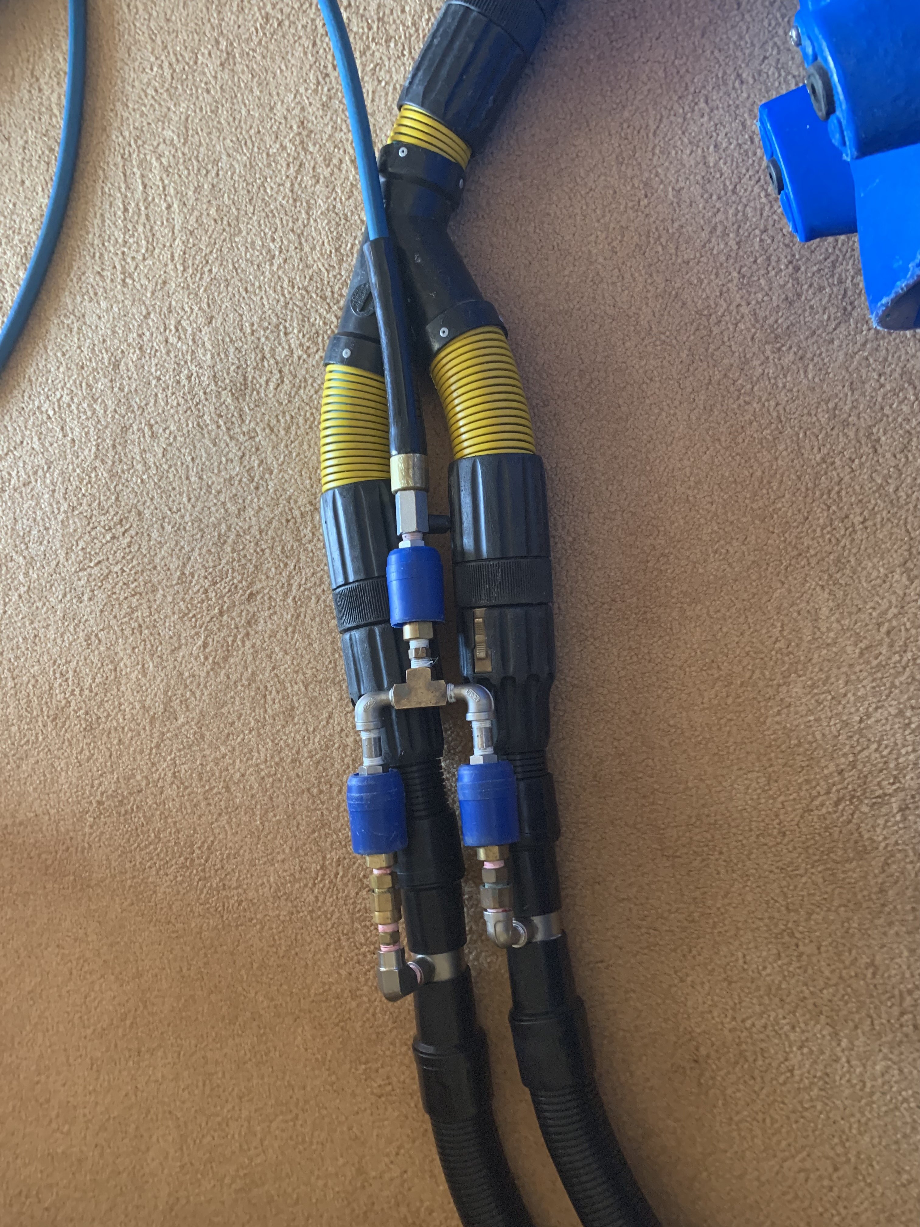

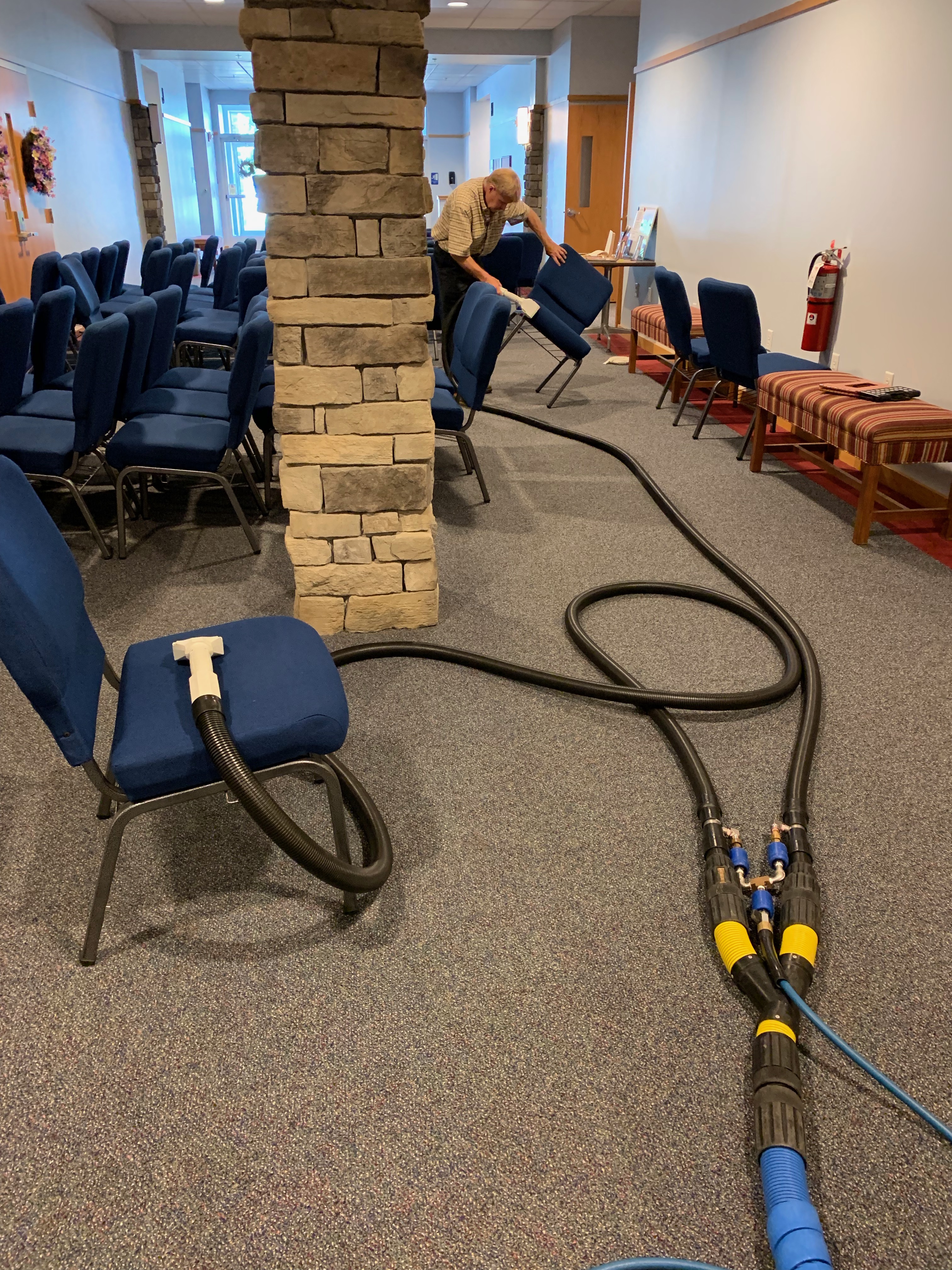

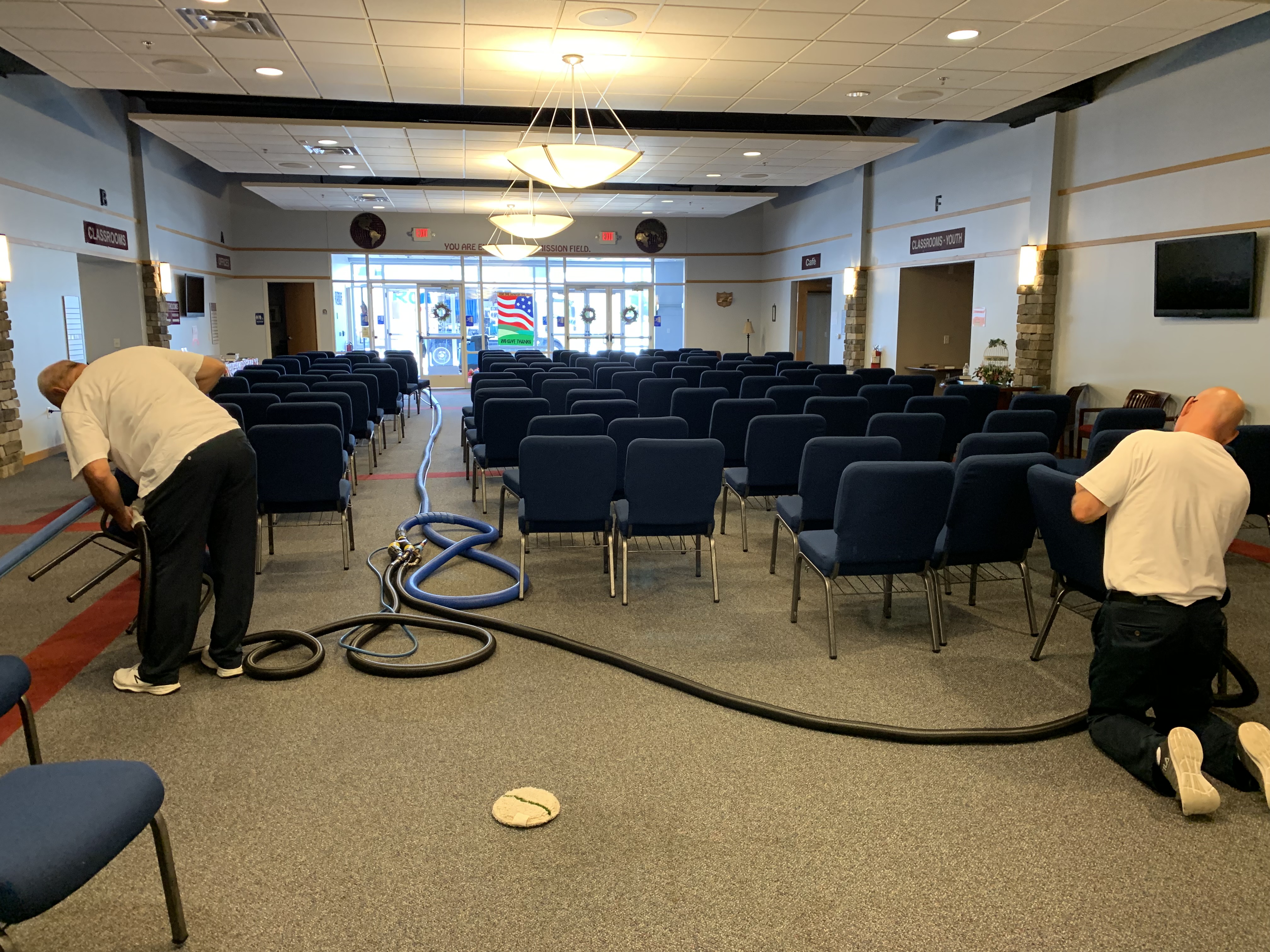

A couple weeks ago we cleaned 350 chairs with Drimaster upholstery tools and a sapphire I modified to make 20ft long. Worked out great

We clean 1200 chairs at a local mega church every year using our truckmount and dual Kleenrite upholstery tools.
We also clean their sanctuary every Halloween at 10:00 PM, which is 14,000 square feet. We run 3 wands and 2 truckmounts.
When you run dual tools, do you run 3/8" ID solution line, or 2 separate 1/4" solution lines? When we run dual wands, we need the flow of 2 separate solution lines, or we could use just use one 3/8" line and split that off inside to 2 tools.
Goes twice as fast as a single uph tool or a single wand!

When we dual wand I run separate 1/4” lines to each wand. The Hydramaster tools have a restrictor washer after the incoming filter, we run two upholstery tools off a splitter and have never had an issue.

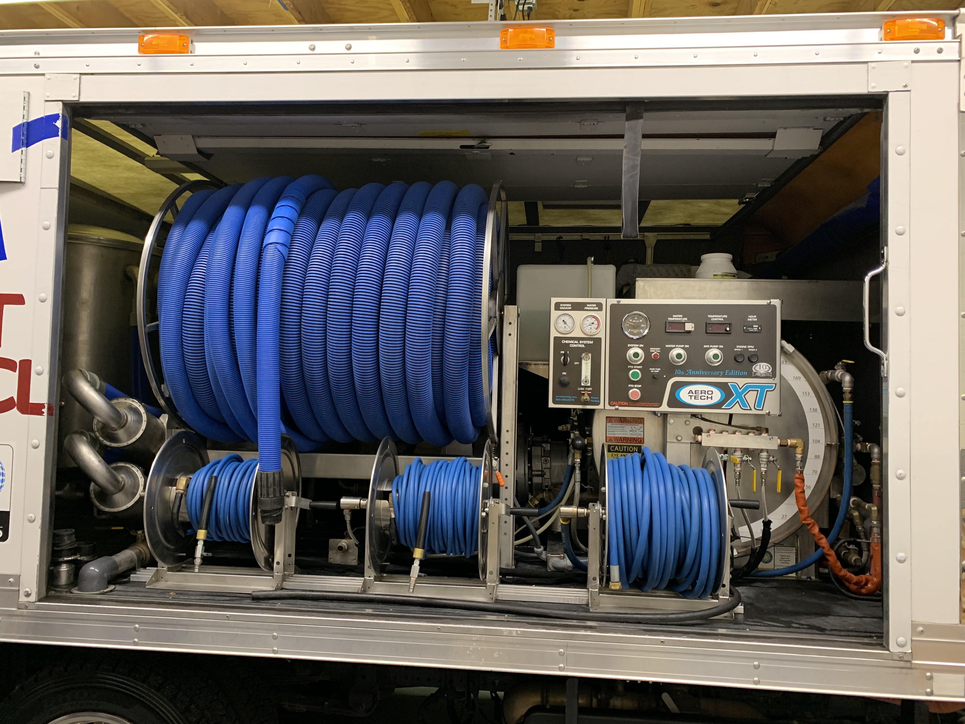

Great set-up. Odd you didnt just use the AT and forget about the portable.
The waste tank on the AT should have 3 vac ports, but only 2 with filters-- thats the way it was on my V.
