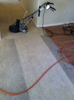

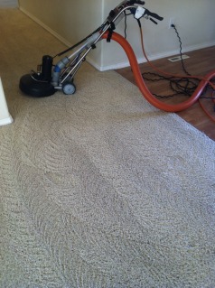

40 Vol from Sallys made this a quick job:
15,218
Ne
It's called CLEAR DEVELOPER .....not CREME.
And I suspect it's the same thing as Cobb's but he has to mark it up a little to make any profit.
