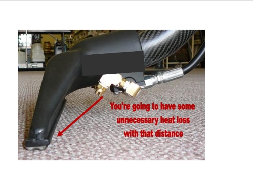

I know Ruff Hewn likes it and we usually agree on a lot of things but I can't see it. :confused: That's a dork wand, best for some limp wristed lispy speaking Neebrasscan. :p
Looks like too much potential for heat loss. It doesn't make sense to want a hot TM then waste the heat with an old skool designed wand???? Sure its light weight but is weight really an issue. Shouldn't the head remain sealed to the carpet?
Whuts up with the awkward manifold too?
How much heat loss do you think is going to happen with that gap.. 1-2 degrees? I agree the jet manifold is a BAD design and so is the swivel, I already had to have mytee replace my head and manifold after 6 months of use. But damn there is nothing like a swivel wand.. and yes when you are swinging the wand all day the weight does matter. I get killer dry times with the bentley.
Never tested but just guessing 25-30 degrees in a drop like that?
WAY more than you'd ever guess, Brent
most never get anything close to 150 degrees to hit the fiber
There's a HUGE drop in temps from jet to fiber.
40-60 degrees in a couple inches ..fo-reel
(the hotter you start with, the more dramatic the temp drop)
get a digital meat thermometer and see for yourself
you'll be shocked ...just as I was

Wow, learn something new all the time.. I had no idea it water can lose that much heat being exposed to the environment for a fraction of a second.
That's why a lot of the wands keep the jets closer to the carpet. Although too close will cause corn rows that can be hard if not impossible to remove. :eekk:
Its a balance but why waste all your heat if you don't need to?
tHe stream being atomized is what causes the dramatic drop.
the drop wouldn't be near as much if a solid stream.
there's also a lot of other variables too...jet flow size, temp ATW (240 ATW will have a more dramatic temp drop than 120 ATW)
digi thermometers are cheap ..$5-6(?) bukz at Harbor Freight
Cheap enough that everyone could find out what "their" wand/TM combo is putting on the fiber

I don't use a meat thermometer but if my machine is running 240 and my temp ATW is 190 the 1 inch it travels to the carpet should be 10 to 15 degrees loss.
I know when I was diesel fired I could split seams, and my machine now will melt wax easy. I wouldn't touch the carpet after flooding the carpet with my wand!
I agree that temp loss will be less than 40 to 60 mentioned above.
With high flow, there will be less cooling from the airstream.

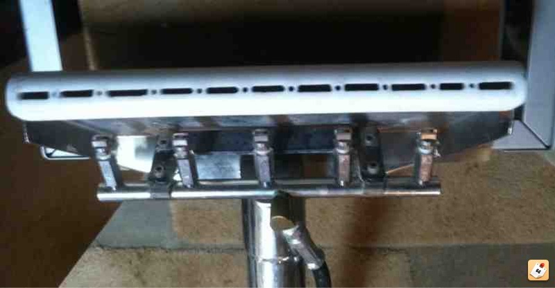

Another photo of the Bentley with 4 jets positioned to hit 3/8" from the head for quick drying:
We can put the jets where the customer wants them . . .
unlike other wands.
Larry
