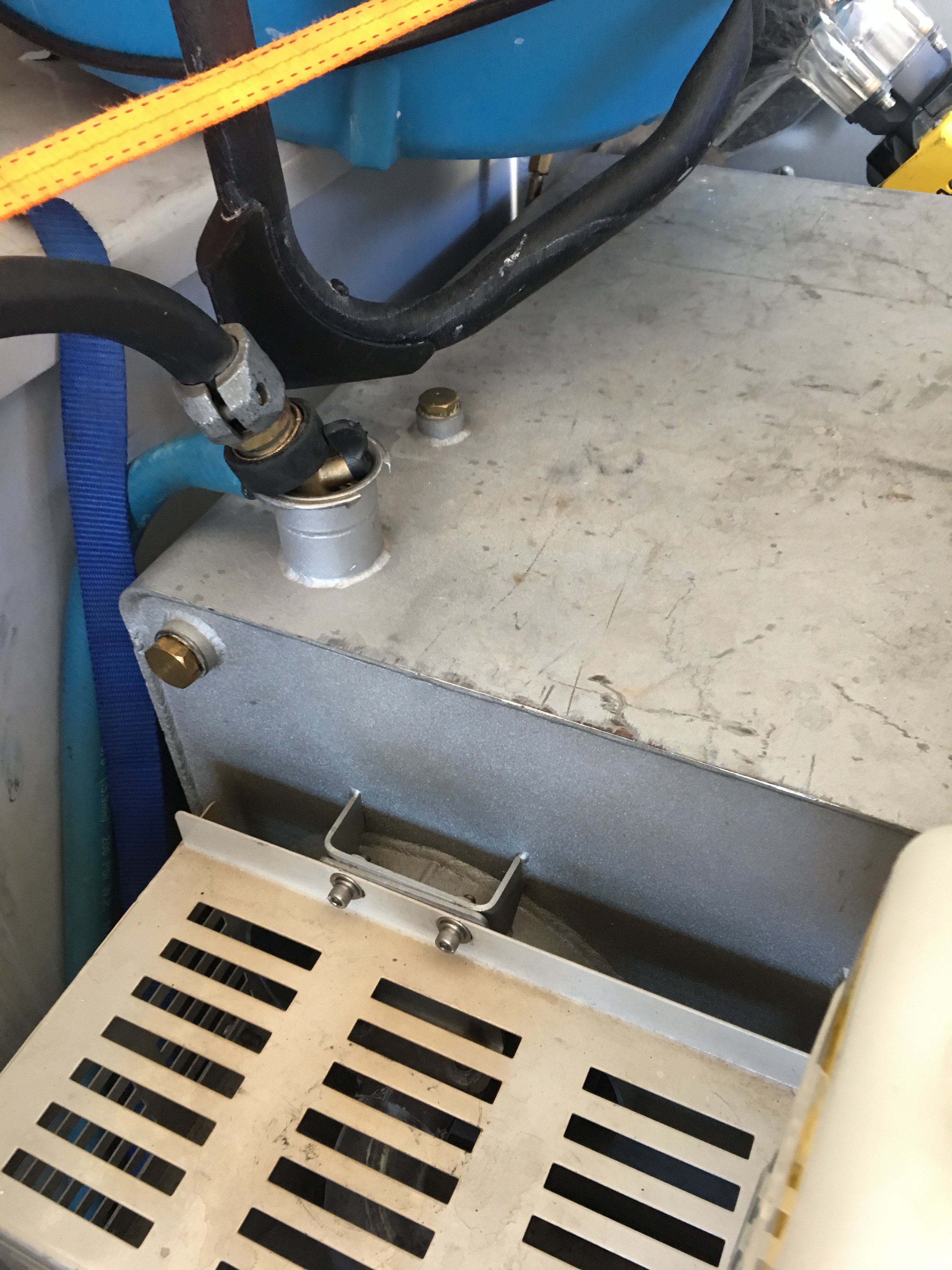

My waterbox only holds 15 gallons of water. I ended up refilling it manually as I progressed through the house. See pic below.

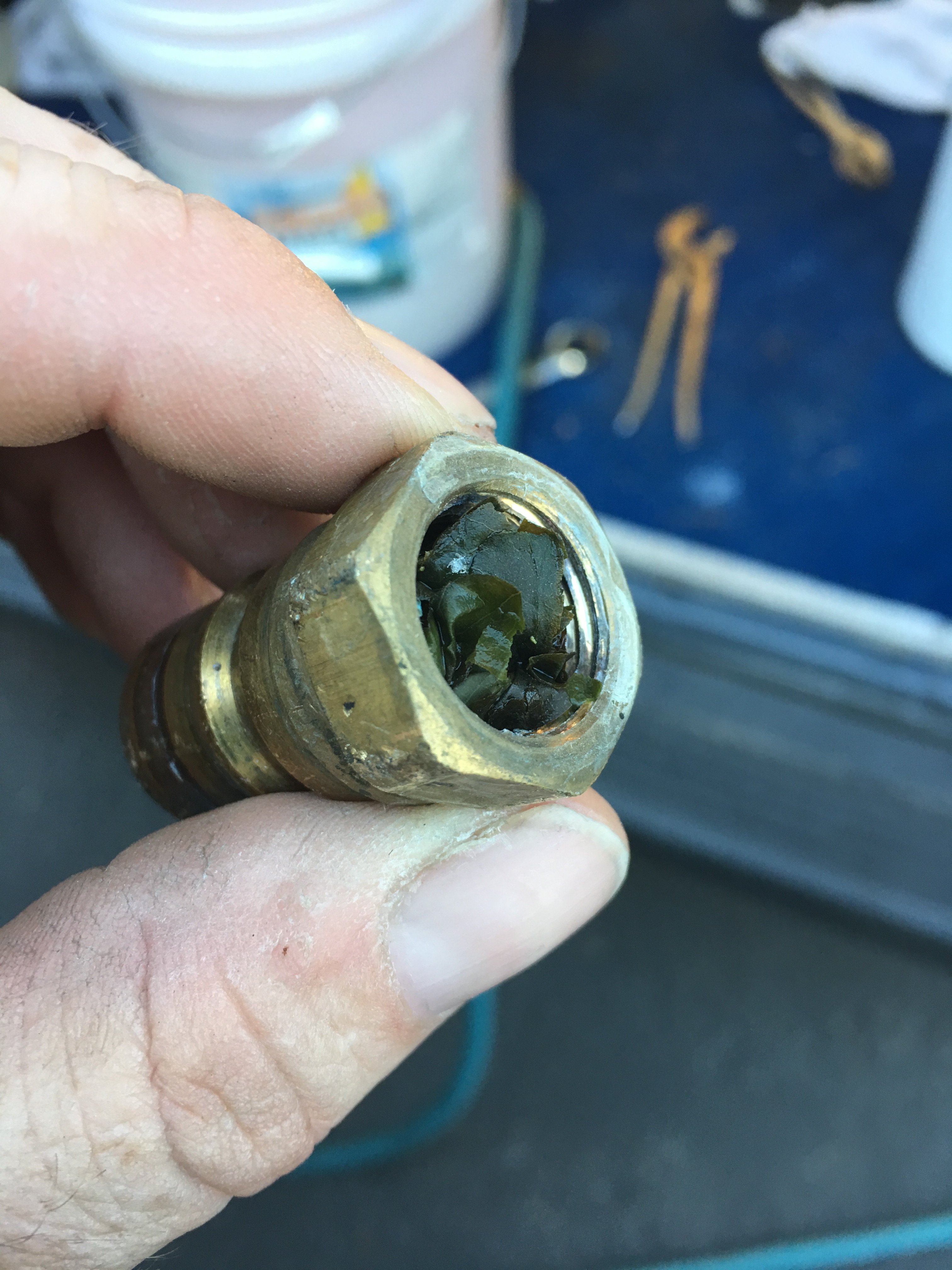

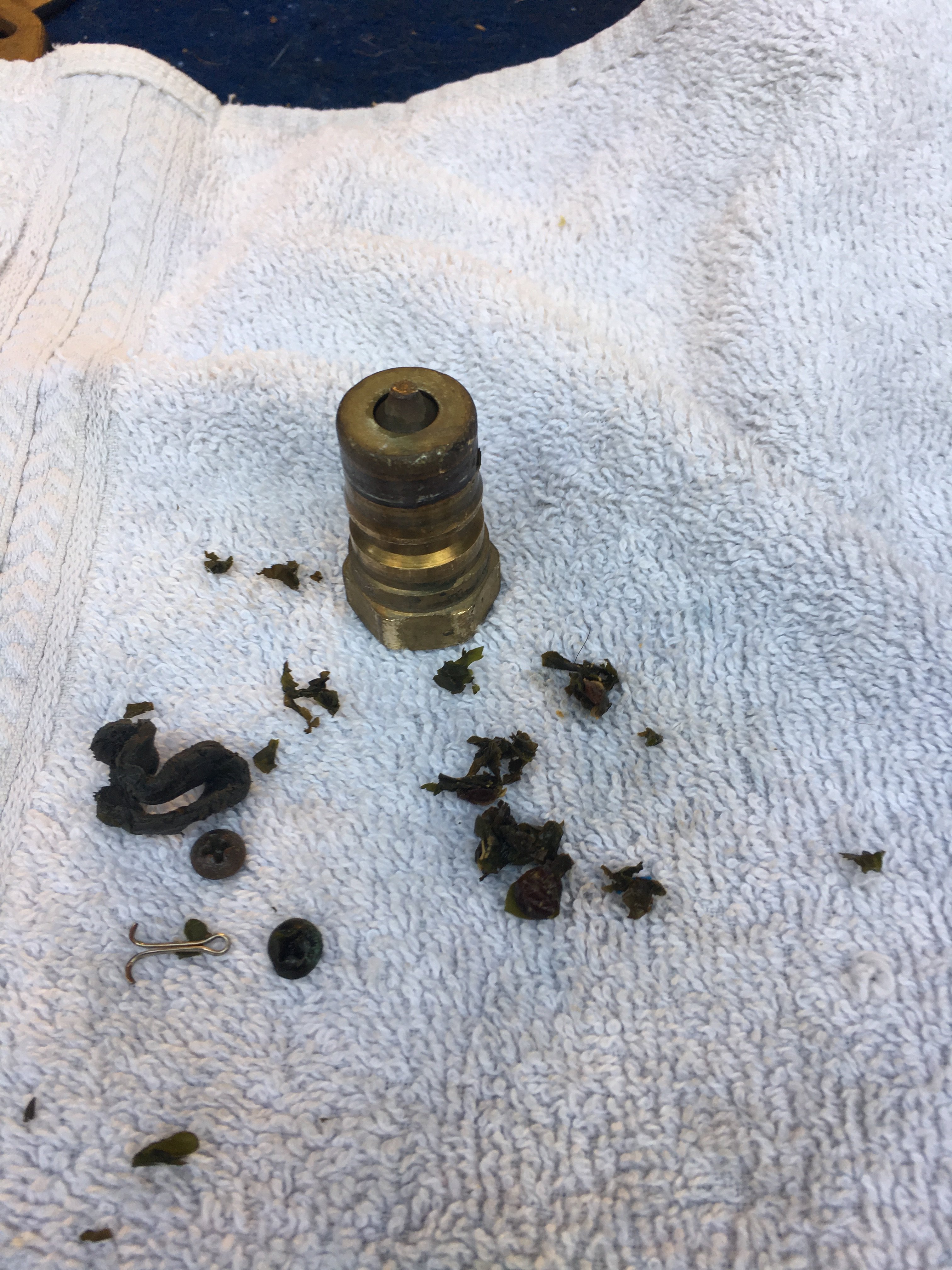

I returned to my shop and started looking into the issue. The water pressure at my shop is excellent. I hooked the water up and nothing was getting to the water box. After some more probing, I decided to take apart one of my QD’s on my fresh water supply hose. What I discovered was amazing. That thing was clogged with all sorts of exciting things. I pulled out two screw heads, a corter pin, rubber hose gasket, bug guts, and a bunch of leaves. The QD was packed so tight with debris not a single molecule could pass. After a good cleaning, all was back to normal.

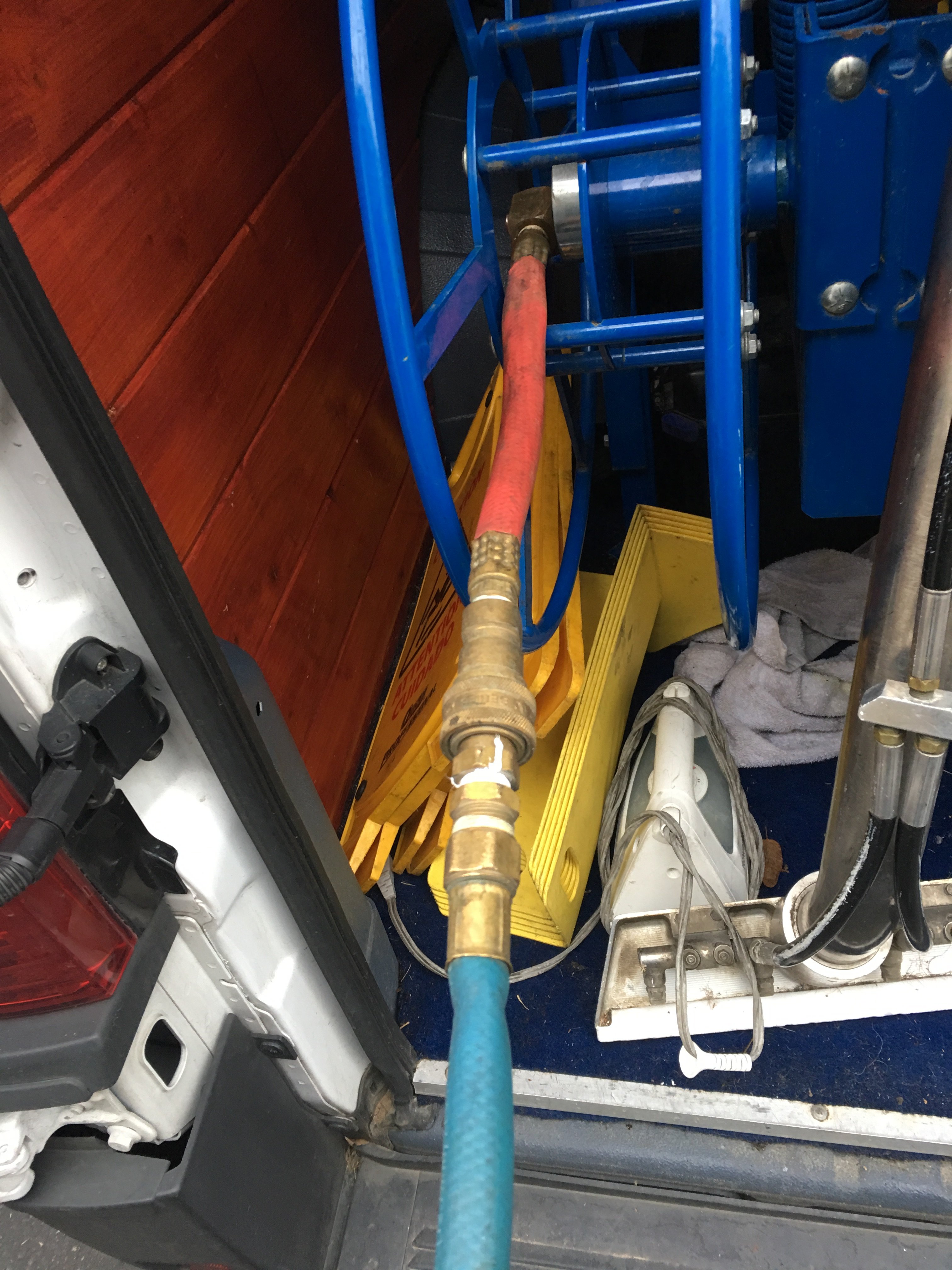

QD on live hose reel that goes to house.

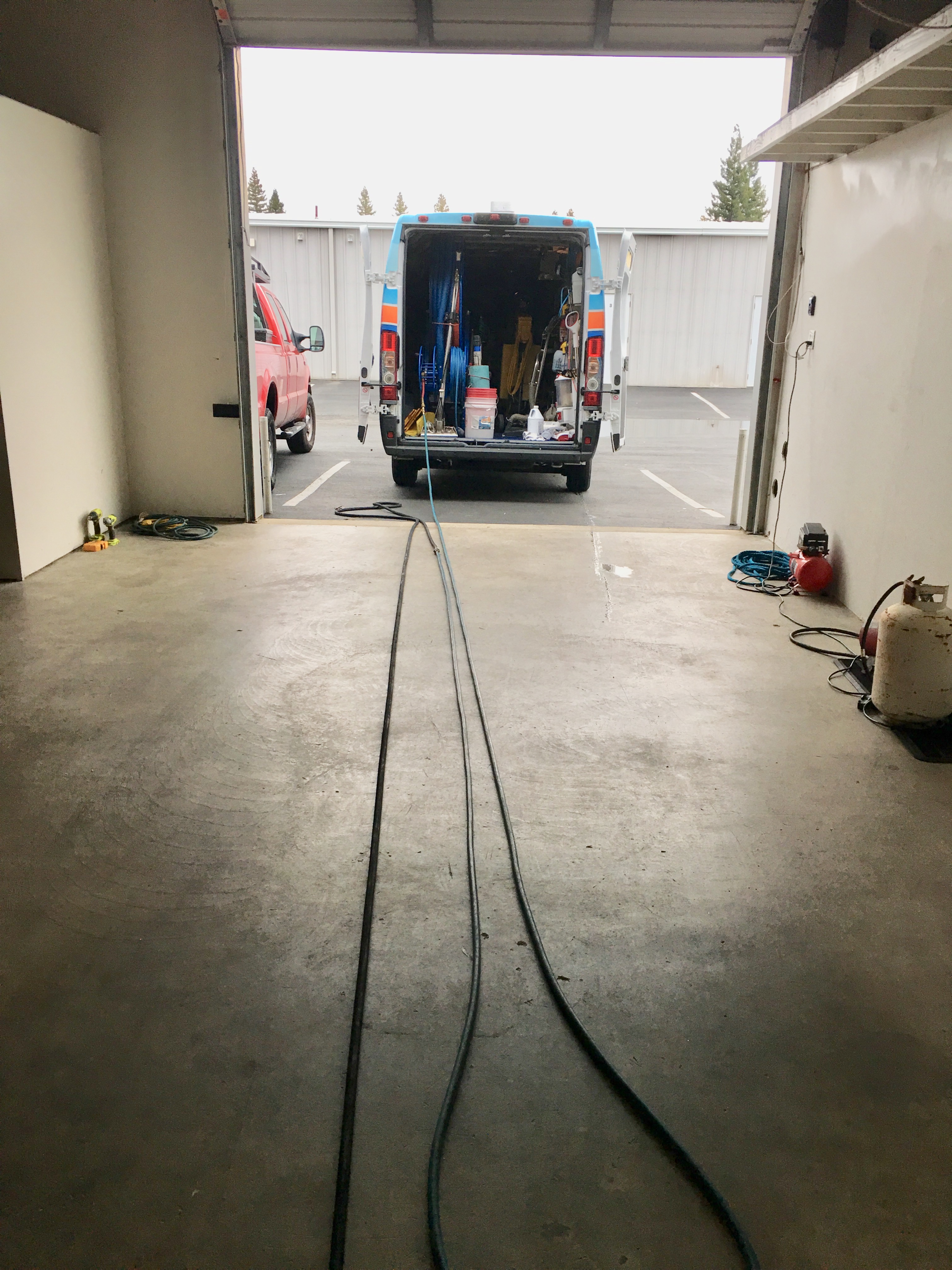

Just for you @anon and maybe Matt also. I unrolled all my hose to take this pic. I like this setup because it’s clean and easy to switch out if a hose bursts. It also makes it easier to change out the Swivel. I’m sure there are different ways to go about it, but I like my setup.

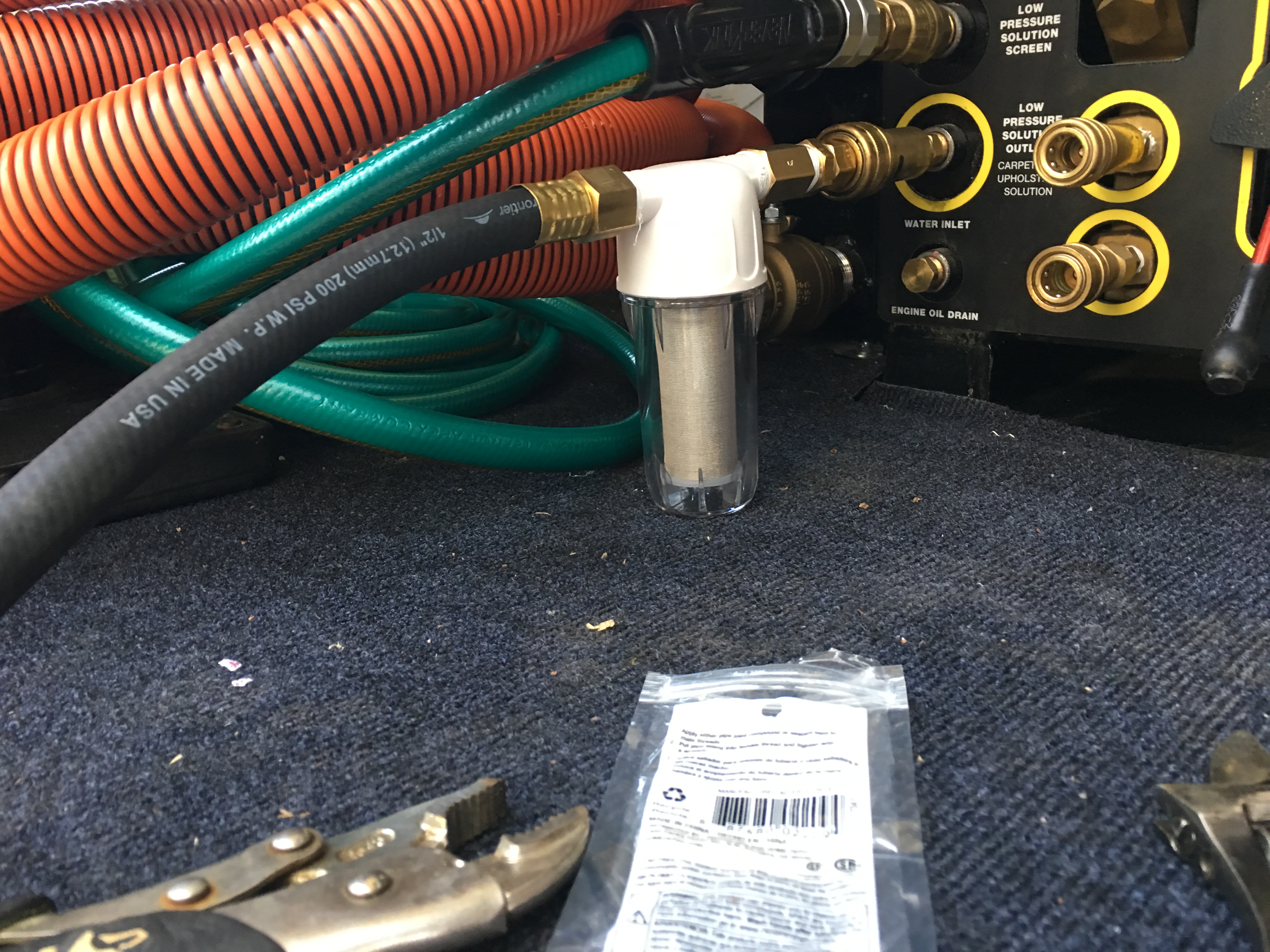

Honestly, I don’t know why I never put a screen there. Doing it today

I’m still scratching my head how two screw heads and a cotter pin got up in there. Amazing.
Little kids sticking things in holes. That is why you don't give them a set of keys in the house. Turn the faucet on before you hook to it, would remove any debris also.
View attachment 89689View attachment 89690
Replace that oversized blue hose with a high quality 1/4” air hose and double the length of hose for jobs that might not have easy water access and makes it less stress on a sink faucet

Dittoes on the screen filter in the house/hose connection. House water lines carry all sorts of particulates. Screw and cotter pins? Okay, that is a new one!

I use an inline rv filter. 17 bucks at Walmart. It keeps all the crap out as well as chlorine, minerals etc. Makes the water pure. I got it when I lived next to a gravel pit. Water went from brown and unpotable to crystal clear and sweet. Charcoal is amazing. My paramedic friend has poured it down poison victims throats. It absorbs everything.
