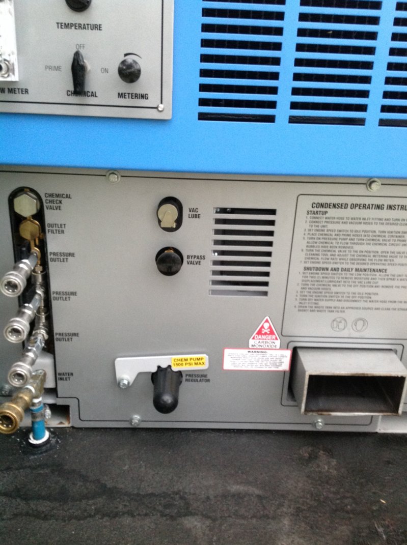

Dislikes. The oil does not have a way to drain it. You are going to make a mess, no two ways about it. The wand doesn't come with a glide. Both are easy fixes but should come from the factory. I altered the front panel to my likings. I cut off the down spout exhaust because it was melting my rhino and cut around the quick disconnects. Once I added the shutoffs it would not fit around when removing. I ran a little pin striping to make it look factory. The belt on the pump slips above 1000psi, just a little, even though it's very tight. My dealer checked and agreed it's more than tight. I have little black piles of belt slowly building around the pump. I was always told not to use the products that stop belt slip. They aren't good for the belt! But in this case, I think I will.

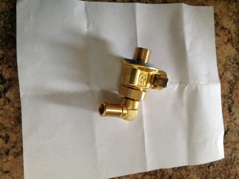

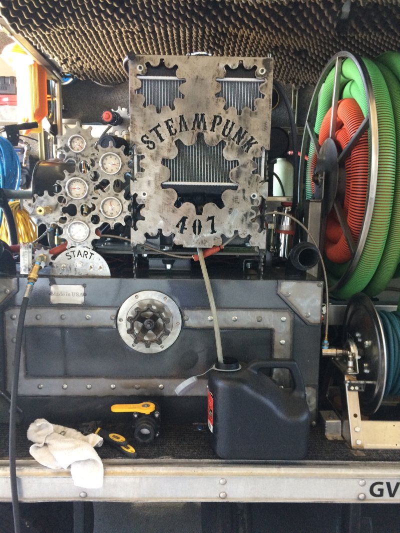

engine oil or blower?
are you sucking it out?
My C4 was like that...sucks.
Yes I sucked it out but installed this. Now it's easy. Neither have drains but I'm talking about the oil currently.image.jpg

View attachment 6730 View attachment 6729
That lock on the pressure reg is pretty slick. I could use that on the 1200 SE.
