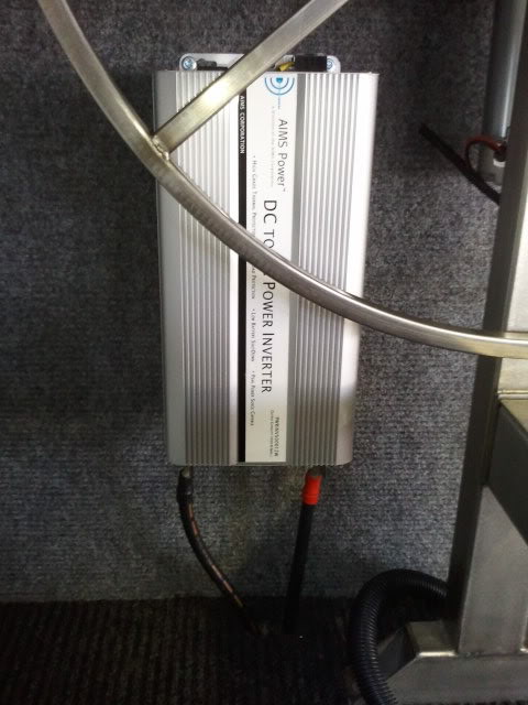

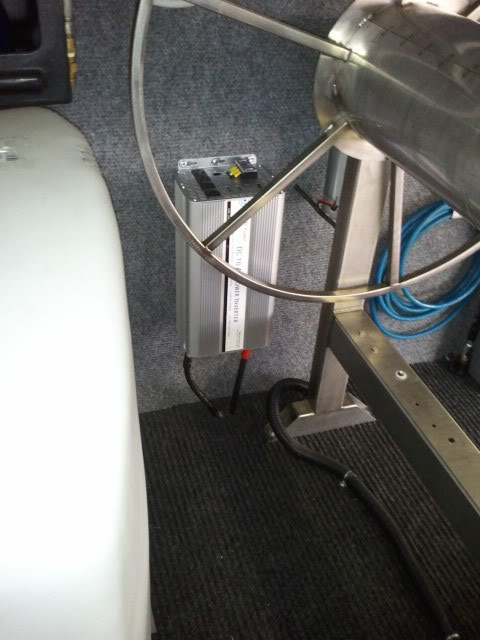

I thought about this quite a bit. How much money would it cost me if my stuff froze while I am on my way to the first job? Thousands? I keep my oil heater in my truck at 50deg in the winter. There are so many circumstances that could come about I wanted to make sure that I alqways have heat in my truck even if the slide in is cold or not running for an extended period of time. Bob foster pointed out a cool heater that runs off diesel or propane and truckers use them to heat their trucks while they sleep at night. $1,500 :shock: was a little high for me though. Thats when I thought about an inverter. This inverter http://www.theinverterstore.com/the-inverter-store-product.php?model=pwrinv500012w# is 5000 watts and can run my oil heater even under the most cold conditions and it wont overload the system. While the truck is running it will make electricity indefinitely. While the truck is off I can run the heater for 6 hours... lunch breaks, blown out tire or a breakdown, etc..
Hooked straight to my batteries. I can charge a battery sprayer or batteries for a black light.

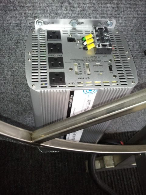

It has 4 outlets in it. I can easily run a vacuum or my rotovac 360i for those rentals I sometimes get without power. In the summer I can run a small fridge off of this 8)

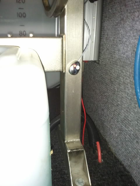

A remote switch to turn on and off by the side sliding door

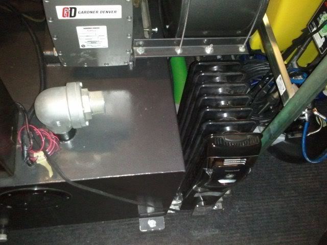

My oil filed heater is mounted to the floor and has a digital adjustable thermostat on it.

Just a few days ago I strapped an oil fired heater under my LG similar to yours Mike. But I'm just running mine off the shop. I set mine on low which is 700W but I don't have the temperature extremes you do.

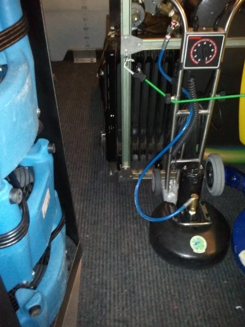

Looking at my picture I just realized that I should stuff the heater between the TM right next to the cat pump and the heater stand and it would be out of the way. And finally get around to hanging my wet floor signs like they should be. When is the question. Big job tomorrow (that's why I have extra hose laid out on the floor) and another place to do on Sunday.
Bob Foster
8,870
Probably the most economical heater for power consumption and the radiant heat works well on bring up the heat on the thermal mass of all the metal. Once I put that heater next to the stainless tank - then I will have it happening.

For those of us (aka me) that are not that good with gadgets. Does the inverter have it's own battery, which is being charged when the engine is on, and will power the heater?
Or once the van's engine is off it feeds off the engine's battery?

the inverter is tied to two deep cell batteries. They also are tied together to produce more power. the batteries can run the inverter for about six hours. I probably would have done the warm my engine thing first thing in the morning, except I go to nevada with the truck each winter to clean for four days and I am on the road for six hours to get their.

I was considering moving to a location where I would not be able to run an extension cord to my heater (same one Bob/Mike has). Would the inverter wired to a 2nd battery than wired to the main van battery, be able to run the oil heater overnight w/out the van being on?
SRI Cleaning
May 4, 2007
1,131
West Chester, PA
Anthony Firmani
No you would need a very very large battery bank to be able to run an inverter at 1500 watts all night, plus your alternator would never be able to charge that battery bank.
