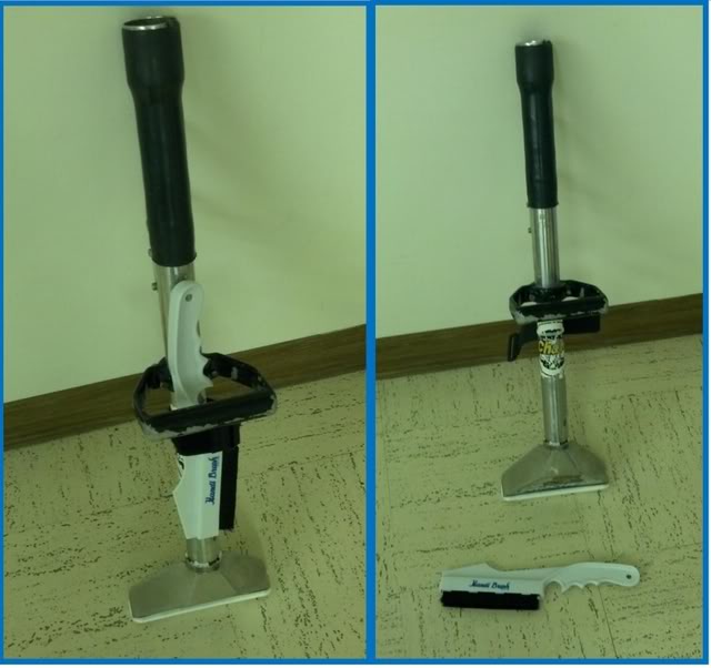

A Handi Brush tip for the bullnose on stairs
No matter how well you clean the tread of a step, if you leave the bullnose dirty you’re not going to have a happy camper of a client.
After all it doesn’t take much to get that edge clean either, just little agitation can make a huge difference in the final product.
So the problem is not what is needed, heck any Porkchop can do it. Having the tool with you when you need it, is where the slip up in the procedure begins. Usually it’s in the truck or in the spotting tray and well….it’s just too far to get it. After all it really didn’t need it that bad. :icon_redface:
So to ensure that the tech’s have the brush with them when needed, I took one of those velcro straps used on injection sprayers and slipped a cable tie to hold it to the stair tool.
Now you can just unstrap the brush and agitated the precondition into the bullnose and Velcro strap it back to the tool when the stairs are completed. The brush does a nice job on the bullnose and your clients are and and you are happy right up until the tech’s leave the brush at the job.
Fortunately the Handi Brushes are fairly inexpensive at least as carpet cleaning tools and accessories go.

Hey Richard, is that a glide on a Prochem wand and does it make a big difference? I have thought about getting one just to protect the skirt boards from getting damage from the wand.

I like the idea, but we use a random orbital hand held buffer with carpet brush that corrects even the worst edges. Just have to rinse it out when it's done. Amazing really.
Ron & Vivers those are better options, I just don't think they would unload it from the truck.:cry:
Doug it makes it just as easy for the steps as it does th carpet but I think it will still sctatch it.

This is the brush I like on the bullnose. It has a nice curve that give a bit of a hug effect. I have been using it for like 5 years so I have no clue where I got it...may have been out of a car wash kit with all kinds of brushes.

I don't know if it's worthy of that but yes you get the idea. I'm sure a CRB would do a great job but for the crews to pull it out of the truck....it's easier not to. This does make it easier for them to do the right thing and hit the bullnose.

I use a high flow (15 TOTAL) wand and I don't grind it in I just rub it on. Three swipes is about all I ever take.

I agree that those in the field are making the decisions but they are paid to do so. We empower them to do so, I don't want to be a micromanager on something as trivial as the bullnose. We don't own CRB's and if we did I don't know that I'd use it for that task. Having never tried it, it seems like a lot of work for so little of an edge impacted.
The brush to the the tool, well it's there. It makes it easy and just takes just a second, no heavy lifting, no trip to the truck. Un-velcro if you need it, clean the step with it strapped if you don't.

Hey Zee, you're right... Looks like a curved tire brush...
