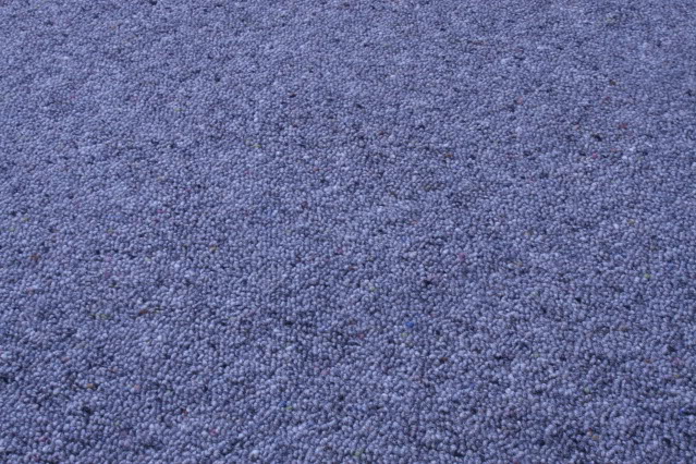

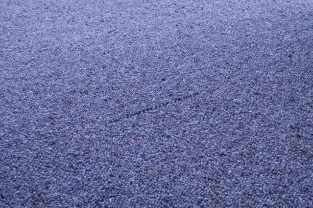

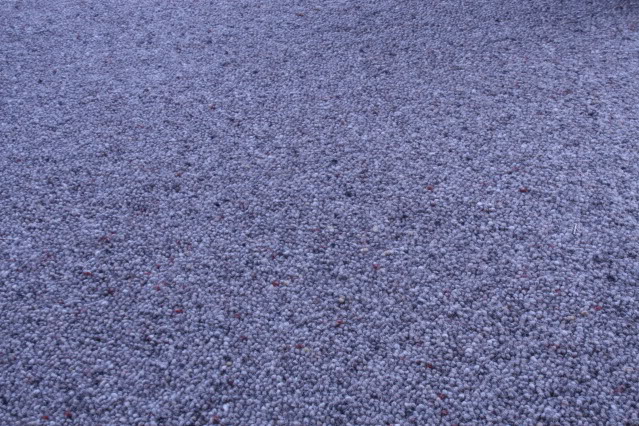

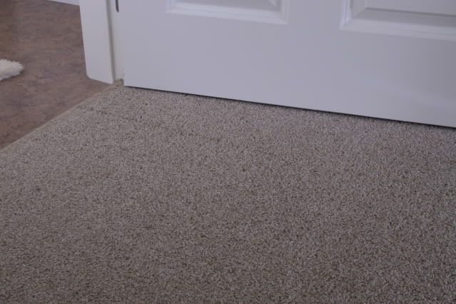

Row of high pile.
Knapped and groomed.

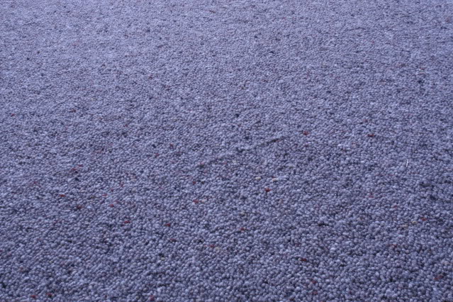

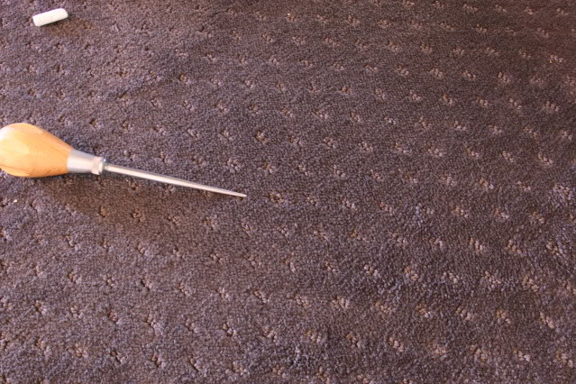

Row of missing pile.
Re tufted.

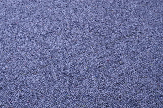

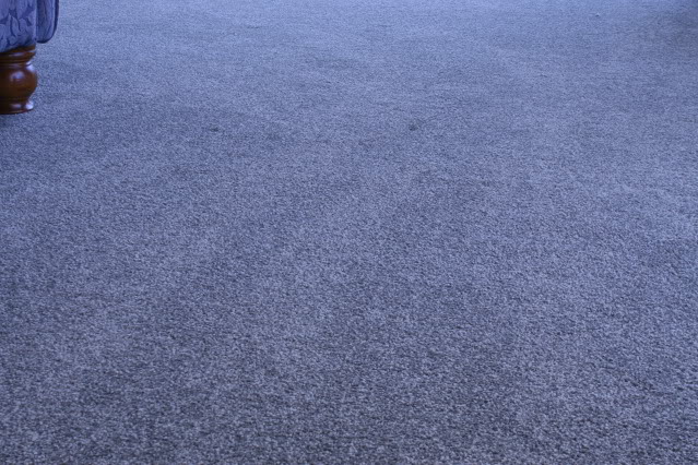

Row of high pile.
Removed and carpet prepared.
Retufted.

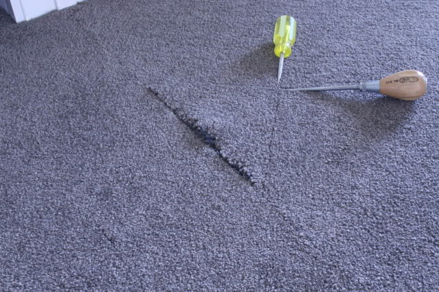

Blob of silicon on new carpet.
Affected tufts removed.
Re tufted.

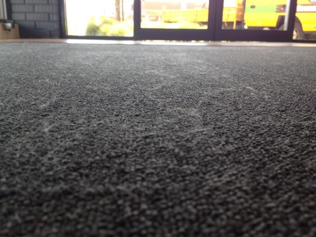

Filamentation.
Removed.

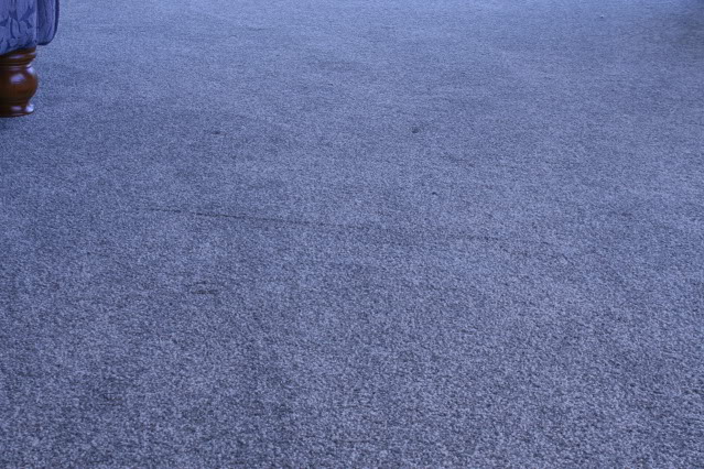

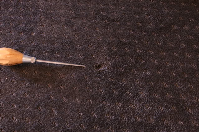

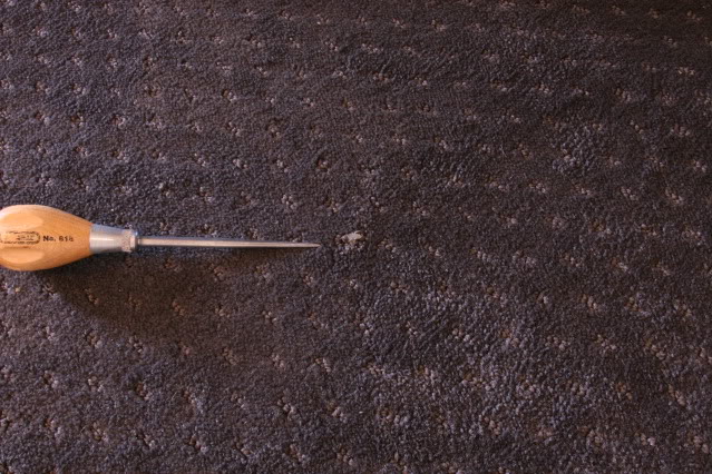

Damage that initially appeared to be missing tufts, but closer inspection showed damage, possibly from a forklift spike. Not re tufable.
Successfully repaired using a bonded insert.

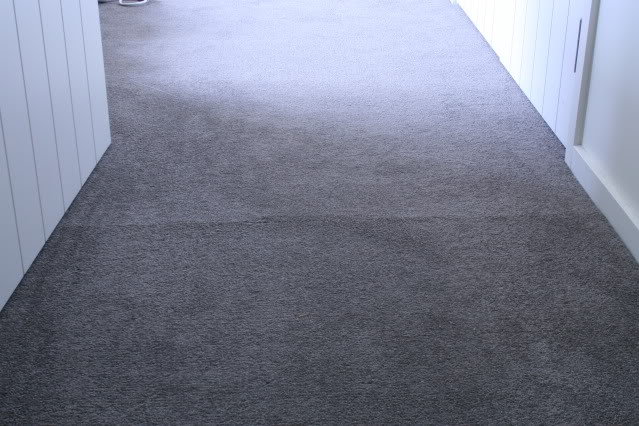

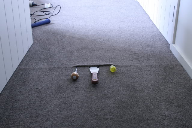

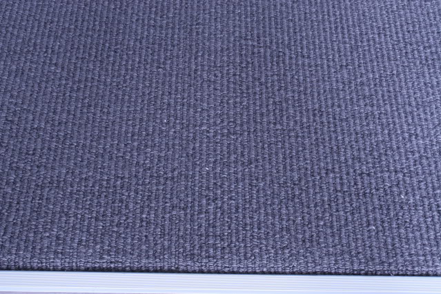

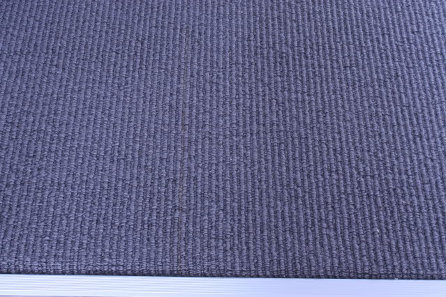

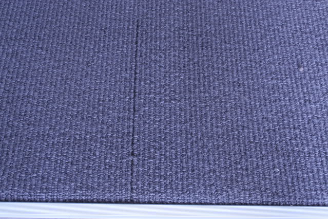

Delamination on seam.
Re glued successfully.
Dalamination. Not repairable. The seam was cut at an angle, the edges were damaged and a repair was not an option given its central location and the size of the repair necessary. Carpet replaced.

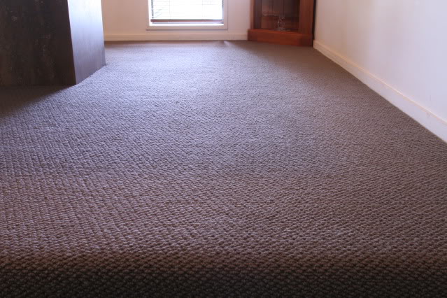

Filamentation. This was a tricky job. The fibres could have been removed but it was a. going to be very labour intensive for a small area and b. with a good amount of feet shuffling on the test area, I was able to make it re appear to a lesser extent. Referred to the manufacturer for lab testing.

Dale. I showed two photos of filamentation... One was a wool resi carpet and it was really part of the natural shedding process and so it was mainly in the areas outside of the main walk zones.
I have my own cropping/de pilling machine and over 25-30% of my business is de pilling carpets with this complaint. In a high wool environment, de pilling carpets is one of the main complaints that the carpet reps have to deal with. Sometimes it's nothing more than poor vacuuming, other times it's severe shedding and occasionally, it's an actual fault and once done, it'll return. In most cases, if done at the correct timeframe in the life of the carpet, and done correctly, it won't return.
The bottom photo was a SDN commercial tile, it had I believe poor latex bonding and fibres were working out of the yarn bundle, in fact, when pulled, I was getting them out to 4-6" long before they would break off. It was a small amount, (48m2 whatever that works out to your ay of measuring I don't know sorry) but it was in a carpet retailers own shOwroom so there was a bit of extra politics involved. If the rep had done his inspection correctly, I should never have been sent in there.
