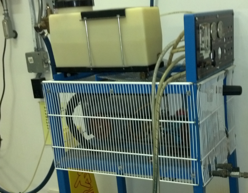

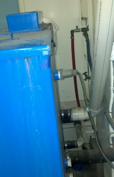

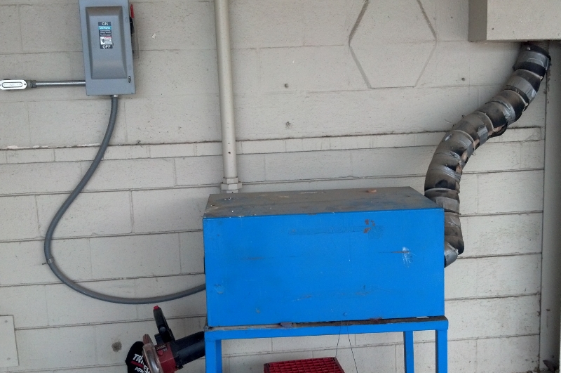

We have an inplant machine we built, #4 blower driven by an 5-hp electric motor (3-phase), cat pump with PC chem pump to meter solutions. 100-gallon waste tank that dumps into a mop sink.
Blower and muffler sit outside the shop, plumbing through the wall and over to the rug area and upholstery area (50ft) where there are two vac & solution ports. There is a remote start box so they don't have to walk over to the machine to start and stop. Heat is supplied by a hot water heater, which does a decent job but not as hot as a TM. Unit works great, saves tons of gas, we use it everyday.
Odin had an electric TM that he built a few years ago that would have been an excellent inplant machine, I almost bought it from him. You might check with him, although shipping might get you.
