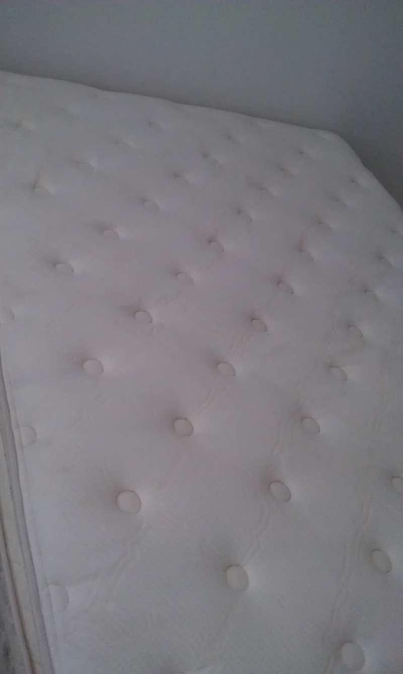

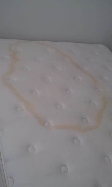

I soaked the urine area with hydrocide and used my small water claw to extract. Then I sprayed the mattress with Powermax and used my stair tool to clean.
