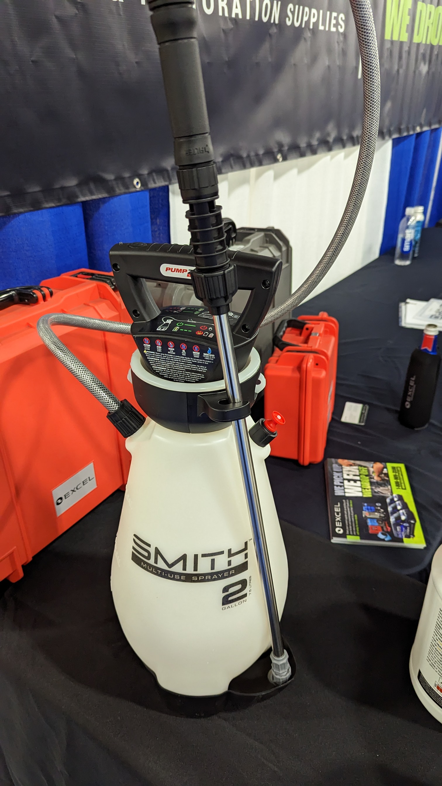

According to my peeps at Excell Supply, these battery sprayers dont have issues..
116,393

Extend the hose to 15 feet then plant sprayer an just walk the spray wand.

Interesting..
Green Gorilla has been a great sprayer for Amy and her FPA.. I assume if it can withstand a solvent, it should be good!

Take a cheap sprayer drill hole insert air valve. Use cordless compressor and add 15 feet of hose. No batteries to replace -no working parts except trigger and jet an filter . Find mini compressor strap to spray tank .When needed add pressure. Put in a movable fold up crate with handle and wheels -Voila- cheap spray station that moves with u and hold items...
