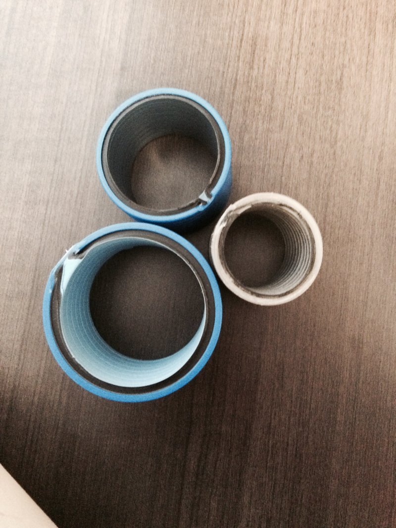

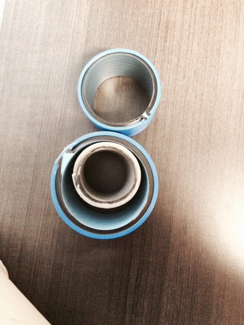

So, I just picked up a 50' anaconda..... When I first started, the van came with a 30' section of 1 1/2 whip hose..... Not knowing better, I ran it like that for a little over a year. I was NOT getting good dry times.... 2 days! I slowly lived and learned, due to the wealth of info on the net....... Well, today I step up again..... Whips are for horses and old perverts.......
28,270
View attachment 70576 View attachment 70575 So, I just picked up a 50' anaconda..... When I first started, the van came with a 30' section of 1 1/2 whip hose..... Not knowing better, I ran it like that for a little over a year. I was NOT getting good dry times.... 2 days! I slowly lived and learned, due to the wealth of info on the net....... Well, today I step up again..... Whips are for horses and old perverts.......
