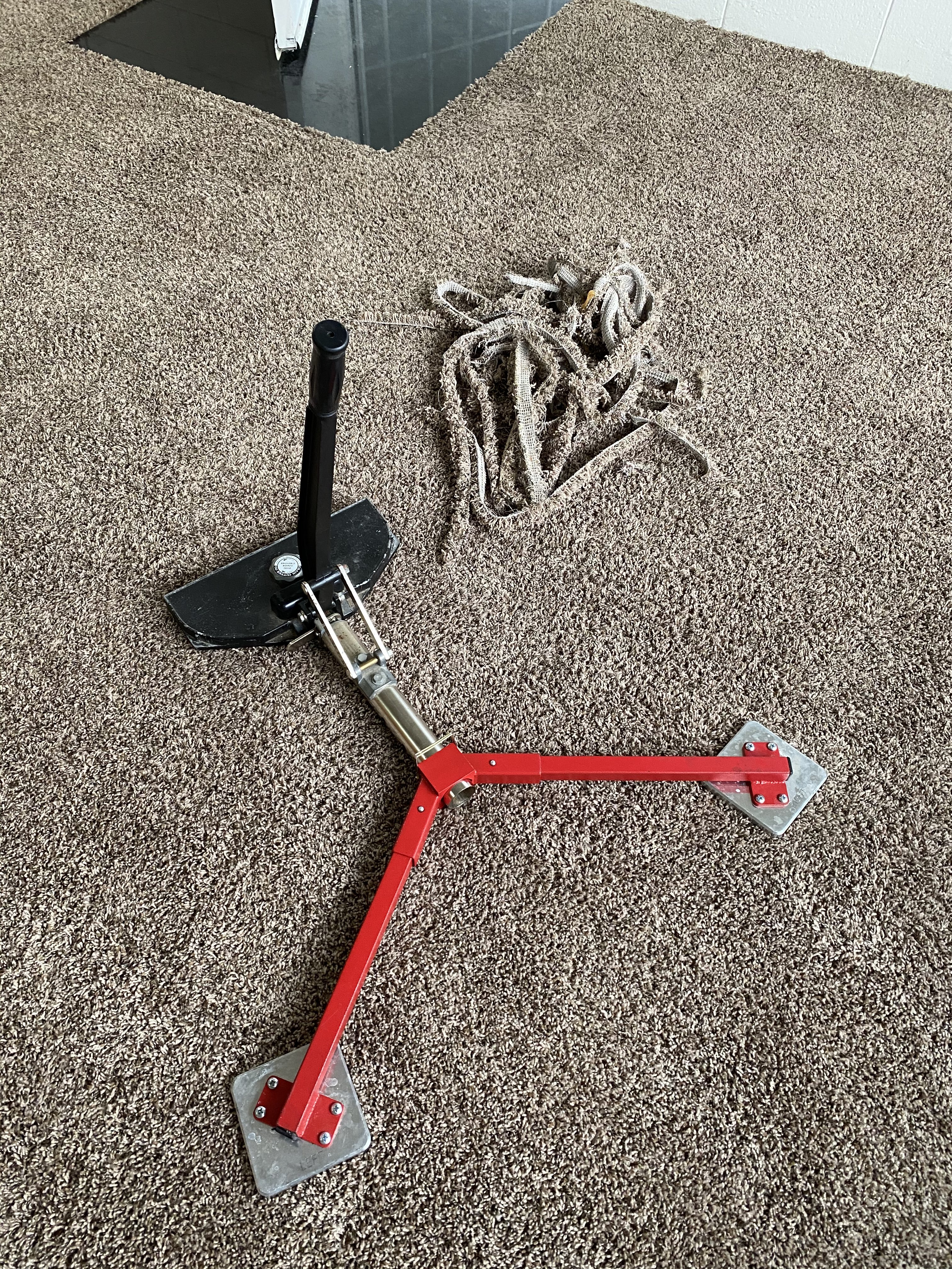

If im all ready there cleaning i charge 85.00 for Streching per hour.I dont use the polls for the power streacher I,ve got the stinger and Tri Force so a lot less work .Keep in mind this is for vacant properties.I made a nice income last year doing repair work.
I was looking at the Tri Force when it first appeared. What head do you have on it?
I think their vids had a cotton head vs. what we are used to. I looked tried to find out about a cotton head for my power stretcher head. and wow, quite a $$$ . no cotton head.
Charlie Lyman
2,631
Charlie Lyman
use your regular head.
Mine came with cotton head and I don’t like it at all
I have the Crain power Stretcher head.

I could see that working way better than the cotton head but aren’t the feet pads also cotton head style? Mine would always slide and I was afraid of tearing carpet fibers
I don’t see that the Cotton head would work very well ,but never tried one either.
I just remember the cottonhead being touted as much less likely to cause damage . I have never used one,
