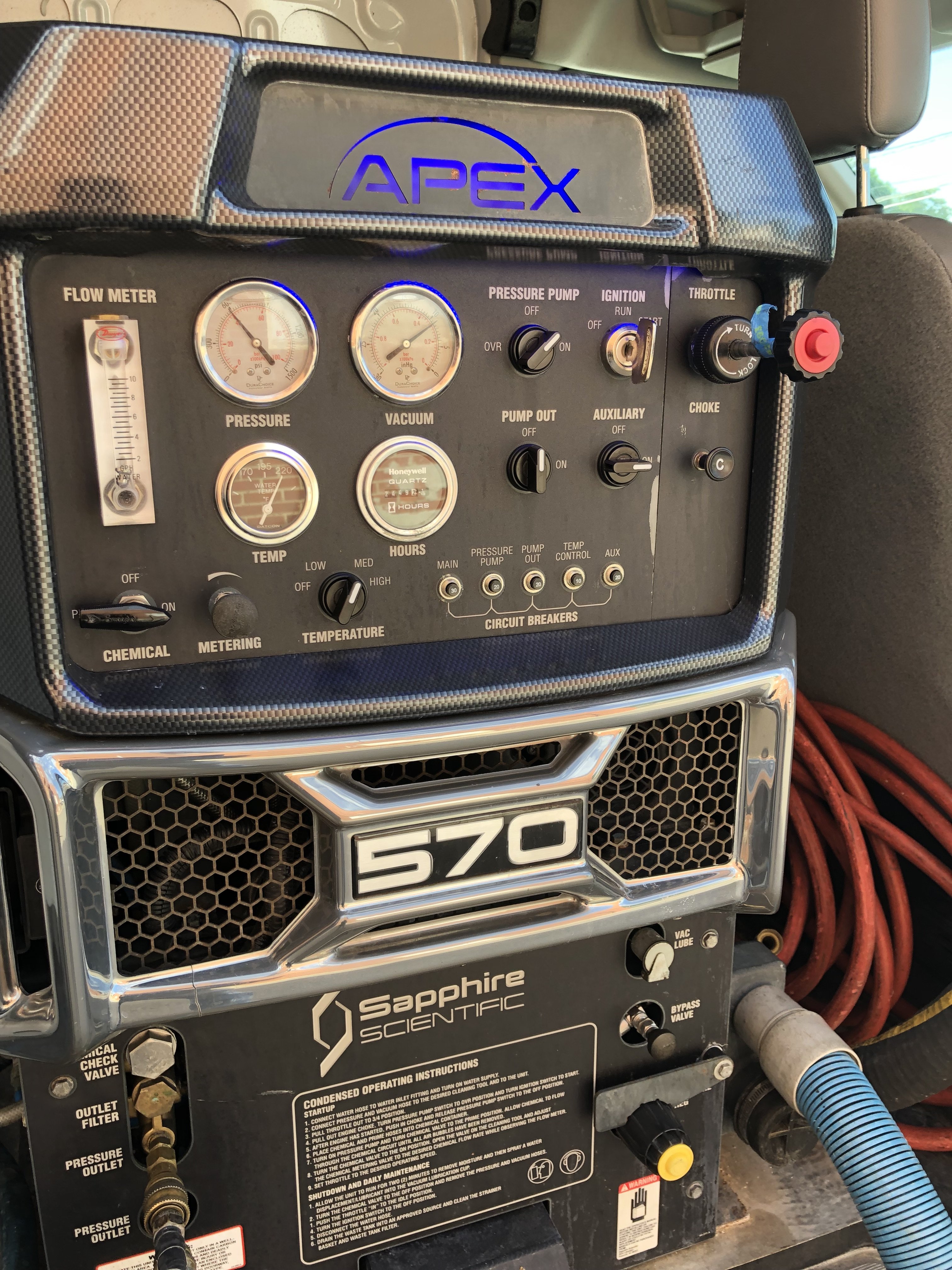

I can't speak to this unit, as I haven't owned one. I have owned direct drives from hydramaster, white magic, and Sapphire, all caused major premature failures to the vans and thousands a year in maintenance. I now run Apex 570s in Ford Transits and after 5000+ combined hours I'm happy I made the switch
That is my exact concern. Have your 570's been reliable? My 370 has been the most reliable machine I've ever owned.
all installed in a gasoline powered cargo van, correct?
Diesel, is the only way to go for a CDS/DDS/PTO..IMO
I hate to acknowledge it, but yes they've been extremely reliable. I do the maintenance by the book but all 3 have been awesome. The placement of the throttle cable is too close to the exhaust which causes it to melt so I replaced those and put some heat insulation around them, I have one that has a bimba valve that occasionally sticks and causes a high temp shut down... that's really been it I think in 3 years.
30,775
and they're relatively quiet too
Chris* did the office carpets a month or two ago.
Side door ally sandwiched between two brick buildings where a noisy TM would echo 3 blocks away.
One of the quietest slide-ins I've ever heard
*his guy Kevin did the cleaning .
He's a winner Chris!!
Take good care of him, long term he's worth his weight in gold to you
(literally)
