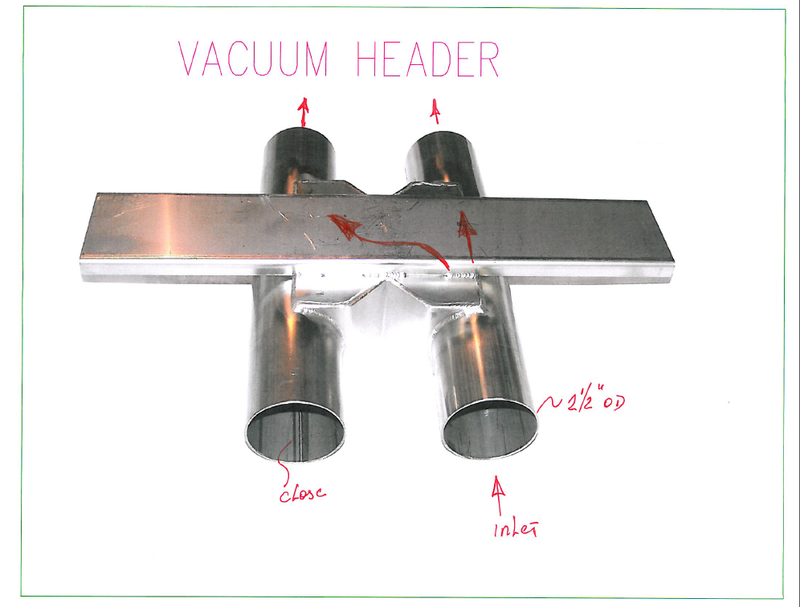

You don't need 4 to the door. We run 2.5 from the waste tank that hooks to a Y... I think this is what you're talking about. It's allowing you to utilize all 5 inches of air flow from the tank and push it all through 1 2.5 vac line. Unless of course you're dual wanding.
Joe Bristor gave me the parts to make this.

Its a fairly new mod that changes over the vacuum header bar to a hew ' H ' style hookup.
If single wanding just leave one of the ports blocked off and run your 2.5 straight from that, no Y needed.
If interested I can post a pic of Vlad's drawing !dork!

That is a loaded question with a lot of variables.
I don't think it will give you a measurable difference in dry times but it will "improve" the air flow when it hit the x area in the tubing. All it is doing is letting the air and water choose its path by way of least resistance and increase the area of the tubing. Also depending you setup it is "moving the truck" closer performance wise, to the job. easing up the workload by keeping you total hose size to 5 inches all the way to your 2.5 hose outside of the truck.
The scenario where you will see the biggest increase in performance will be extracting large volumes of water and when you are dual wanding, you will also see an increase in performance again due to the whole path of least resistance and combined tube size.
You can also achieve the same thing with a 2.5 y setup like Jim posted only it will only help with single wand operation. Also you will have some additional setup and takedown time on every job.
I also have found the x to be useful in catching rags and such when an accidental intake of such has happened.
