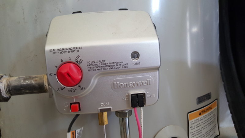

Anybody know anything about this Honeywell ignighter?
117,362
Hot water heater in our home went out and I cant get it to re light..
Hold the knob in the pilot position
press igniter button (square one) until it lights
release the knob
some other issues like faulty gas control unit mentioned in comments

Take the red and white wire and attach a meter to it.
It needs to read at least 350 milivolts while you have the pilot button depressed and lit.
If not the thermopile is bad.
In a pinch I have removed them and polished them with sandpaper to transfer more heat.
There may also be a reset able thermal switch down by the sealed burner
