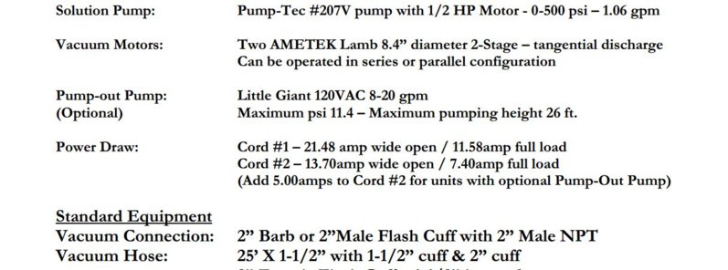

They look like well designed machines to me.
MXE-500M would be the way to go.
207v pump is a workhorse.
From what I have read, the new 8.4's are one of the most amp efficient vacs available and often run well over 1000 hours.
The additional amps required with a pump-out may push the ceiling of 1x15/1x20 amp circuits assuming your going to run your pump-out continuously.
