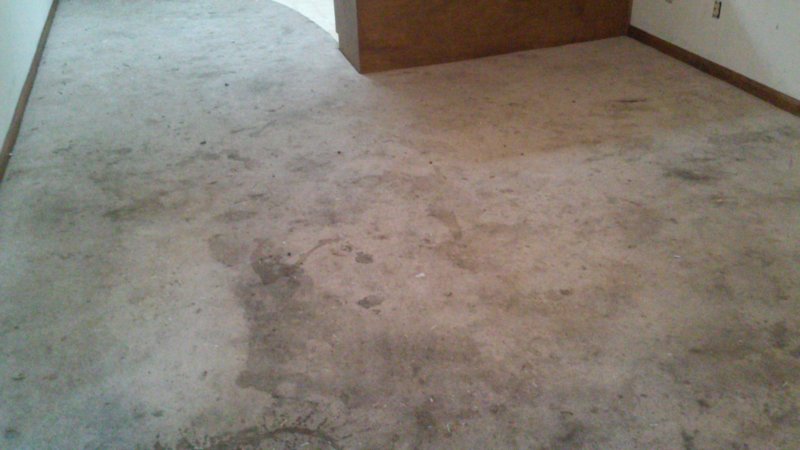

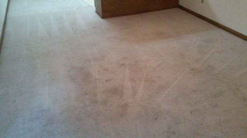

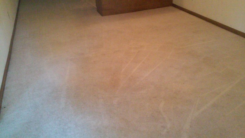

I had to redo a job yesterday, because, Originally, the carpet needed to be thrown away from it being so trashed...But I tried my best. I was so disappointed in how it came out, I told the customer that I'll come the next day after it dries and try it again.
The first time I did it...I used my 7.5flow 5jet wand. The second time, I used my 4jet 8flow wand, and it flushed it better. The water was just as nasty as the first time I cleaned it, and it was only .5 flow more. That tells me that a 10flow with #2 jets will do a job 100times better than a 7.5flow #1.5 jets any day.
I'm gonna swap my jets out this weekend and make my mach15 a 10flow wand
14,640
And for anyone that wants to know my process on that trashed carpet job:
Day1 (first two pics)
Prevacced with ProTeam Vacuum
Presprayed with Chemeisters Grease Eraser
Scrubbed with 175 brush Head
HWE with Acid Rinse
Presprayed again with Matrix Grand Slam
Hwe again
Day 2 (last pic)
Presprayed with High PH Tile and grout pre spray
Scrubbed with Red pad
HWE with Acid Rinse
