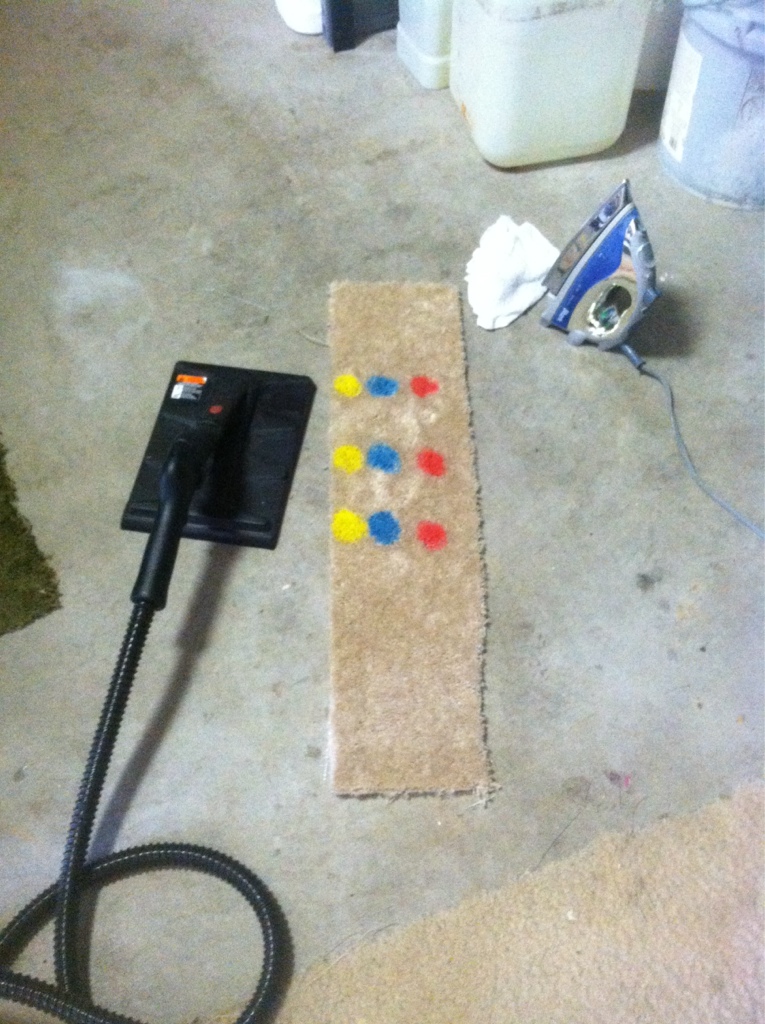

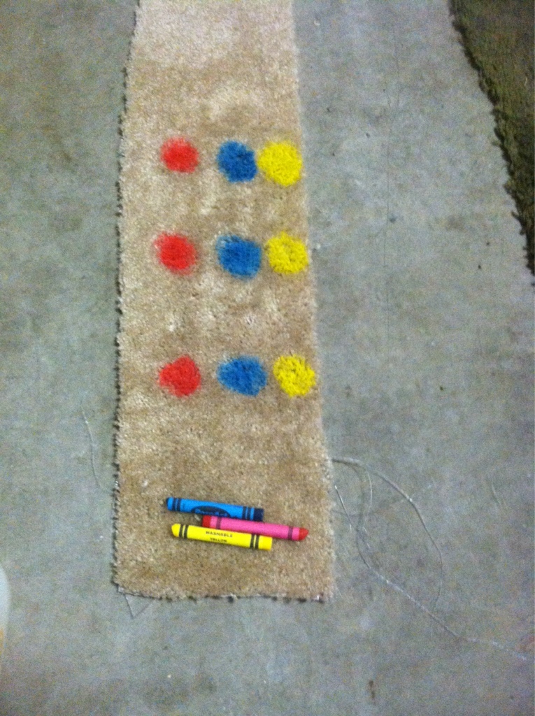

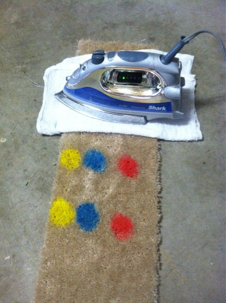

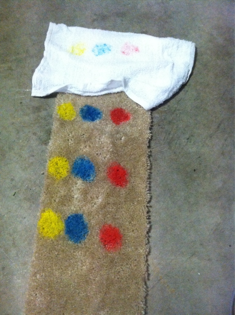

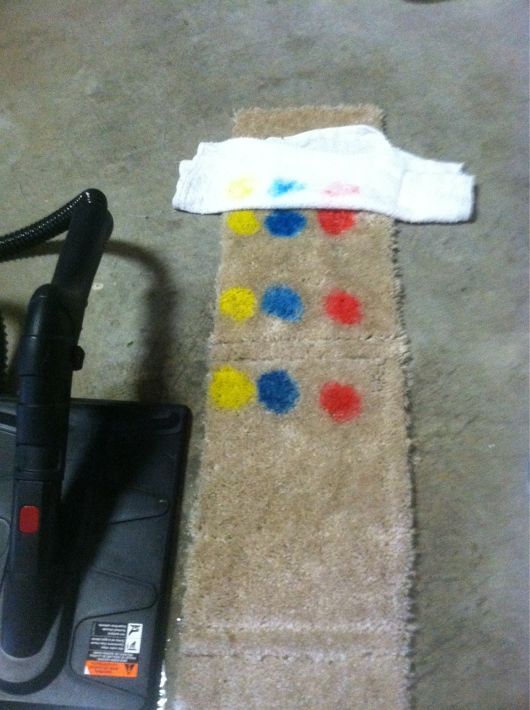

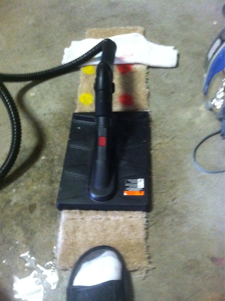

Yes it does and so if you are actually willing to learn more about the use of Synthesized Lipid Fiber Pigments, here is some homework for you -
Take a few scraps of carpet of various fiber types and on each one make 3 separate, quarter sized marks/stains using a few different colored Synthesized Lipid Fiber Pigment applicators.
Leave one alone, heat one with live steam and heat the 3rd one with a steam iron over a damp cloth for 30 seconds.
Let us know how this worked out - pretty sure that you will learn something useful and odd.
Of course if you are color blind - don't bother.

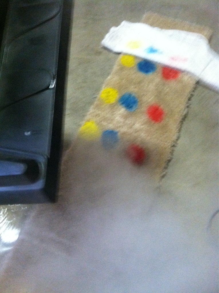

Hell, I'm stumped now........
An my Carpet looks like shit man!
G
GCCLee

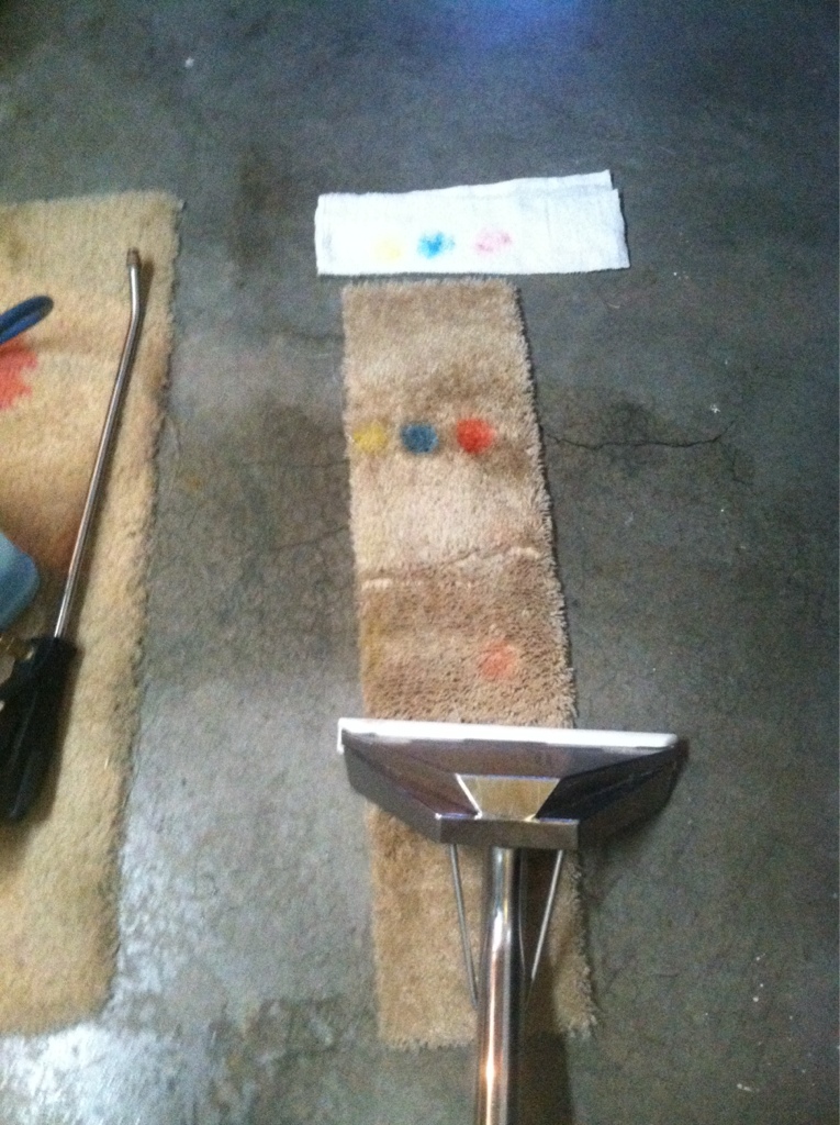

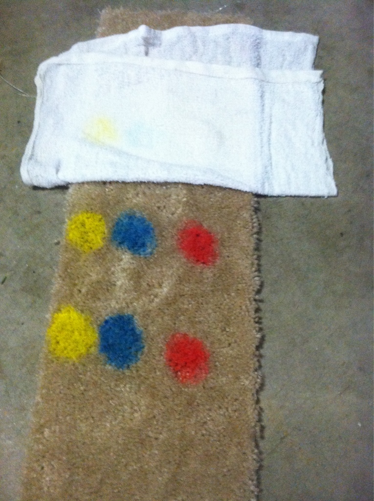

Okay,
Took about 3 min including plugging in the porty......
Shall We continue?
Everyone here knows I can get them two lil puny red spots out,
So .........

Good job Chris except for the use of heat or more accurately the amount of heat or perhaps too many layers of damp cotton cloth.
Anyway the point of this exercise is to illustrate that oily stains like that can become permanent once they are heated.
Anyway if you would not mind, please repeat this with a wool and an olefin and then I will walk you through the next step.

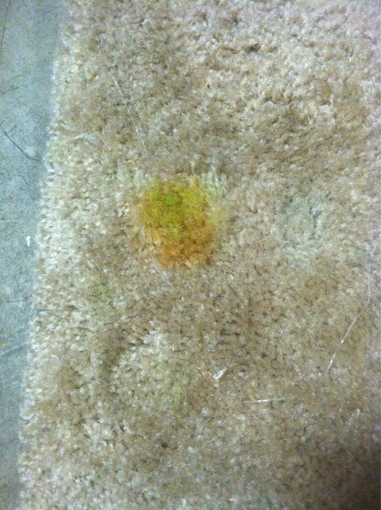

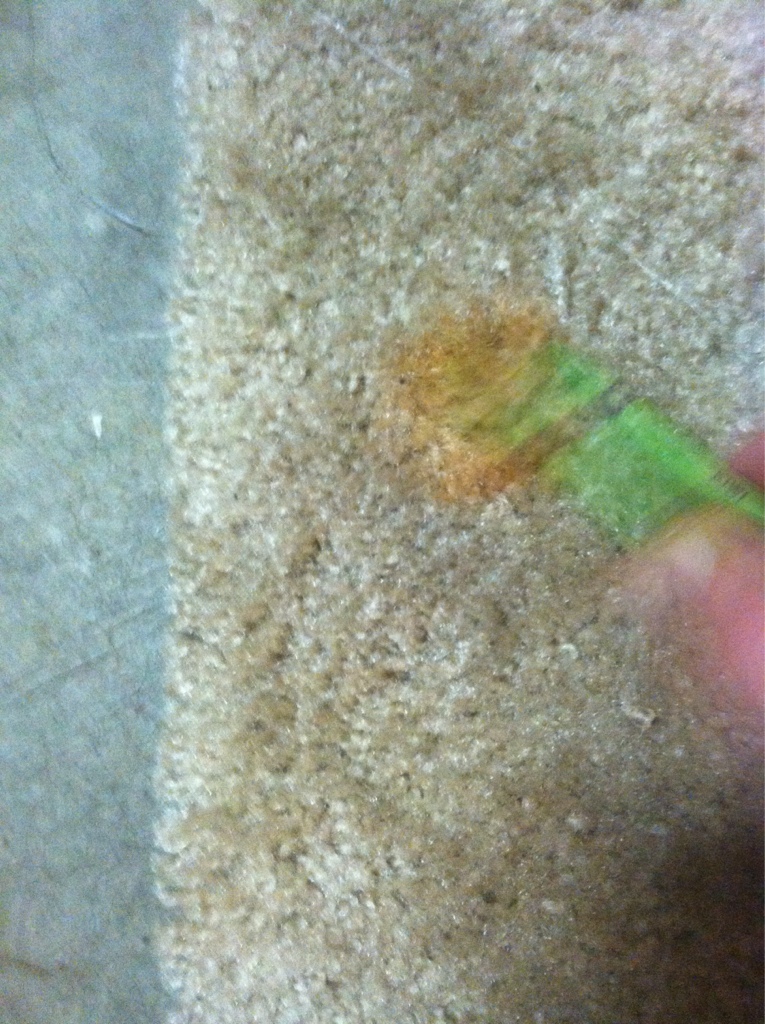

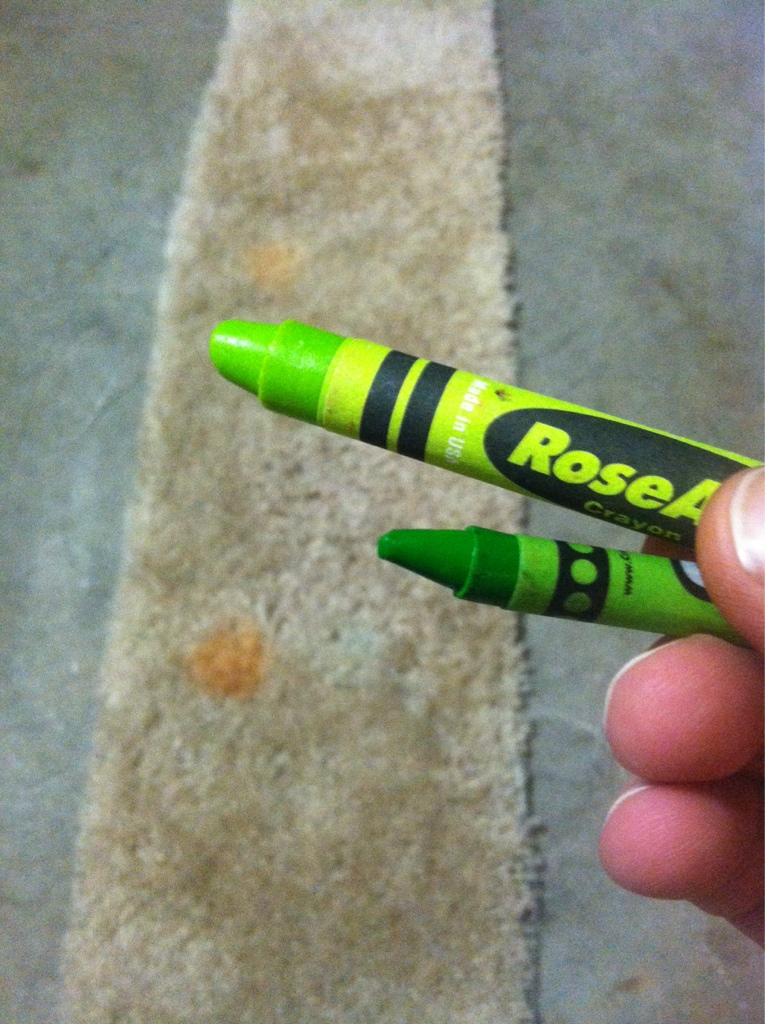

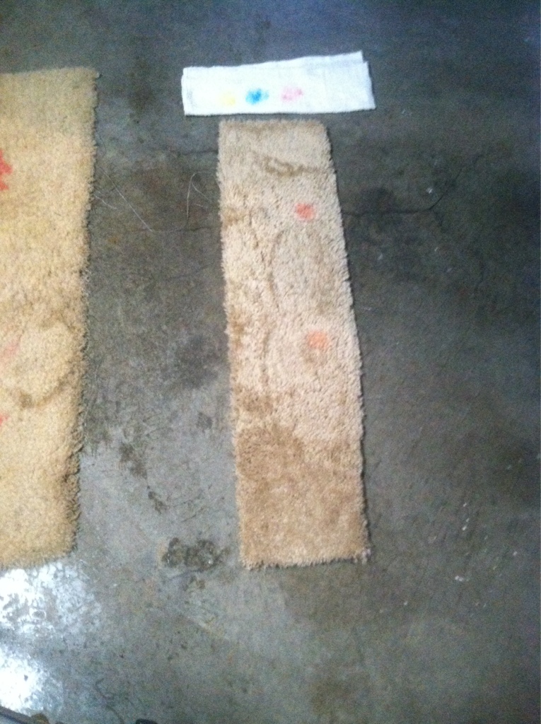

No, will not get you in any deeper IF you can be very careful and patient, you will not kill the patient.
Take the lightest, dullest green crayon (not a bright lime green one) that you can find.
Now as gently as you possibly can, barely touching the fibers on that red stain, brush that crayon over the carpet.
Sip on some sweet tea first Chris, relax and go for a very slight adjustment of the color - you can always give it another stroke as the color starts to become a more brownish color.
Take a pic and let's see how you did with more instructions to follow.
