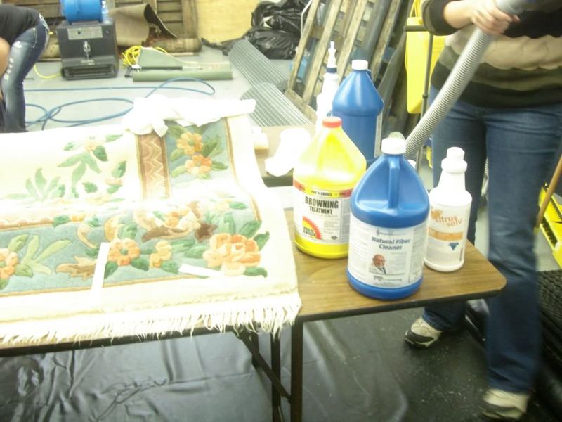

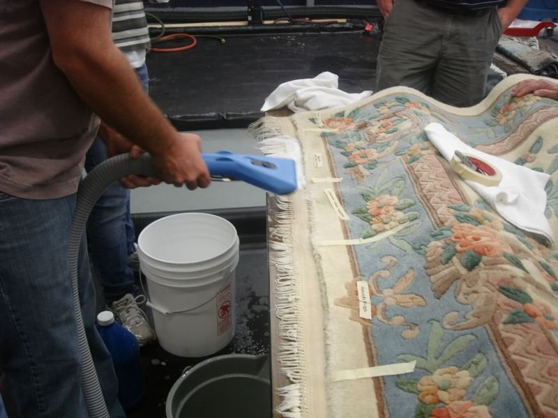

Recently at a Textile Pro hands on training session with Lisa Wagner and Jim in Pittsburgh at Pembertons we did some testing on fringes and noticed that the specialized products worked better than what I would call more universal products.

What's the product on the left(fringe) foaming up real nice?

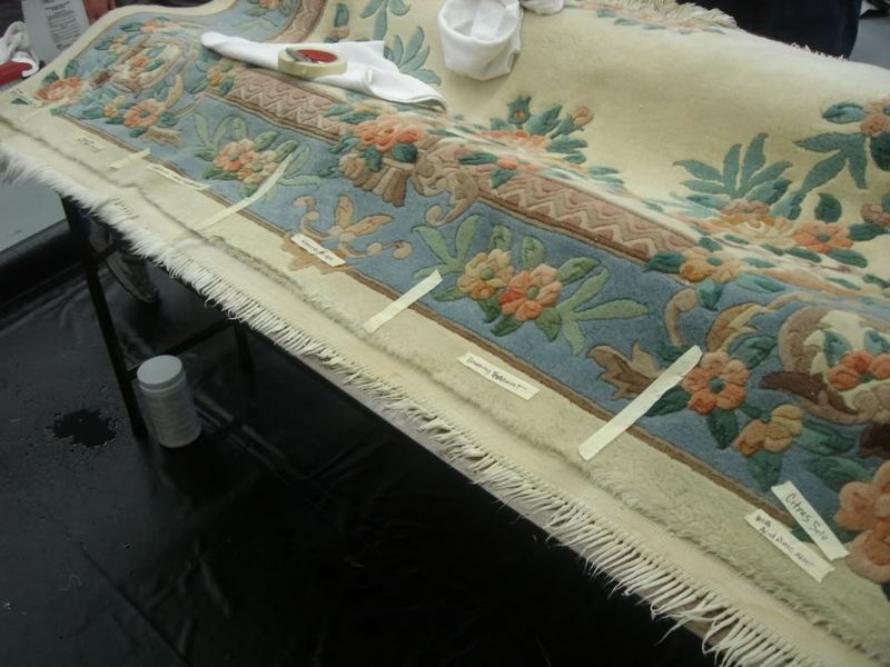

In this particular situation with a cotton fringe you could see about 7 or 8 types of cleaners used. Don't be mislead by the other various spotters etc you see in some of the pictures.
Some of the solutions we used on the fringes included but were not limited to CTI, Bridgepoint, MasterBlend and Sapphire. And all these companies make good products.
Yes there was one outstanding prespray that was obvious from the row of test areas. And it illustrates the point that a specialized cleaner can and did work better than an upholstery prespray or a carpet prespray. And that section was cleaned with a specialized cleaning agent.
