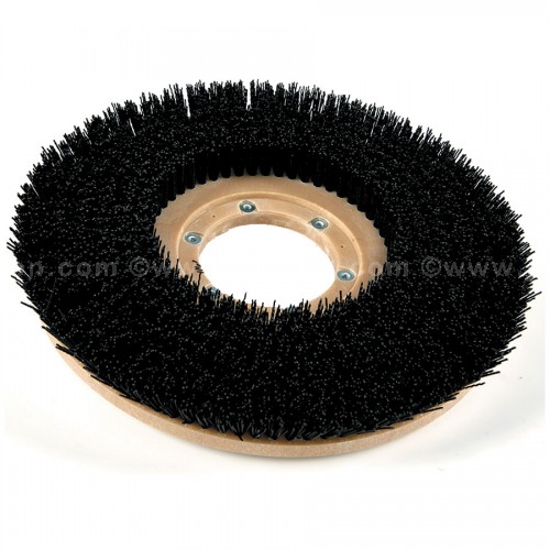

I seem to recall rotary brushes that incorporated some LONGER staggered bristles along with it's "standard" bristles, that were beneficial in reaching lower into recessed grout lines.
Anyone familiar with any?
117,349
http://www.jondon.com/nylon-grit-brush-various-sizes.html

Grit brushes only help if the grout lines are shallow and fairly wide.
A cylindrical brush machine w/stiff brush parallel to the grout line is a good scrubbing device.

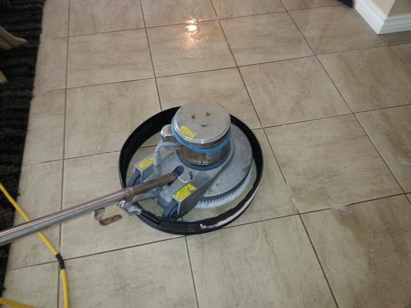

Using a 175 works if you heal the machine to dig the brush into that grout line.
You better plan on maskung the walls four feet down.
I made this up and it seems to stop the slinging of crap all over.
encapman
2,405
Rick Gelinas
I guess I'm asking the question Rick already answered but I just want to confirm in my brain.... a 175 machine with a mal-grit brush being heeled will out perform a CRB with the tile brushes installed?
That's been my experience. When you run a rotary like I showed in that video, it's pretty hard to beat.
