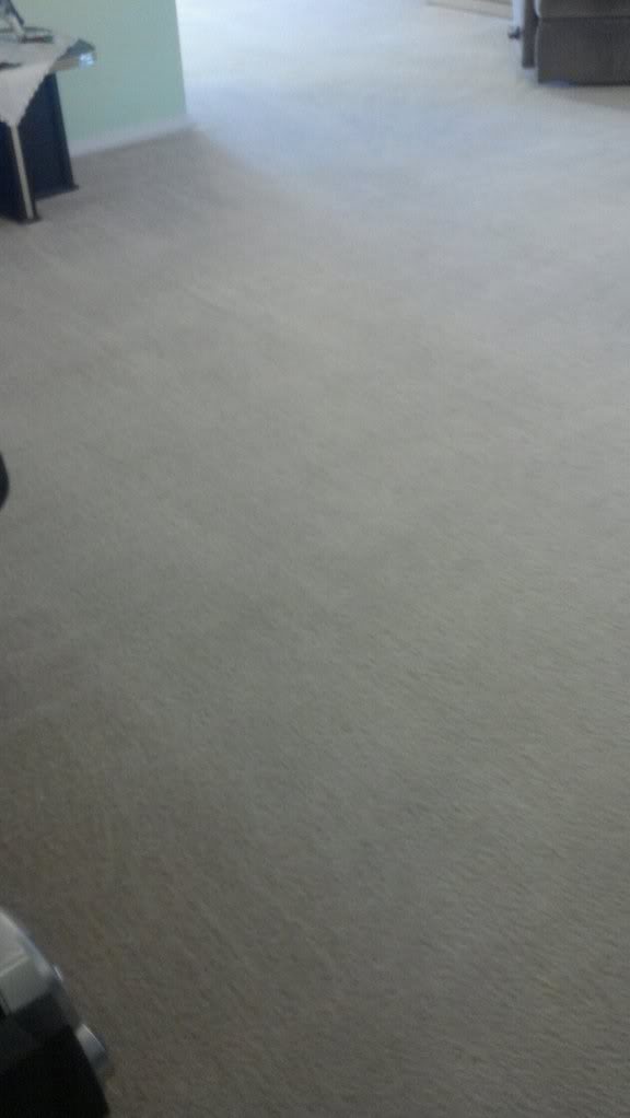

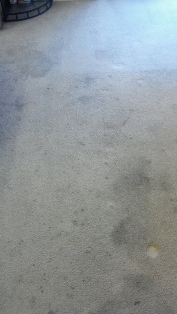

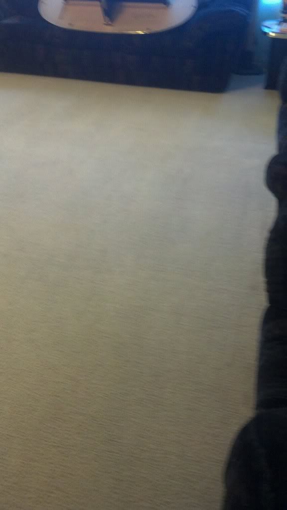

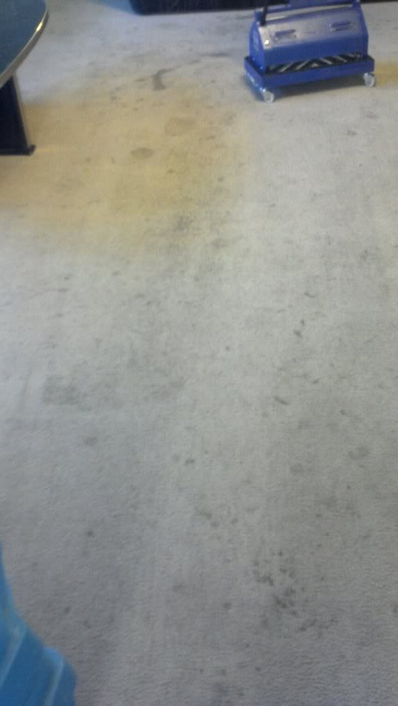

before
after

trashed poly cut piles respond well to mechanical agitation .
Short of that, Powerburst and screaming heat
