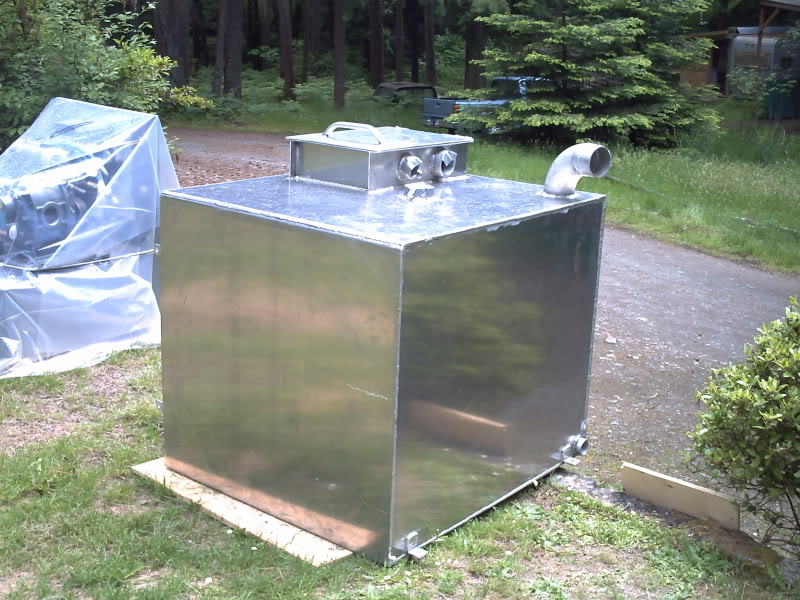

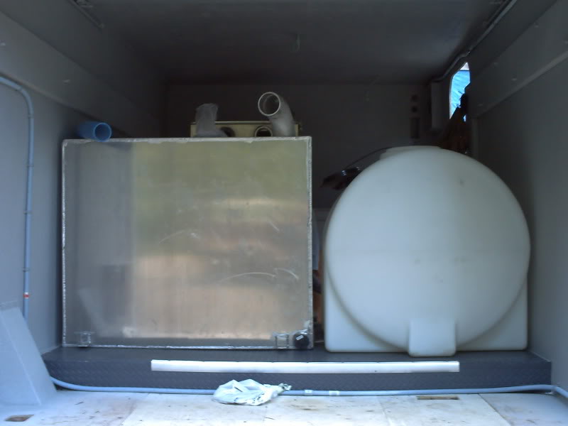

I don't know why it wouldn't work, we have a PC 805 and it has a 230 gallon tank.
Richard, I would love to see a pic of the 230 gal waste tank. I love the PC 650hp the only thing that is a pia is the 110 gallon waste tank. Since I run 18 flow and flushthe restaurants with 800 psi I can fill her up quickly. I have really gotten spoiled by the V's (2) 110 or 120 gal waste tanks, I can clean all day without having to empty and can do 2-3 smaller restaurants easily.
Ben, I purchased a 225 gal plastic tank (recommended by Jim Martin) and I love it! You don't need the preheated feature with the PC, it will burn your ass off from a cold state if you want. Now I just l got to get a fill value and float for it! Huh Huh John Olsen!
