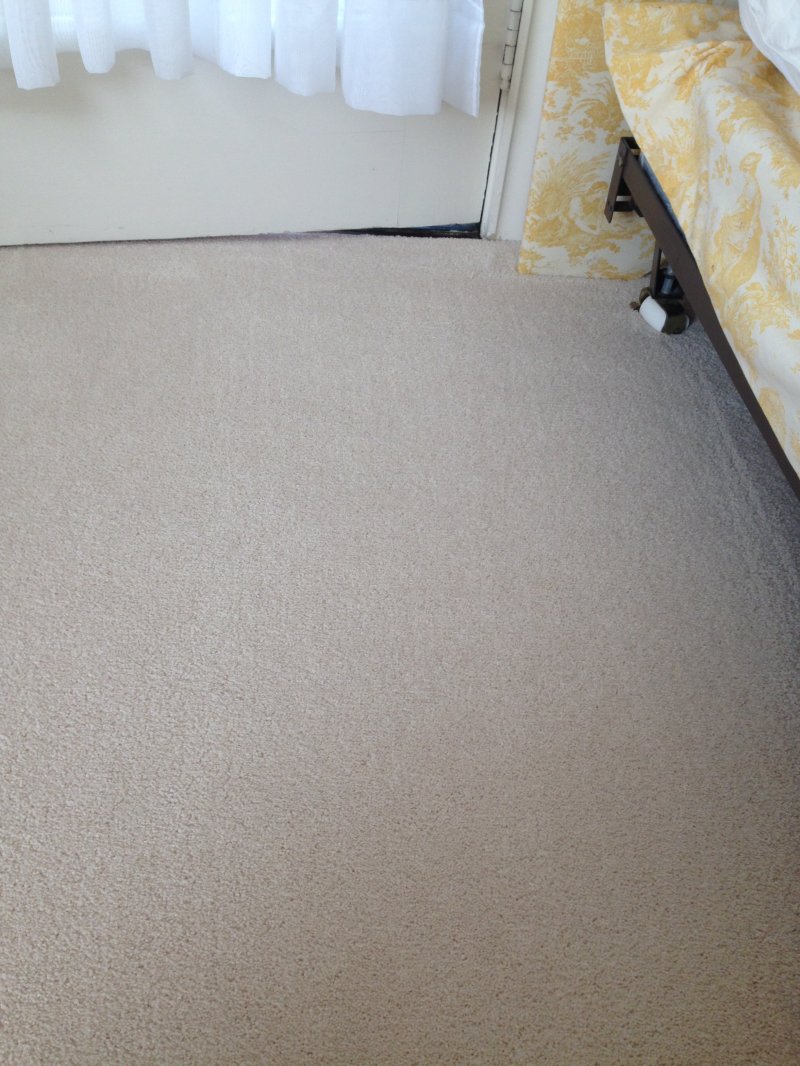

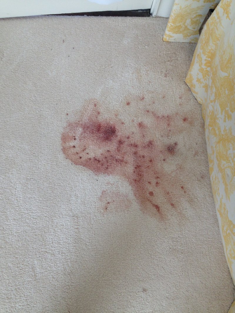

I used a drimaster uph tool to extract first in order to keep it from pushing anything down with no prespotting.
After removing the bulk which seemed to be on top, I saturated the area with Stain Zone and lightly brushed back n forth just to massage the fibers.
10 min later I rinsed the SZ and whatever was left in the carpet.
Sprayed a light mist of SZ then groomed.
Warned customer of a possible wick up and to call if it did.
No call back ..
