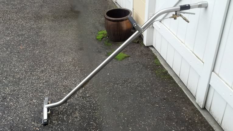

Get a Hard Floor wand and use your truckmount.
Work in small areas.
Spray down a neutral cleaner
Scrub in with a CRB or 175
Rinse with wand asap
Airpath (!) dry.
Better results, far more maneuverable, corners steps and other hard to get to areas with ease...
Much quicker too.

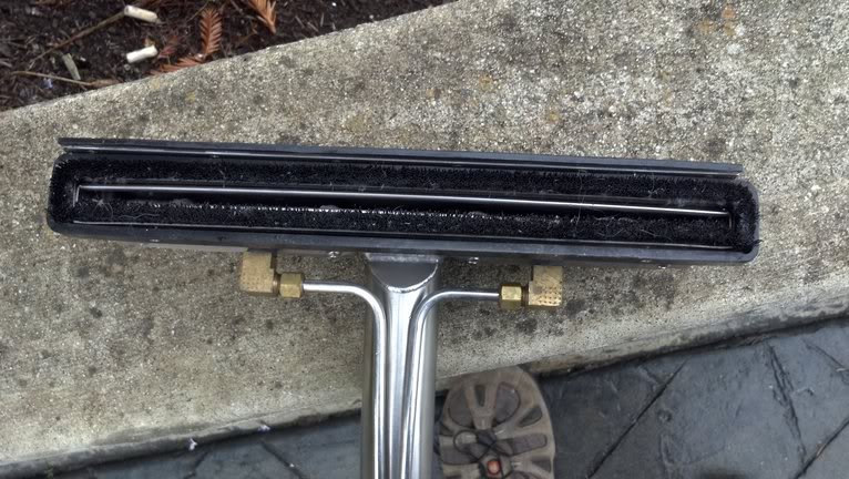

Ben almost every wand company sells hard floor wands. Most have a squeegee or a brush ring option, the PMF that I have has both..
Westpak, Prochem, Gecko/Interlink and Turbo Force all sell one similar.
300 to 400 is all you need to clean wood, vct, laminates or any other non porous surface.

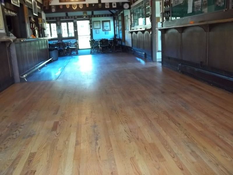

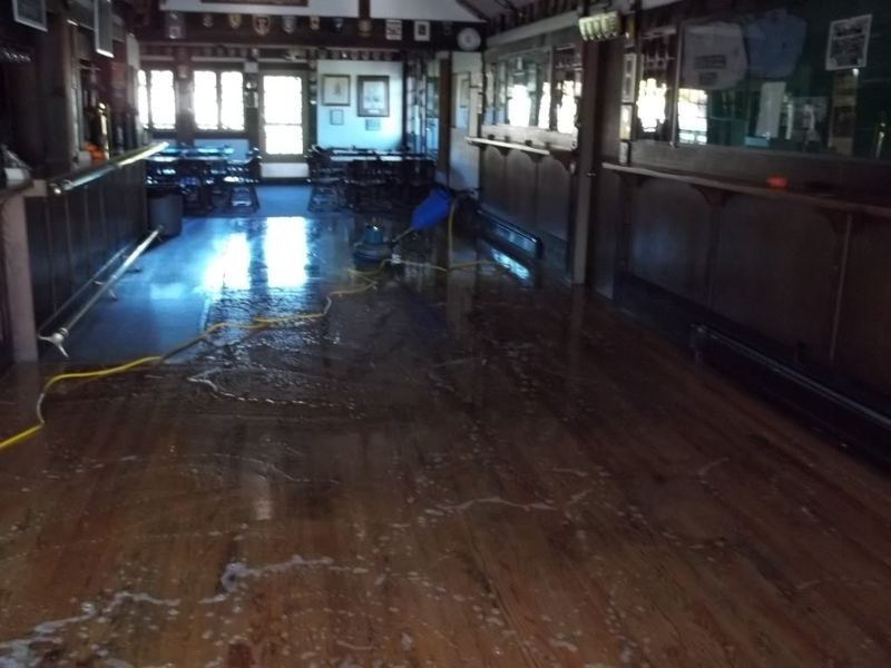

175 and a porty at my rugby clubhouse - damn, it's not like wood doesn't get wet.
Start:
Cleaning:
Finish:
