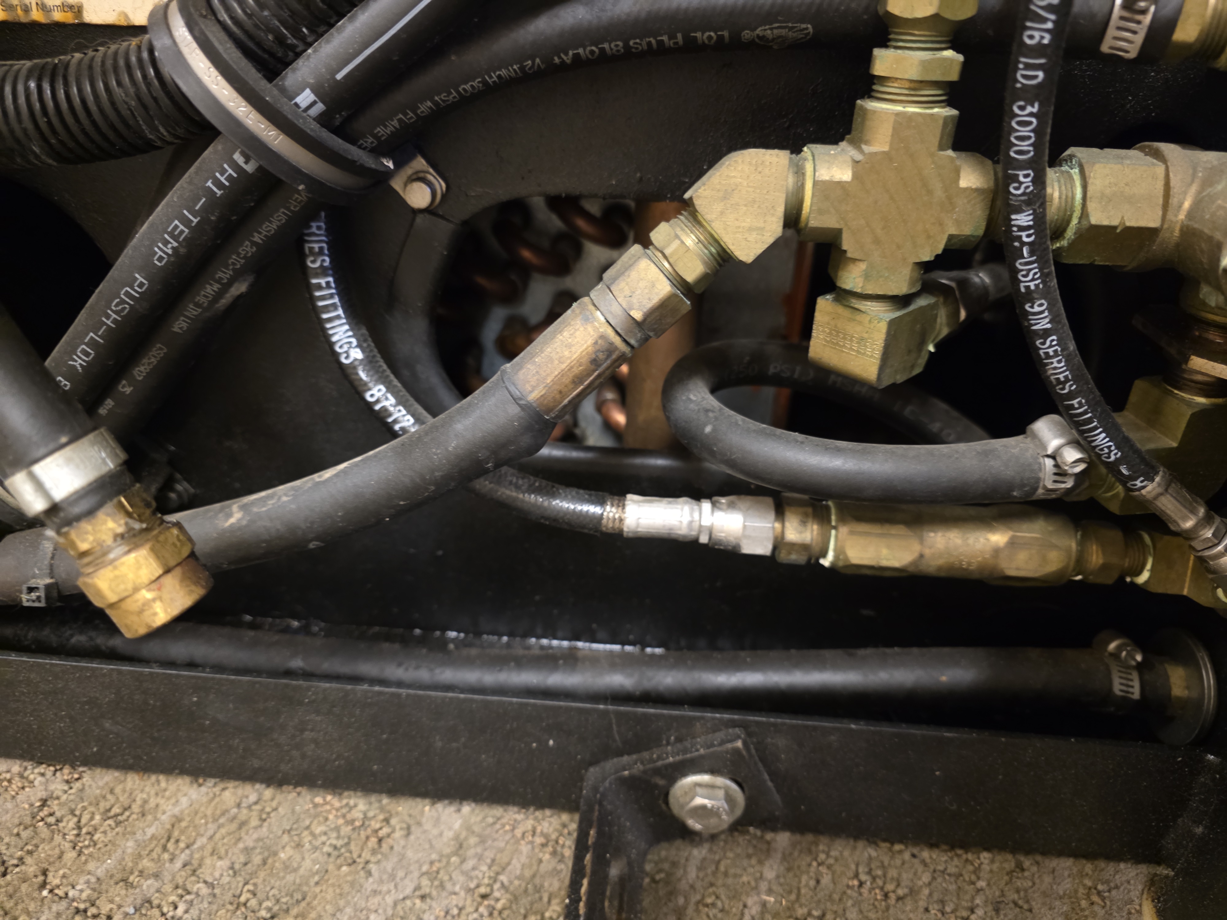

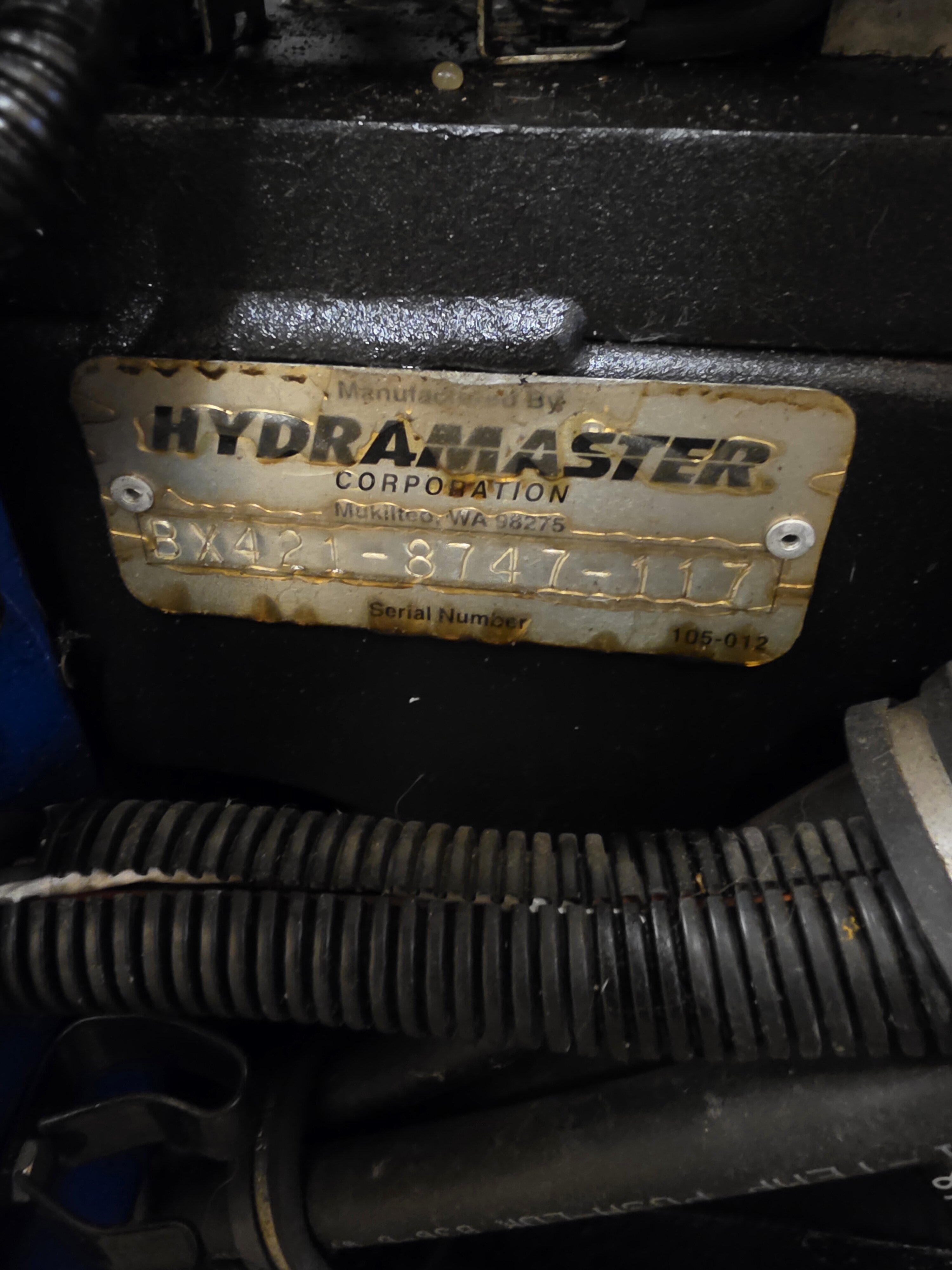

AI is thinking it may be a 2007 model. It shows 690 hours, but I was told a big portion of those may not be actual run time. Apparently if the key is left on, the hour meter continues to count, so they estimated maybe 70% of those hours came from that.

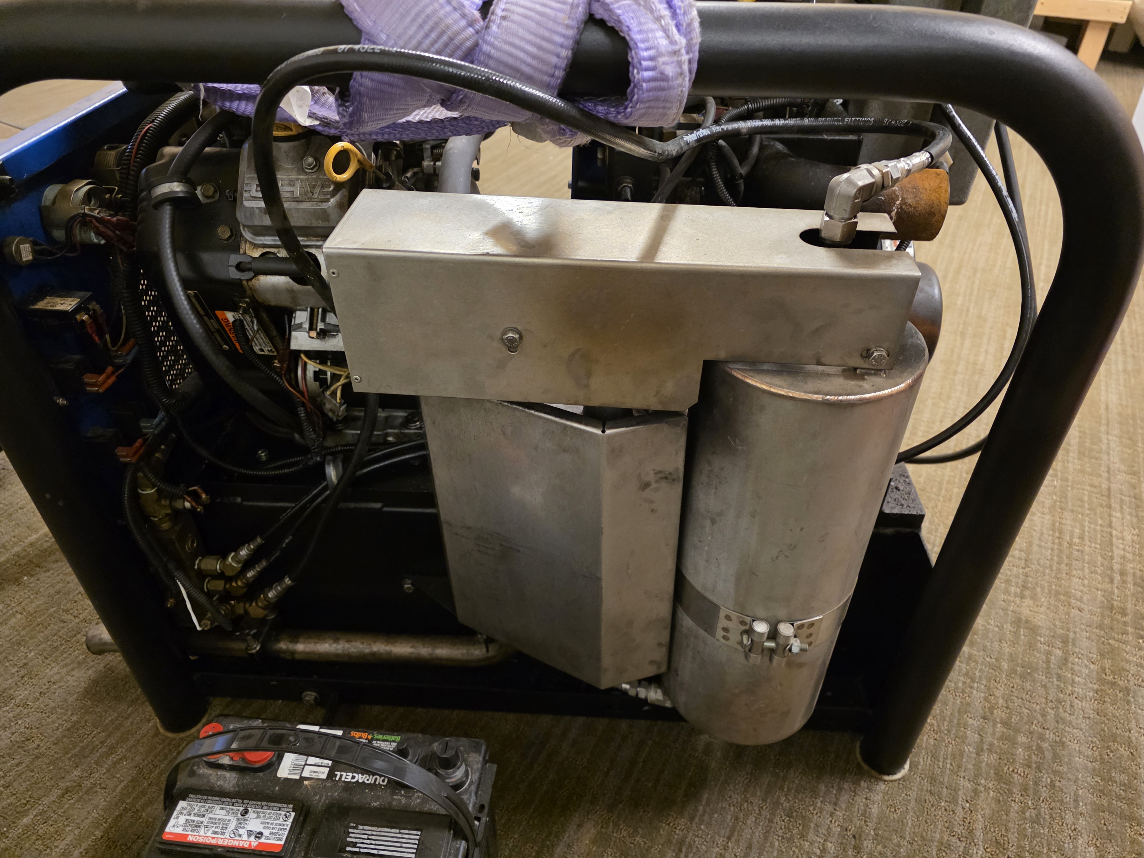

This machine has the stainless steel exhaust style heat exchanger, along with the blower heat exchanger that uses the copper style core.
From what I can see, it looks like dropping it out the bottom is really the only option. My plan is to set the machine on a makeshift wood table, cut an opening in it, and drop the heat exchanger out that way rather than trying to do the job while the unit is hoisted up with my Bobcat.
The Boxxer 427 gets a bad rap from some people, but mine has been excellent. It has also been a whole lot easier to work on than this 421. 20260330_192116.jpg20260330_192137.jpg20260330_192153.jpg20260330_192857.jpg

That one looks pretty good. Two other things you may want to check are the potentiometer / thermostat for the temp control and the hose at the top of the engine exhaust heat exchanger, we've always had problems with them. We keep a spare in the van.
