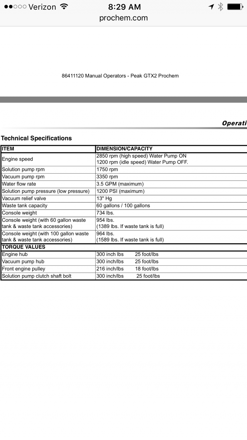

I was just looking at the numbers, and asking how they did it?! What size do you think they went with Tom?

Prochem builds their machines to last, they don't over the engines or put to much load on the engine.
You still get great performance.
Just wait try pushing a quad wand no glide for 15 years at 13 hg. You hand and shoulders will start to feel it.
Hence glides, still push the relief up and still work, the only thing easy about carpet cleaning is the 360 except the swirl pattern on some carpets.
