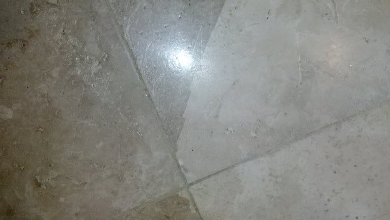

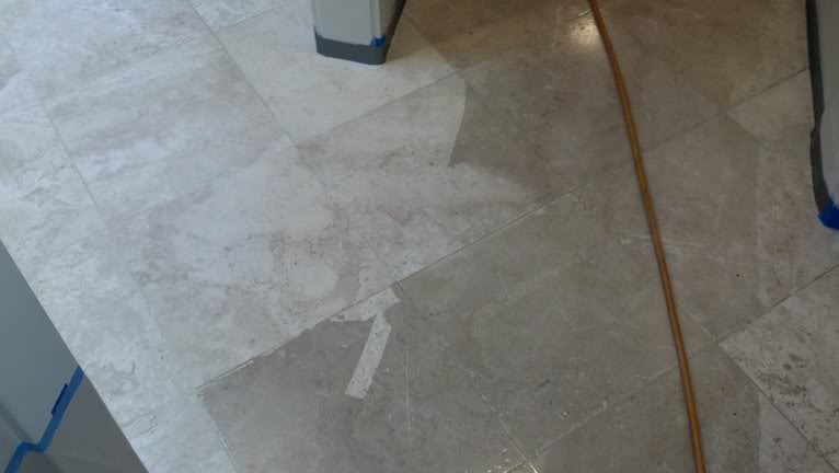

Stripped travertine all day today, Close to twenty coats of Trewax on this 10 year old floor. :shock:
Homeowner finally got sick of the scratches and nasty look and started to take the crap off wiht a razor blade :shock:
Each area took at least twice to get it all off, apply stripper, scrub with black pad, Nylagrit scrubbed again and edged, floor wand rinse, strip again with Oxy Blaster added to the stripper and rinsed with the Turbo,.Airpathed, missing grout filled and tomorrow we'll be back to Dry Treat it. Ugh.
Hoses were coated with wax, as were our shoes, tools and lungs...

I was wondering if you had to use a brush to get the wax out of the grout lines, or did the pad take care of it?

3M SPP pads would have stripped it without butyl. For us they have revolutionized stripping.
You would have to follow with the brushes for the crevices.
