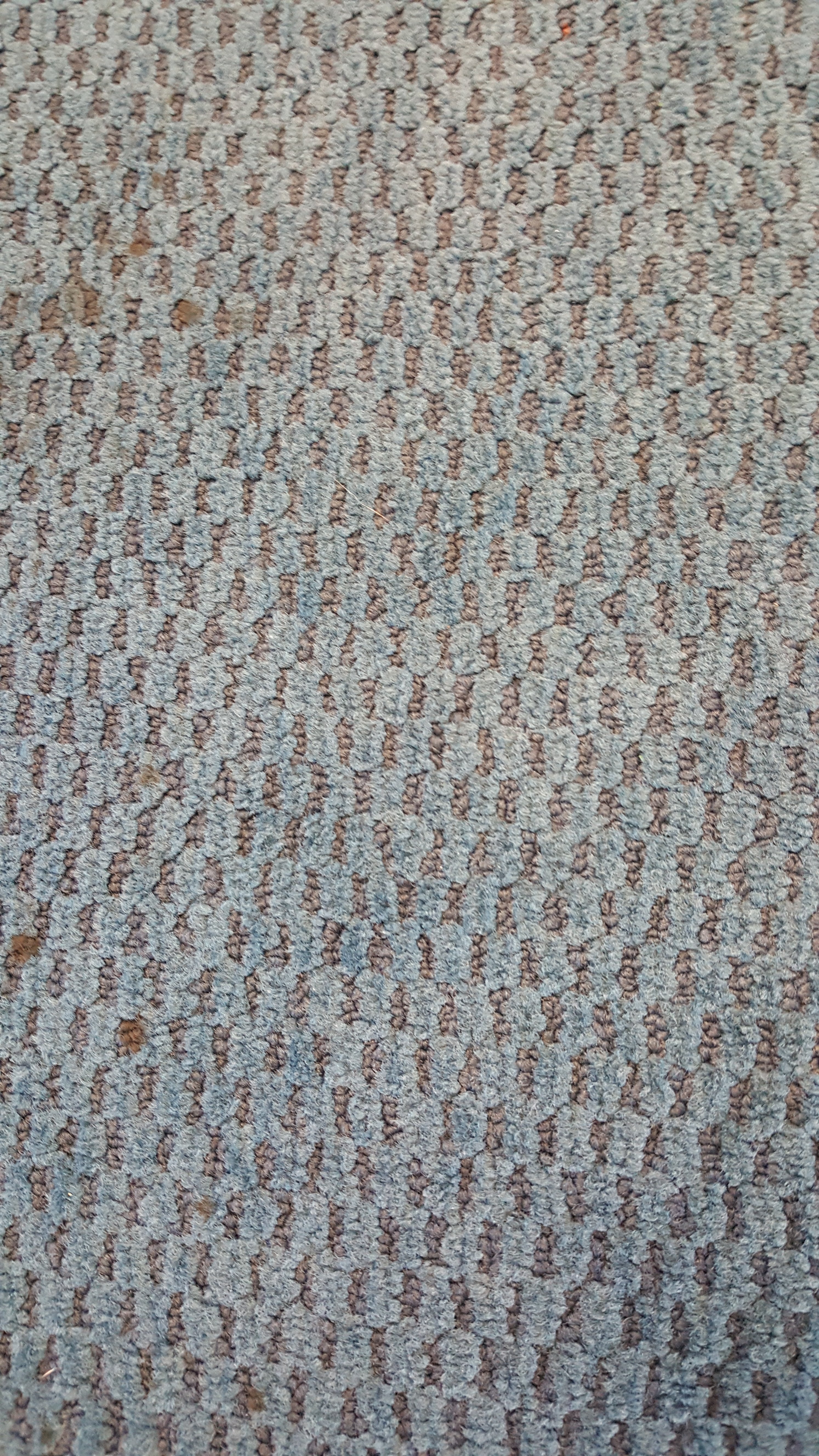

Can I use the zipper SS on this carpet?
Cleaning Professional
7,040
The color is more blue in person. It's not glued down.
I just got the Super spinner and hoping to us it on this 8000 sq commercial job.
IF not I have the zipper or 360ibh. Or 20 inch brush Pro and swivel wand.
7,040
on what carpets do I risk "crop circles"?
jwfoulk12
Aug 10, 2012
861
Justin Foulk
Ive used the ss on nylon cut pile and still never left crop cirles that couldnt be groomed out. Ive used the ss on loose area rugs as well so it definetly doesnt need to be glued down, and ive used it on carpet with ripples. If I had 8000 sf to clean you can bet your ass that im gonna use the ss to plow threw it.

Zipper SS. You gotta watch for crop circles on plushes.....even on short apartment grade. On those, you can back off the pressure, but the crop circles seem to show up on the unused carpet, like under the couches and along walls. Usually right when you change directions against a wall. Never a problem in the traffic lanes. I run mine at maybe 900 psi.
I've never seen it do that. ???
I should say we groom everything and it grooms just like wand marks. It's not like the XL swirl marks that won't groom out no matter what you do. These come out with ease.
