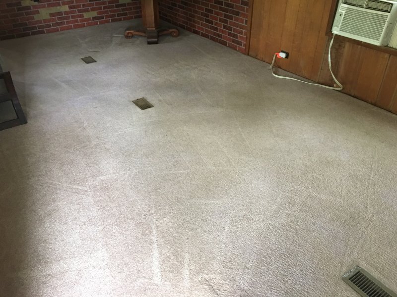

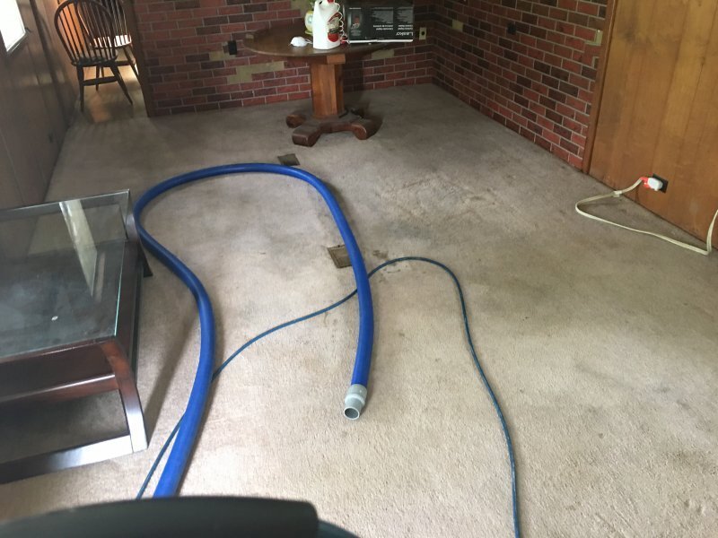

Day two with the "detergent rinse"

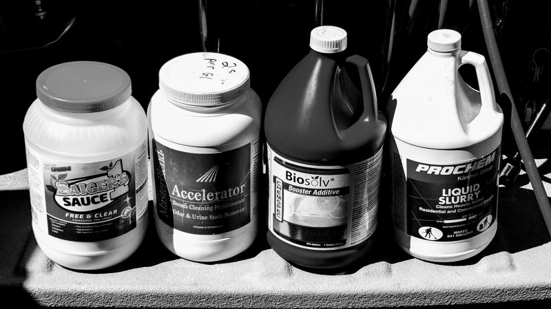

Our two restaurants in Scruz have noticed a big improvement in how long the carpet stays clean one we got off the purest fad and used some Slurry in the rinse
This one got a good Slurry today too...

We fresh water rinsed for decades with the thought of leave as little residue as possible. They we tried Prochem's Dry Surry (circa 90's) and out customers ranted and raved how much better the carpets looked. :eekk:
We'used a non water rinse ever since. If not an emulsifier then an acid but never just water. :biggrin:
