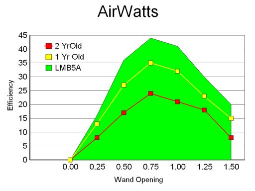

The key is efficiency of converting electric power into vac power.
Ametek has made some gains with the 8.4" & 6.6" Hi-Airwatt series.
Chart from an earlier post on vac motors on efficiency (LMB5A is 8.4" Ametek)
vacefficien-jpg.57135

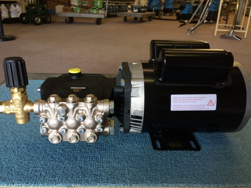

This General Pump system is what we are putting in new portables:

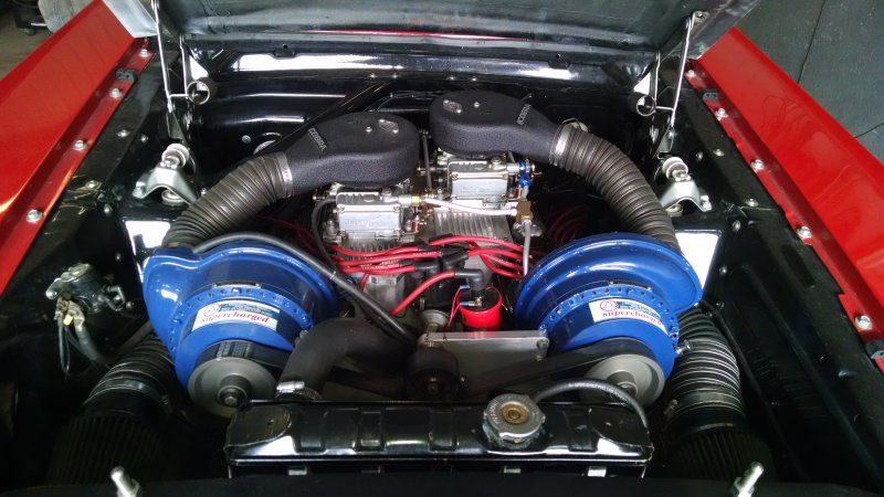

I think you mean the turbo chargers. I think the super chargers are similar to TM blowers already. In fact roots makes superchargers. I don't think you will get any more power than what is already available with the new vac motors for the same amperage draw but it's worth a try if you have the time and money.

Jimmy. ...hate to burst yor blower bubble but it takes 900 to a 1000 HP jus to turn a blower on the top fuel cars in NHRA.....HOWEVER they produce over 10000 HP
....So get busy...I want to see you get sucked though a porty

Superchargers are belt-driven like TM blowers.
Porty vacs are ran off integrated 10-12 amp electric motors.
2 different animals.
