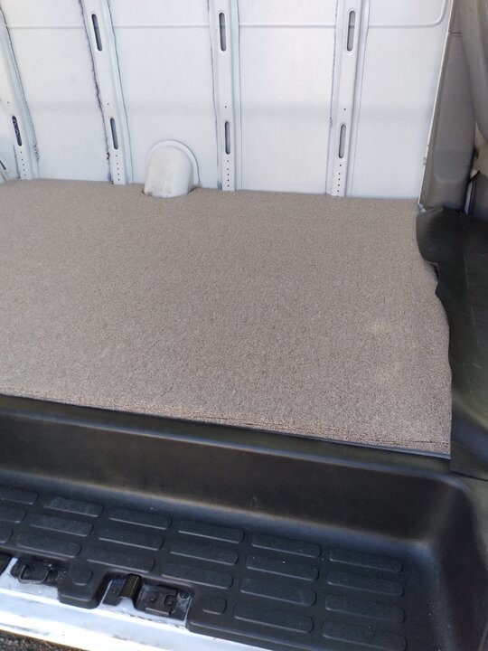

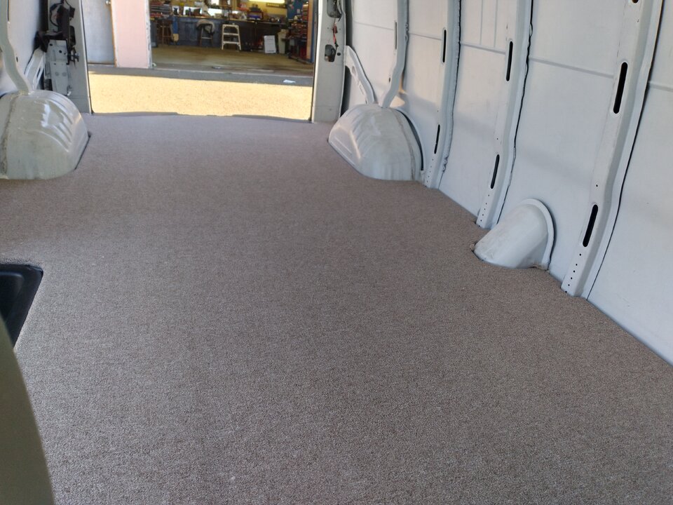

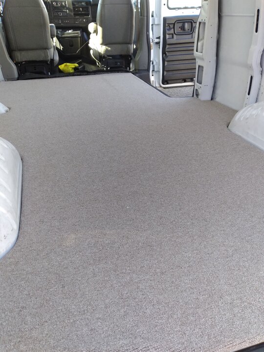

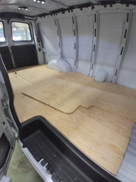

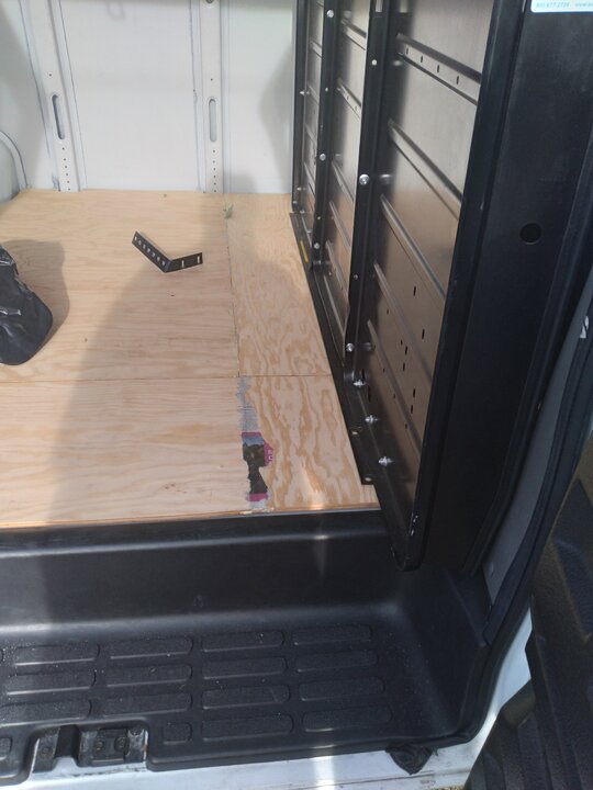

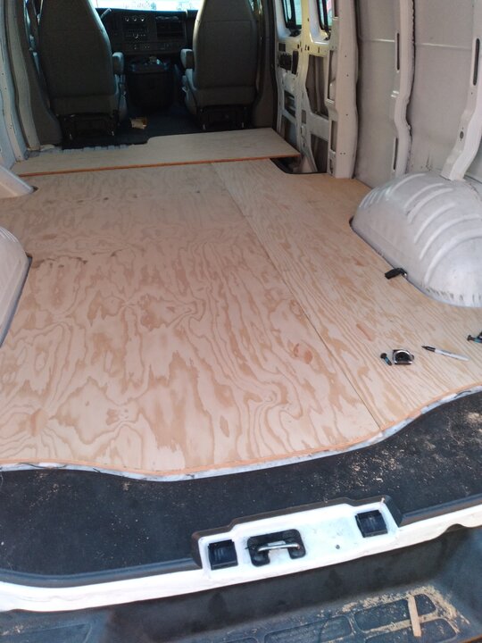

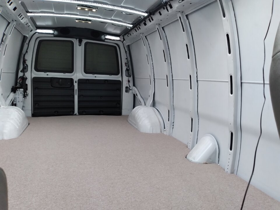

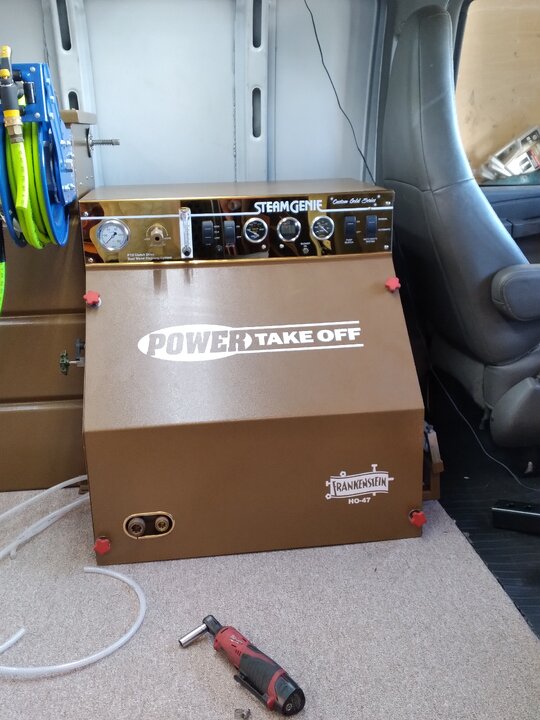

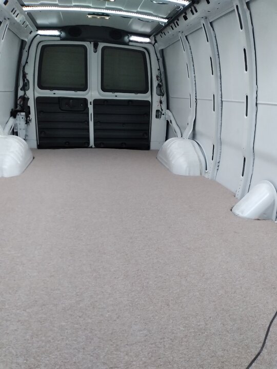

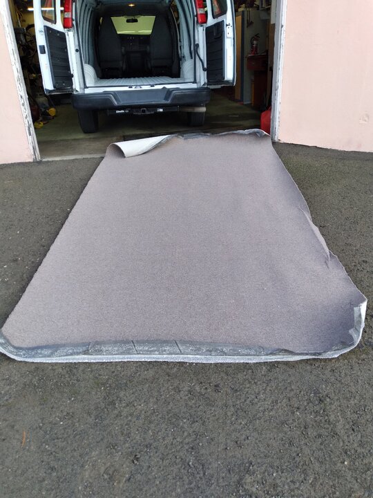

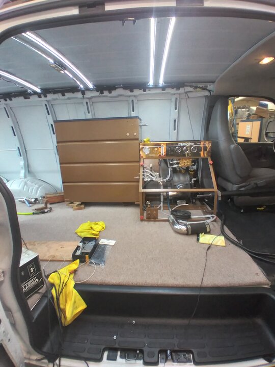

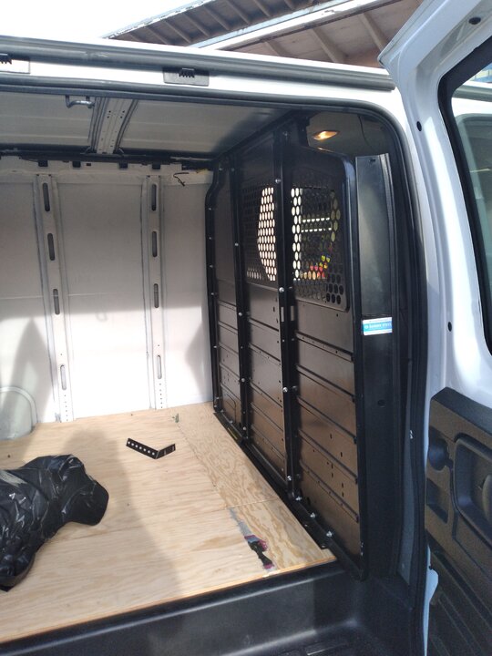

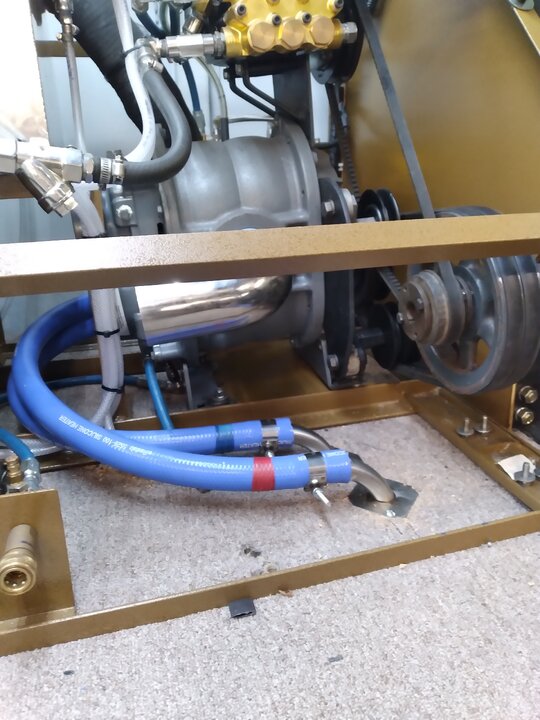

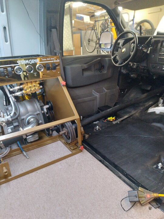

Ive always installed a 2 piece plywood floor with a glue down i/o carpet just as steamgeni did on all of the machines they installed. None of my vans ever had any floor rust problems . I pulled the floor outa a 1998 not to long ago to use as a template and underneath was/is still great generally 2 -10' sheets are required to make a floor but mylast van was extended and required 14" be grafted to the end to make it long enough then after cut to fit ilay the carpet backside up and place the well glue covered floor board on it and wrap around and staple with monel staples while glue is still wet slightly fold the floor and install it in van then i use a borrowed linoleum roller to set the carpet to floor boards only precaution is before i drill any in the floor i have a long bolt and a pair of vice grips . I heat the bolt with a propane torch and melt the carpet before i drill so as not to have any runs in the carpet the only thing i would do differently is i woud have had my local sheet metal shop eighter cut a piece of stainless to lay under my machine or fab a stainless pan. But my machine is a pto and the carpet inside the machine gets dirty and is impossible to clean. A final thought if you're considering doing this be sure that when you cut the floor make sure that you do it in a way that the single seem lines up with a raised rib in the floor so as to be supported and not flex when weight is put directly on it. No extra fasteners are necessary everything that bolts thru will hold it in place
