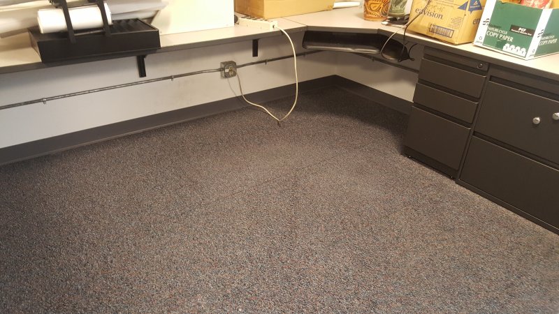

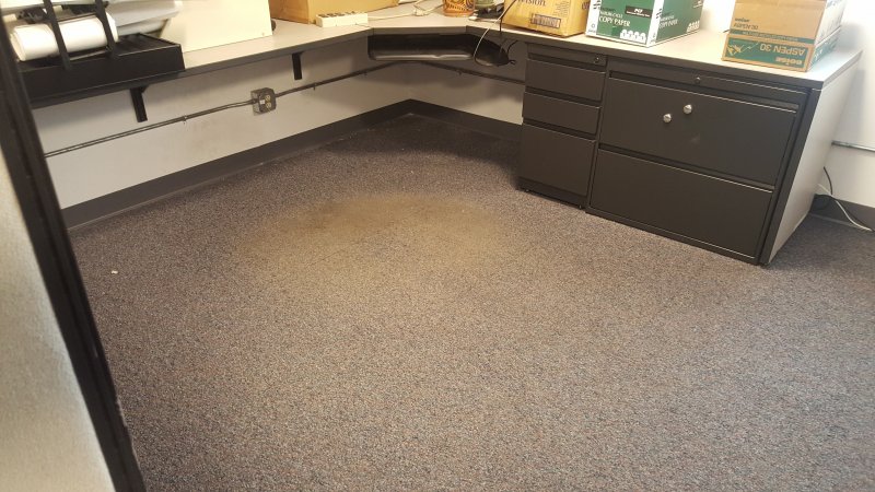

Well... I am a rare bird that gets top dollar of. 38 cents per Sq foot.
Today each van made about $550 per hour and we just booked a ton of work at same place for next week
We made about $550 per hour per van...
If you can make $150 to $200 per hour per unit.. Golden... IF... that meets what you need peer hour to be profitable.

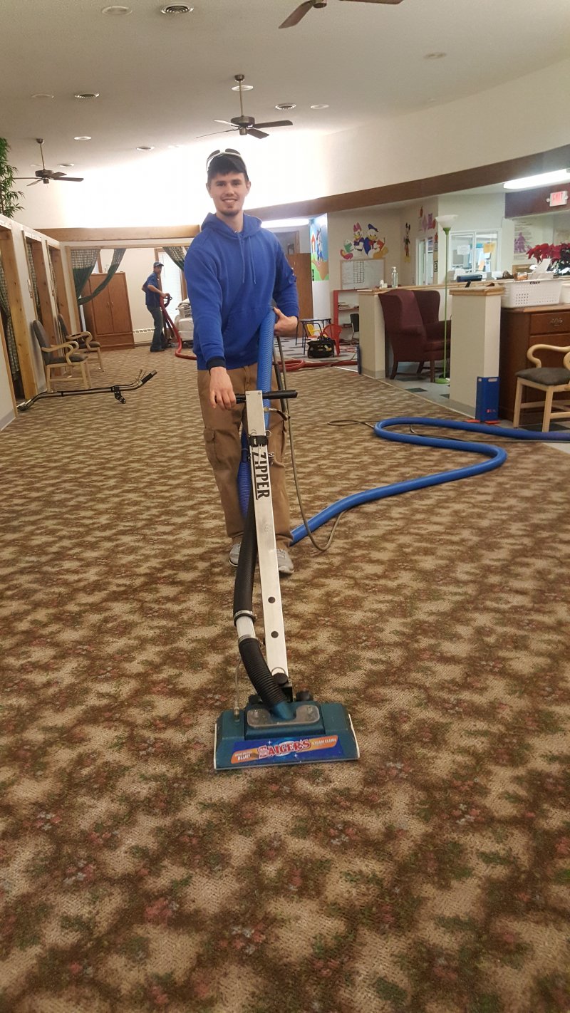

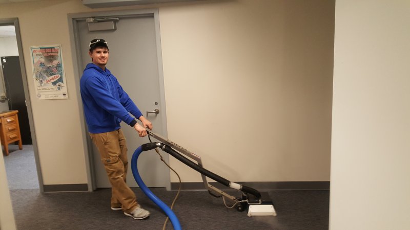

Zipper t SS Super Spinner killed today and made us a lot of money!
11,200
Had Ryan Albert from Madison Wisconsin come visit and clean with us :)
