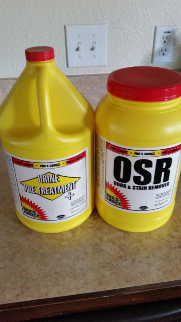

We are using larry cobbs light to identify problem areas and mixing up cti osr pour over areas let soak for a few of minutes(10-15), extract and repeat and least twice.
Just wanting to know if there is something that works better of faster than our process.

OSR is a good third step, and sometimes works as the second step on really fresh deposits.......But you should also think about removal of the source, too.
Urine that has had a chance to sit a while, changes from a water soluble liquid, to a dried on deposit with water insoluble salts that are well not removed with OSR. You may remove the stain, but the odor is likely to return, and eventually spotting, will return too. You should think about an extraction using a good urine pretreat designed to solublize the accumulated source material. Then proceed to treating residual staining and deodorizing the trace remainder, to acheive a complete treatment.
Urine, like smoke and water damage, has to be assessed for the amount of treatment that is required. The solution ranges from simple to complex, depending on factors such as severity, quantity, scope and time since the incident that caused the problem.

What products do you recommend Shawn and what would be your system for complete removal?
I have to be really careful, as in my professional position my company represents many good brands. I'll ask that I leave particular brand names to the end users who may post on this thread.
Generally though, the urine pretreatment products are usually pretty clear in that they indicate they are an acid side pretreatment, specifically for urine. Common names include "urine pre-treatment", "Urine Prespray", "UPS" or "UPT".

I just bought a case of Cobb's UPT and I am almost out. I was very impress by its performance, it leaves a nice scent also. I will be ordering in 5 gal containers from now on. You beat me to the tread, I was going to start one on how well his product works.

Another option is to pretreat with Bridgepoint's TCU Neutralizer which works on both the salts and the lipids, flush and then follow with PetZONE with Hydrocide. It should not need a second application.

We use the yellow bottle.. urine pet treatment used above. Sometimes it doesn't work the first time with cat urine and we have to go re spray a few days later. Dog urine, is never a problem. Kills that smell right away.

urine pretreat, suck it all out and rinse till product smell is gone. leave behind bac out if needed
