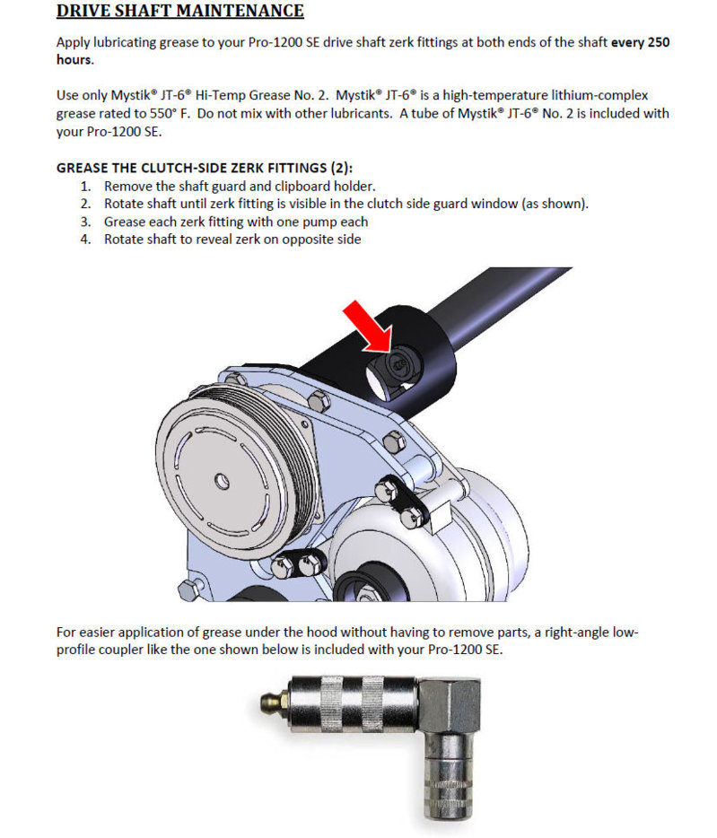

Now we are getting into a serious issue. WITF did Sapphire change a perfectly reliable no maintenance drive shaft to something that requires not only grease fittings but removing the engine cover. I've never done this in the 28 years I've owned Pro1200s. In fact I've never removed the engine cover on my 03 Express but my mechanic has for various repairs and tuneups. I looked it up and it looks like a real PIA.

does the grease fitting on the front end under the hood sling grease or is it pretty minimal?

Omg.... That looks like a major pain. And you know you are going to brake those clips off the side parts every time...
That's Sapphire for you.
Over engineered.
If anything I'd say it's GM that made things difficult. Did SS design the engine cover? My Ford it pops off in 30 seconds.

Oh hell no!! My Ford has 2 latches. that's it.. And what about the Hydramaster CDS???? with all the guts inbetween the seats, there's no way your getting that doghouse out right? I'm starting to like my slide in more and more :()

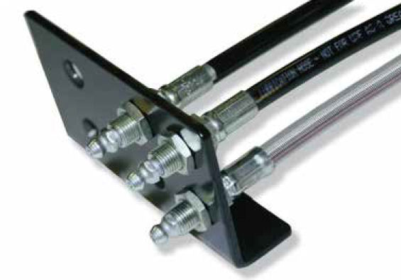

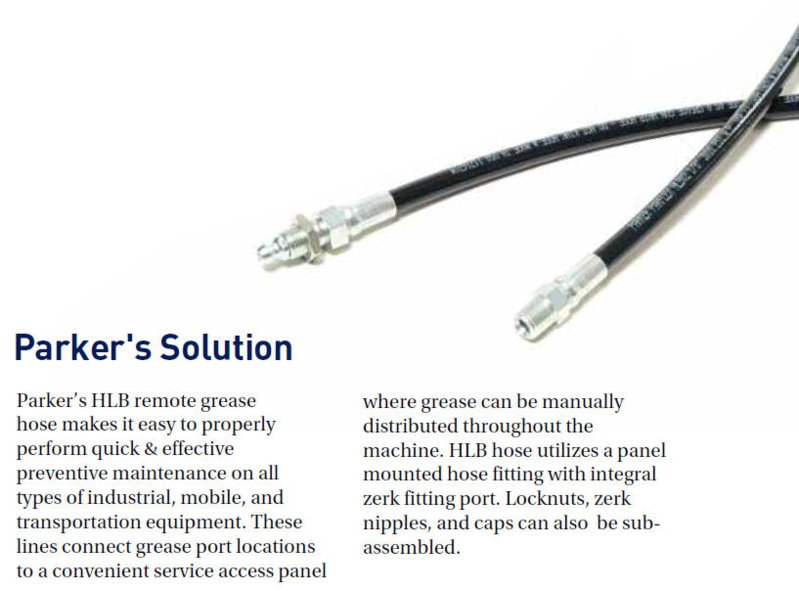

Is The grease fitting not acessable from the actual hood, thats where i see a grease gun with a simple flex line being a huge time saver.

I also look at it like this, if you have to look at and touch the drive shaft you can see if it goes bad instead of finding out after you destroy shit. Even sealed grease less drive shafts will fail. Just so most people know, drive shafts whent grease less and sealed to keep debris out, however with the drive shaft being high on the chevy engine it might get some dust but nothing like a regular drive shaft by the ground would, and its in front of the tires, so no spashes of sand and dirt. Would have been nice to have greaseless but hey cant have the easiest everything. Beats changing oil all the time in a slid in, or couplers going bad, or worrying about a fuel leak inside the van, or your fuel pump rusting out.

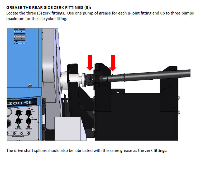

True, I was picturing fixed bearings. So the driveshaft has u-joints? My bad.

Ok Scott I went and looked at the manual - now I remember seeing this when Mikey posted pictures, I had forgotten. The Sapphire manual mentions 250 hours, and seems to imply that removal of the inside engine cover isn't necessary, in fact they mention supplying a special grease fitting so it can be done under the hood. Am I reading that right?

Well that's not so bad. At least there's no engine cover removal. I could do that 4 times a year, at least for the first few years. Then I would get lazy.

I'll take better air flow everyday since the pro1200 doesn't have 90 degree bends on everying vs having to grease a u joint once every other month. :)
