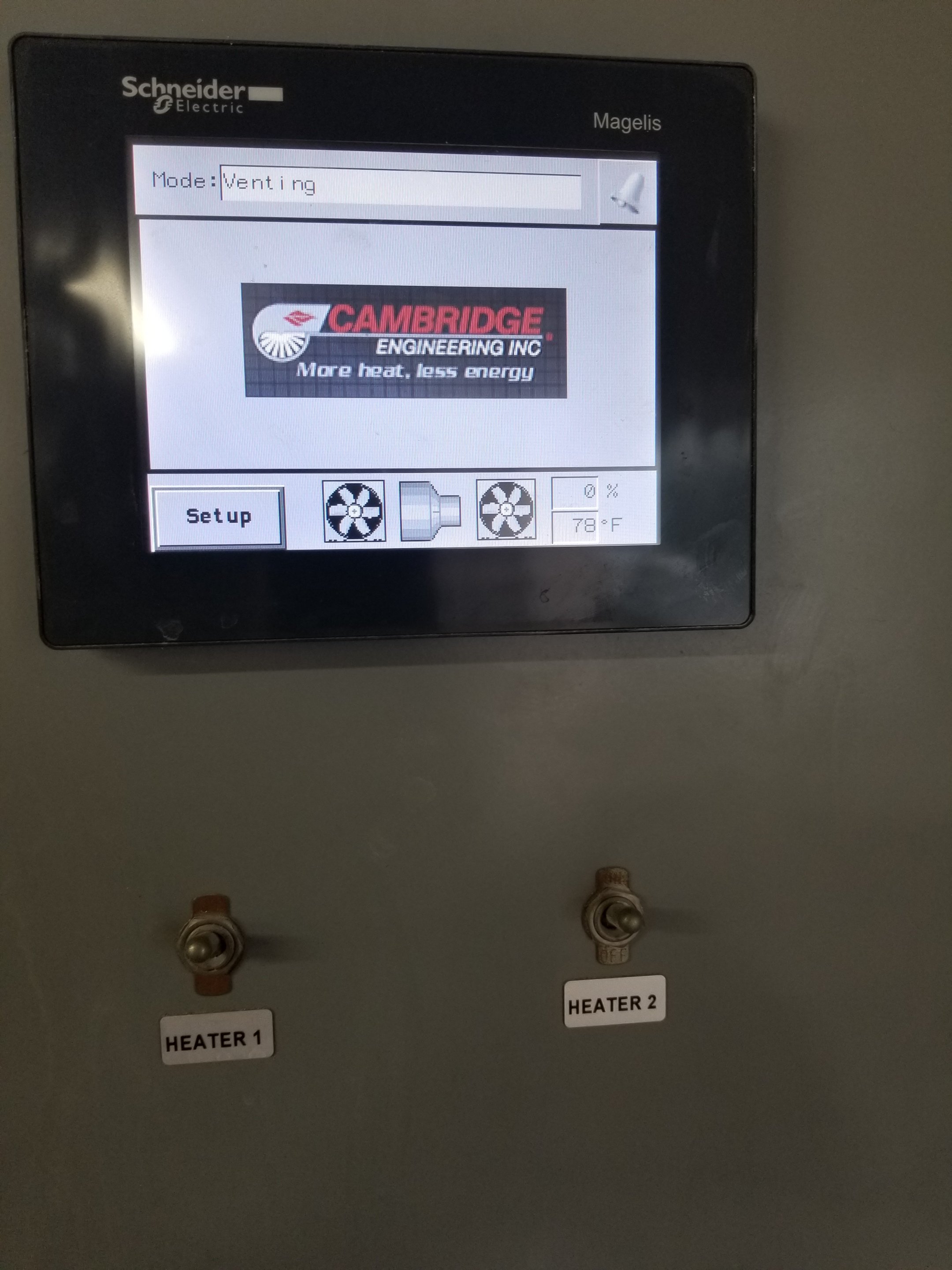

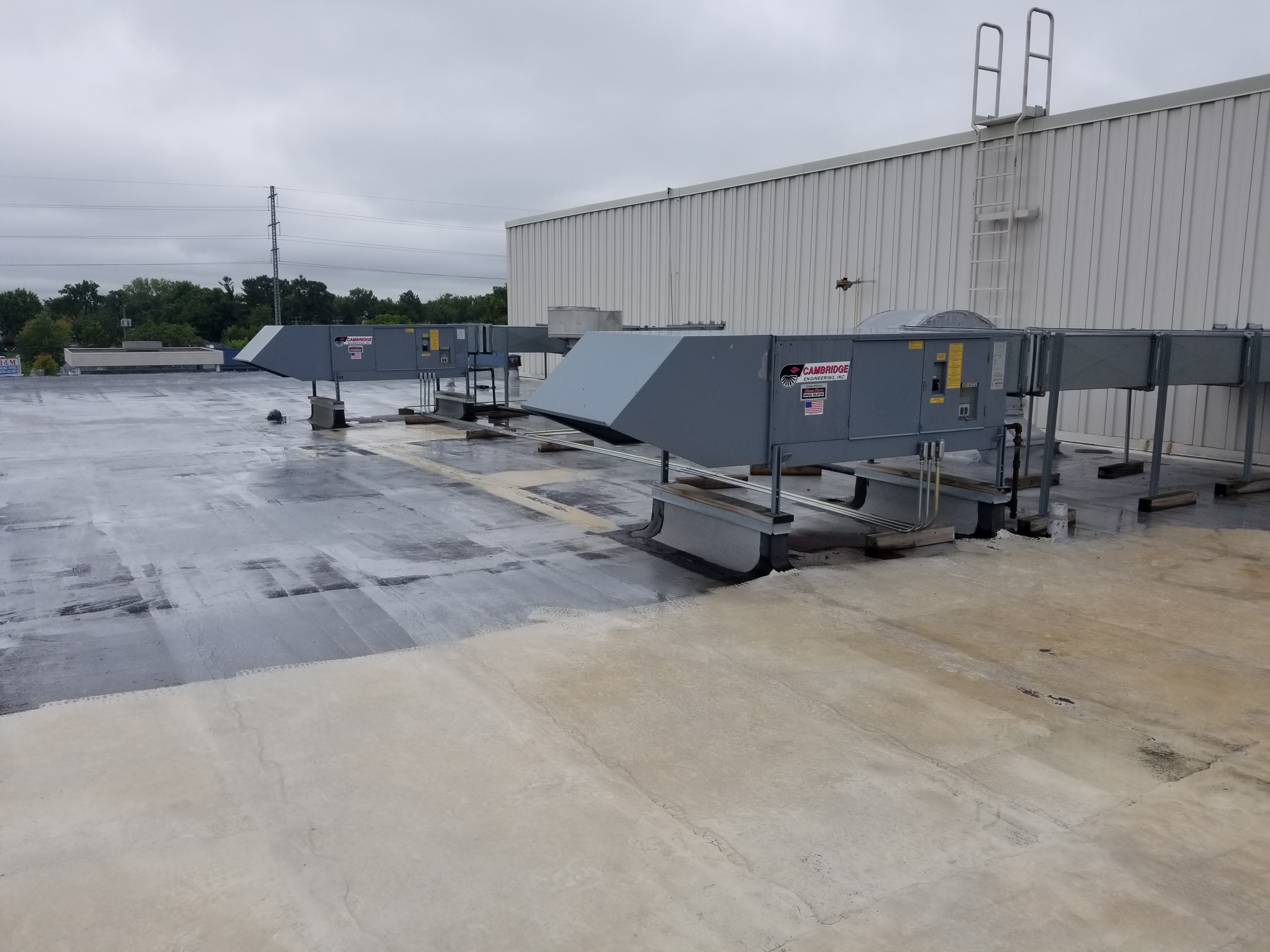

Brian H
Dec 14, 2006
3,776
Brian H
Damon I should have shown you our systems while you were here. We have two Cambridge units that are mounted outside on the roof and feed into our dry room. They are computer controlled and vent the room when certain humidity/temperature thresholds are reached.
