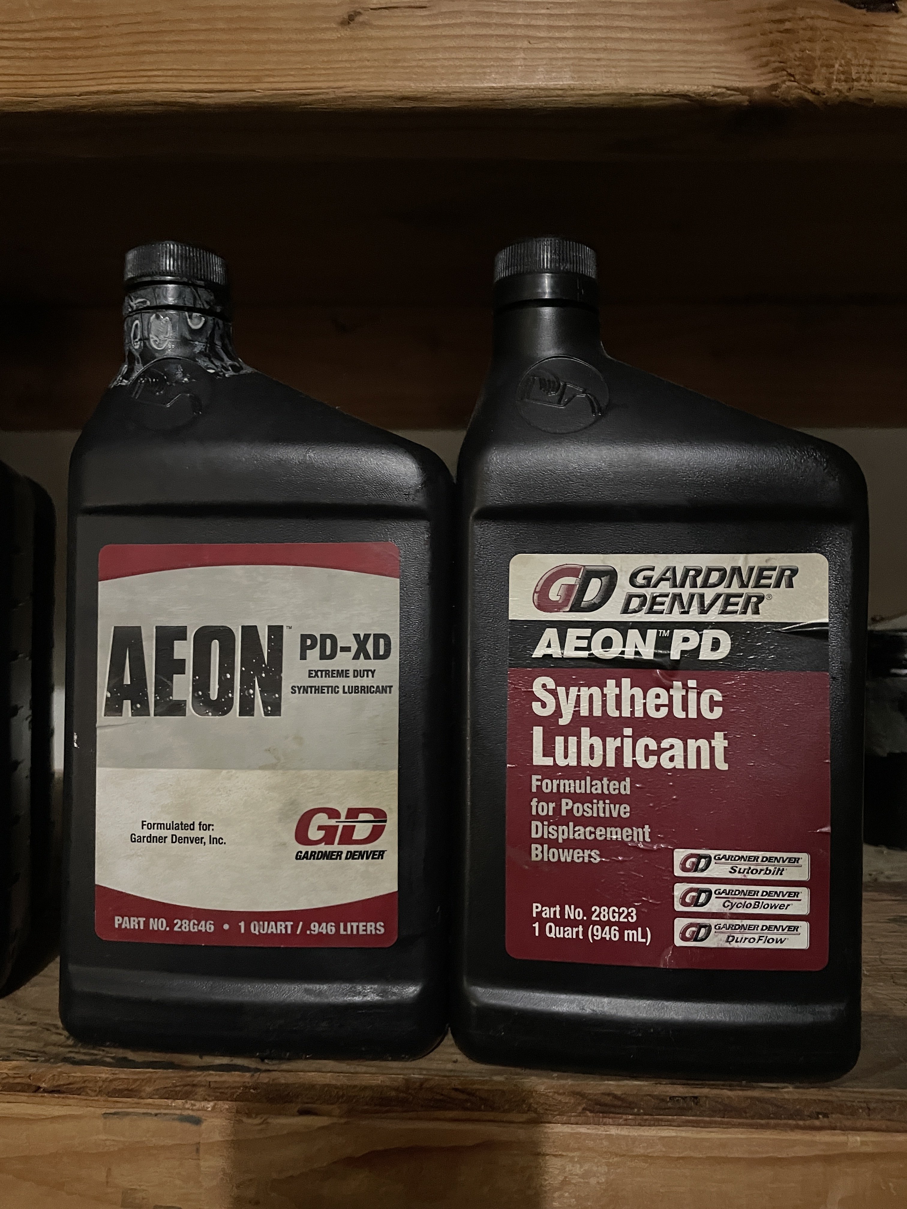

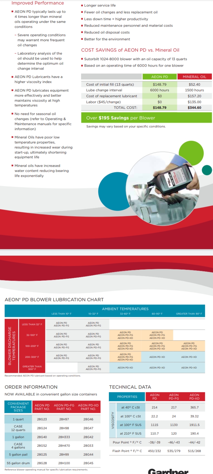

Dwain Ray
Jul 22, 2020
268
When i said same oil differant label, what i was saying is yes you can mix the 2 together like mobil 1 and mobil 1 high mileage, there is a difference in the 2 areon oils and most has to do with extreme operating conditions ie: ambient and blower discharge temperatures , if the 2 were setting on a shelf side by side i would buy the pd-xd but if i had an open bottle of pd i wouldn't throw it away
