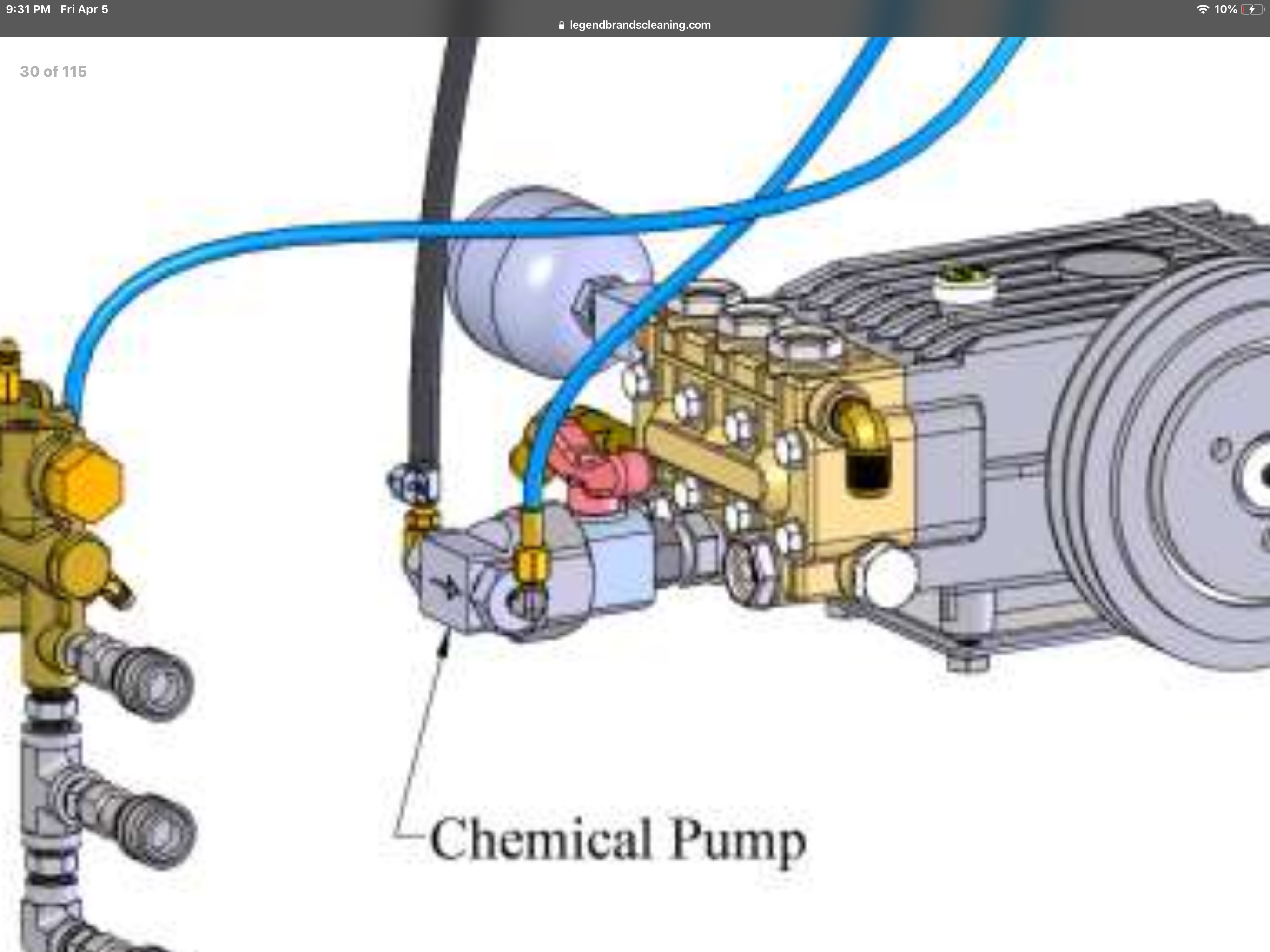

What's the secret to taking these apart without the threads locking. The last couple of stainless pumps I opened at least one side crossed threaded upon disassembly.

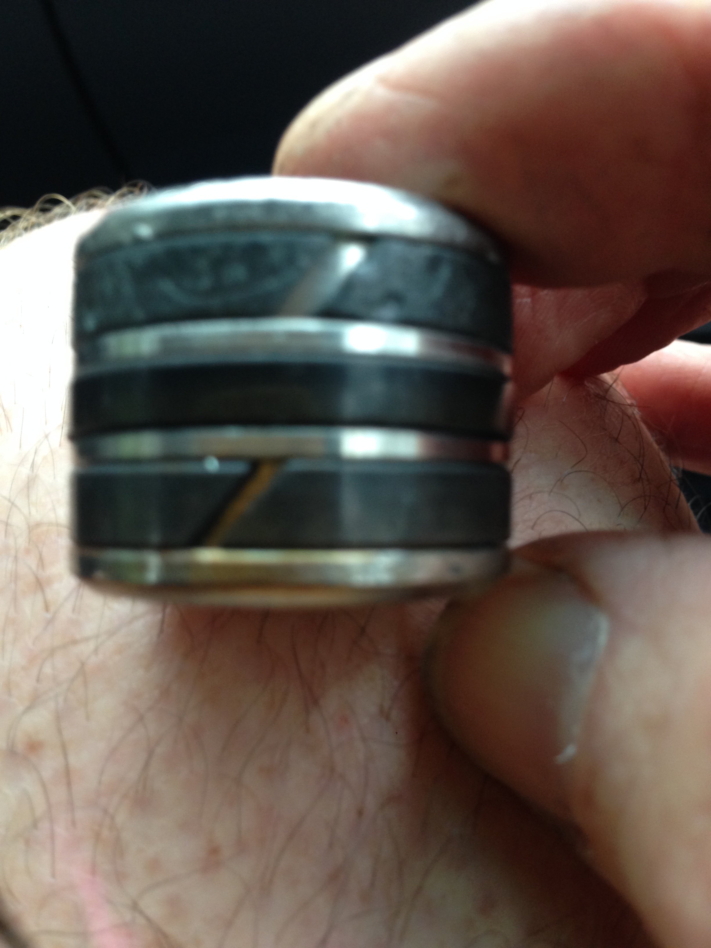

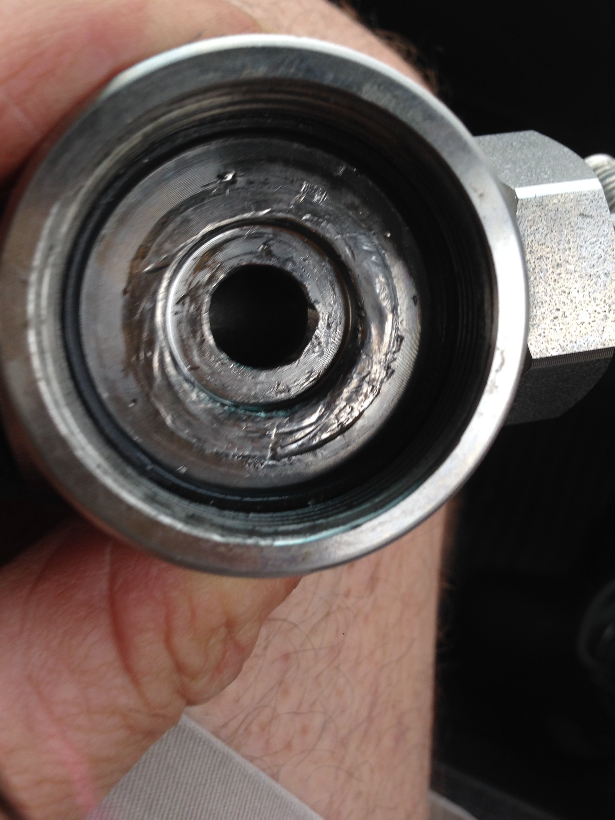

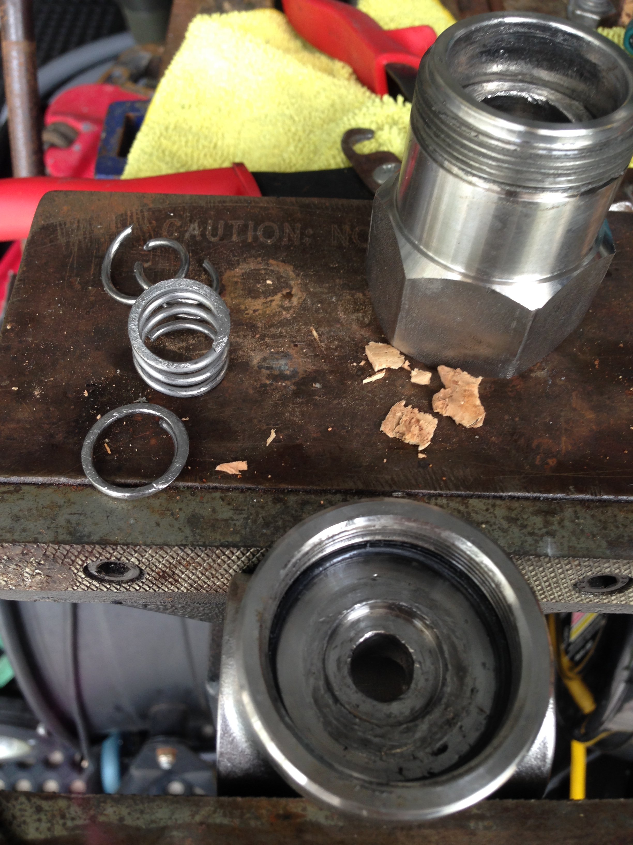

Not a very durable pump. Didn’t even survive a year. I suspect this is why I’ve been having problems with it for a while. The spring finally got to bad to work. You could still force prime it with high pressure water and it would work unless you let it run dry. Then it was a nightmare to reprime. Small parts of metal got through into the solution line damaging other quick disconnects. I think I prefer the old style with the shut off. I’ll need to source part and I’ll change them out on a schedule. This time the parts are covered under warranty. Gp’s site says it’s warrantied for 5 years but I didn’t have a change to read what exactly is covered.

Well I’m happy to report that general pump will replace the entire pump. They want it back to see why it failed, no problem. I’m glad I didn’t trash the spring parts. They are curious about the product being run, which was ice. We clean a lot of tile at 2000 but never come close to the 3000 limit. I’m glad Legend Brands stepped up and made it right. The spring Is $3 and the 3 o-rings are $55. I’ll pick up some springs and replace it as general maintenance. Problem solved.
