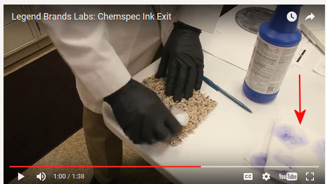

It looks like a little bit of false advertising to me. Look at the video between :58-:59. It looks like there's a lot of visible ink still on the carpet, but in half a second later, it's magically disappeared for him to just lightly brush it with a freaking napkin.? Plus, he overwet the carpet with that stuff for it to go right into the pad. I don't care if you overwet clean carpet with just plain water, something is gonna wick up. Screw that. I'll just stick with my normal ink remover
Matt - the video has obviously cut to the point where all the ink has been blotted up - look closely and you'll see the pile of towels used to blot. Pretty sure they're not trying to imply that one tap with a paper towel will do the trick...
Thanks for bringing that up. I just focused on that ink spot and opened my mouth before I looked any further. I'm glad you guys don't take any of my advice. I'm more like my European ancestors than my African ancestors. I come to a conclusion waayyy too fast and take too many risks without thinking of the consequences.

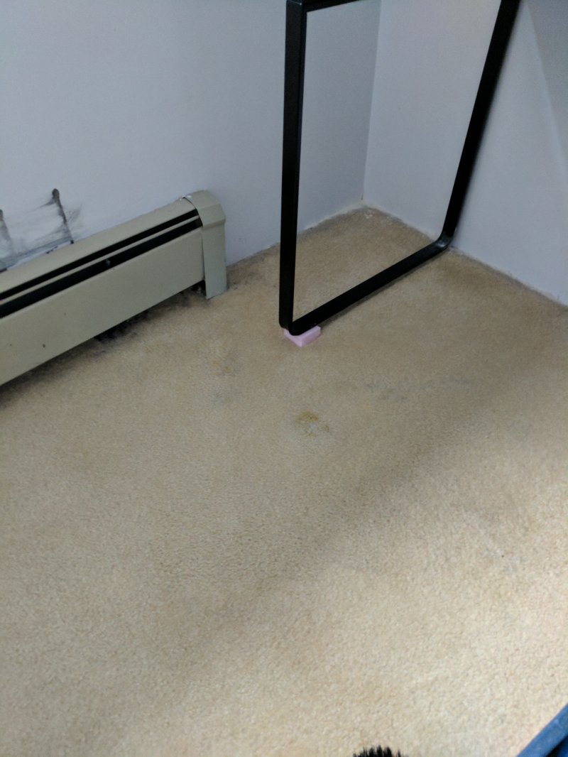

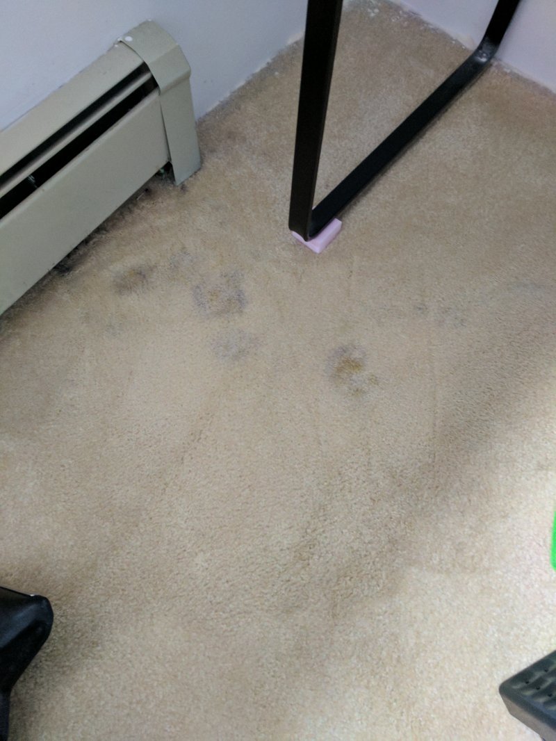

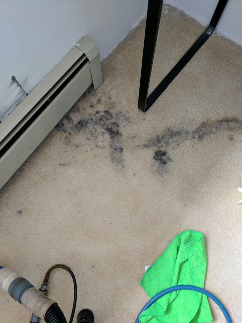

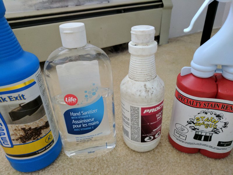

Here are some photos of my ink job today. This was a bottle of calligraphy ink that was spilled. The lady tried to clean it with Resolve and alcohol and had separated the ink into its individual components somewhat. I used all of the products in the photo starting with the ink exit. I used 3/4 of a bottle and ran out, there was so much. I applied the other products and although they worked to a certain degree, the ink exit was by far the best product. I alternately rinsed with my Ron Toney upholstery tool and water claw. Final step was to apply 2 part peroxide/ammonia solution. This is the largest ink spill I have ever attempted.

Not bad. Couldn't reach the ink under the baseboard heater? Looks untouched.

We got quite far under the baseboard but what happened is when we were spraying the oxidizing solution, more ink dripped off the baseboard heaters requiring a little more last minute work. Our last product is Esteams Eliminate which we sprayed and brushed in several times . I have good results with this product, if anything wicks up, it comes into contact with the solution and the color disappears. The odd time, I need to go back and give a second treatment. Most ink stains are just one or two small marks. This one was horrendous. I will definitely buy some more Ink Exit. Maybe by the gallon this time.
