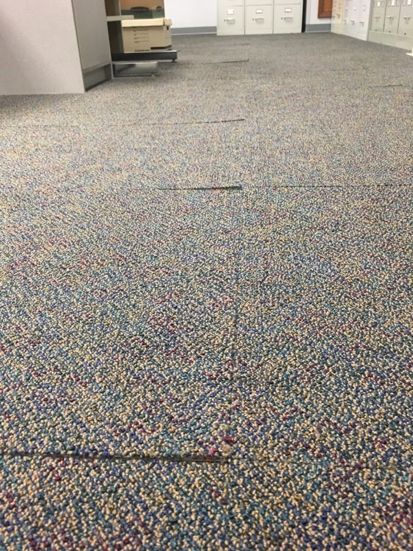

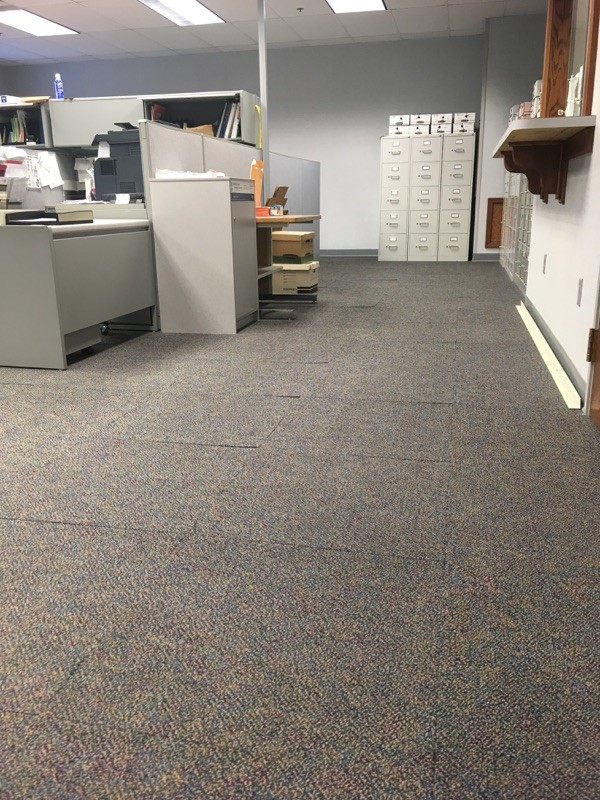

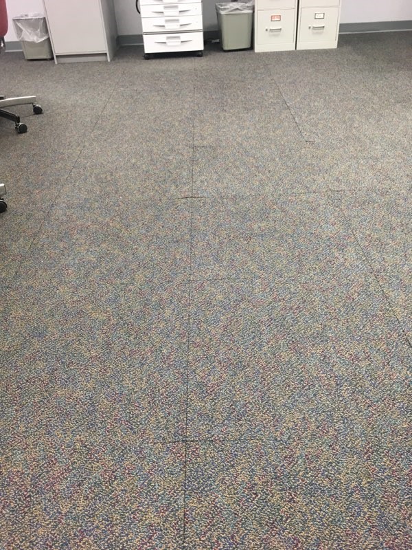

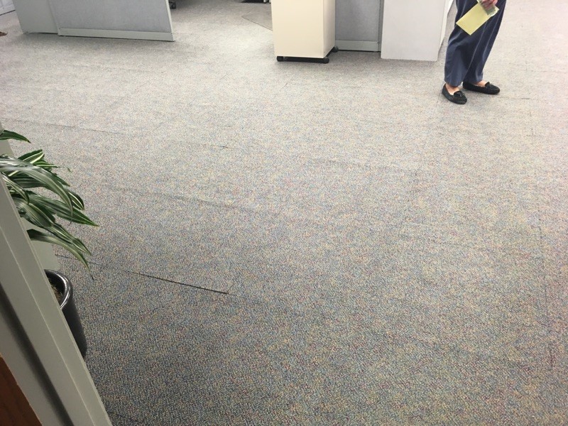

We have a commercial account that we have serviced monthly since 2013, we've always used the Cimex and DS2. The same team that has serviced this account for 2 years went out on Tuesday night like normal but on Wednesday I received these pictures.
Client is stating that the cleaning caused these carpet tiles to lift up on the edges? I inspected the Cimex and Pads used on this job and nothing seemed out of the ordinary. Not exactly sure why this would have happened or if it is a scenario where there tiles have always been this way but coming back after a week off for the holidays has now made them notice it more?
I'm going out today to inspect, we clean 100's of thousands of square feet every year with this method and have never had an issue in 8 years, leading me to believe that this wasn't caused from the Cimex or cleaning process.
Any insight appreciated. Thanks.

I don't know if its shaw carpet tile but back around 2009-2012ish. They have a bad batch of tile that would curl like this. Also carpet tile will curl like this when installed over concrete with high moisture in it. Remember high concrete moisture can be in a existing building as well as new construction. How much solution at the guys going through when they clean? Are they running the gravity feed wide open or feathering it?

The Cimex machine certainly won’t cause carpet tile to lift. In fact that’s one of the things that’s so great about it. Because of the planetary scrubbing action there is no kick on the edges of the tile. You could actually take a loose tile, set it on the floor, and scrub with the Cimex on top of it and it would stay stationary. If carpet tiles are coming loose, it is simply a matter of a poor installation. Poor carpet tile installation is not uncommon. If the floor was not prepped properly the tiles will not stick like they should.

The carpet is roughly 8 years old and we've serviced it monthly for 5 years.
We put down about 1 gallon every 400-500sf, feathering the trigger usually.
I am 100% positive nothing else chemistry wise was used. We mix up 5 gallon jugs of chemical to take to every job and I witnessed them being mixed before the guys went out that night.
I also sent them in our box truck that is not stocked for carpet cleaning at all, it's used for pickup and delivery. So the only chemicals that were on the truck was pre mixed DS2 and Stain 1.
I witnessed the truck being unloaded the following morning and saw that roughly 7 gallons if solution we're used for about 3,000sf of cleaning. Nothing out of the ordinary.
I checked moisture on carpet tiles, everything is dry. The glue under the carpet tiles is completely dry and brittle.
Also interesting is that even in areas we don't clean, under furniture and file cabinets that are never moved we are seeing the same glue failure.
My guess is moisture or heat in the building or slab over time has caused the glue to fail early.

Update: I was out of town Friday and my Technician was off on Thursday. So him and I connected yesterday.
Turns out he has before pictures of the whole thing. It must've happened due to temperature fluctuation. He said he didn't even clean the whole area because of the carpet lifting, just did the areas that are CGD.
I'll still be going back to explain the situation, but good to know we have before pictures showing the glue failure prior to any cleaning.
