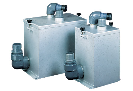

It is extra but most people add them. External filter.

50 feet of 2.5 inch will help.
You won't be able to use the 2.5 inch on the live reel live because it is a 2 inch opening on that reel.
Hook up that 2.5 inch to the top of the tank and with no Butler external filter get Tom's filter.
I can help you with how to set up the hose on the reel to carry it.
