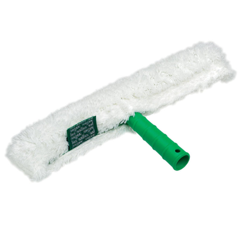

You guys are killing yourselves. The easiest way to clean partition walls is to use a Strip Washer. Use a good bonnet cleaning solution like Encap-Punch. Wet the strip washer in a bucket of solution and wring it out. Then wipe the partition. I've cleaned a good number of partitions this way - including the tall floor to ceiling "air walls" that divide large banquet rooms. It's easy, it's low moisture, and it gets the job done.
S
Shane Deubell
Thanks Rick!
We'll have to try that out.
