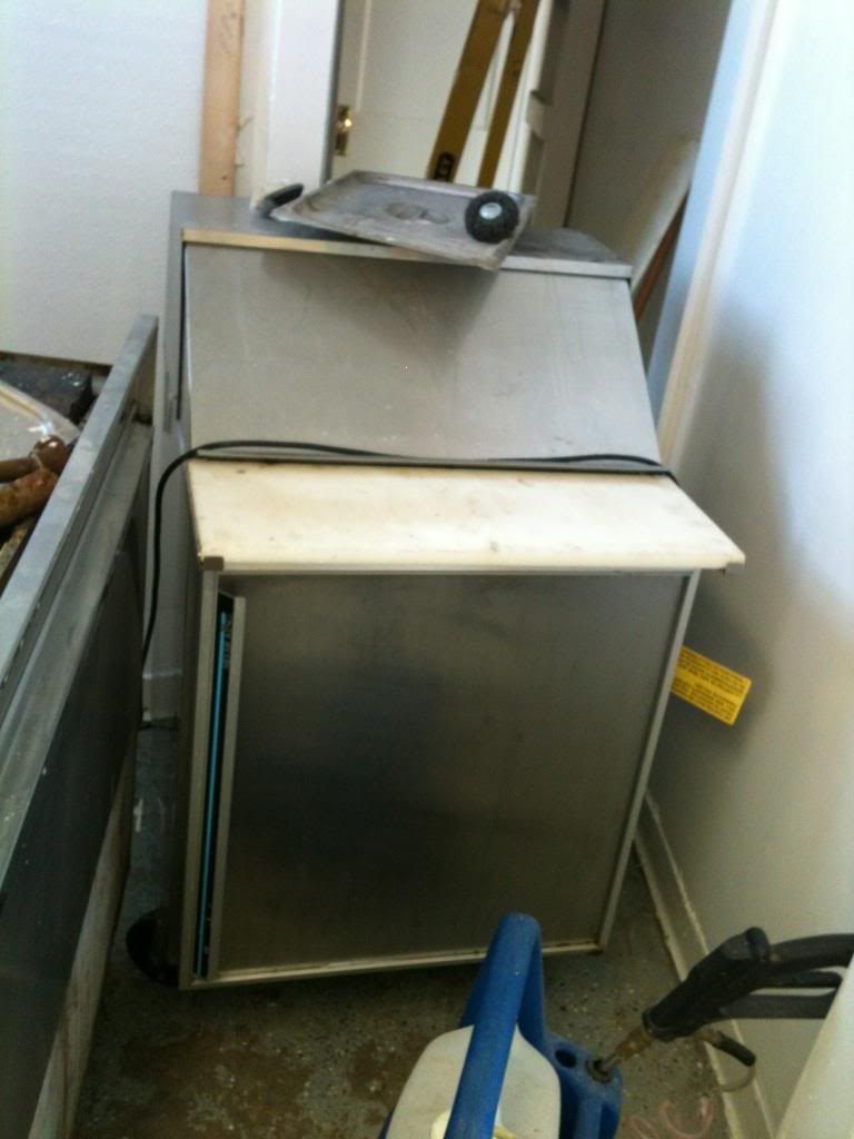

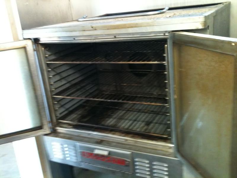

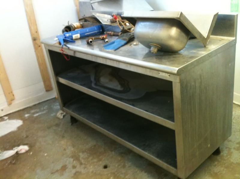

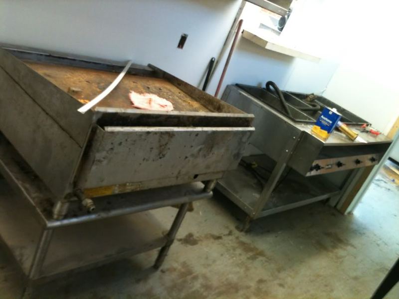

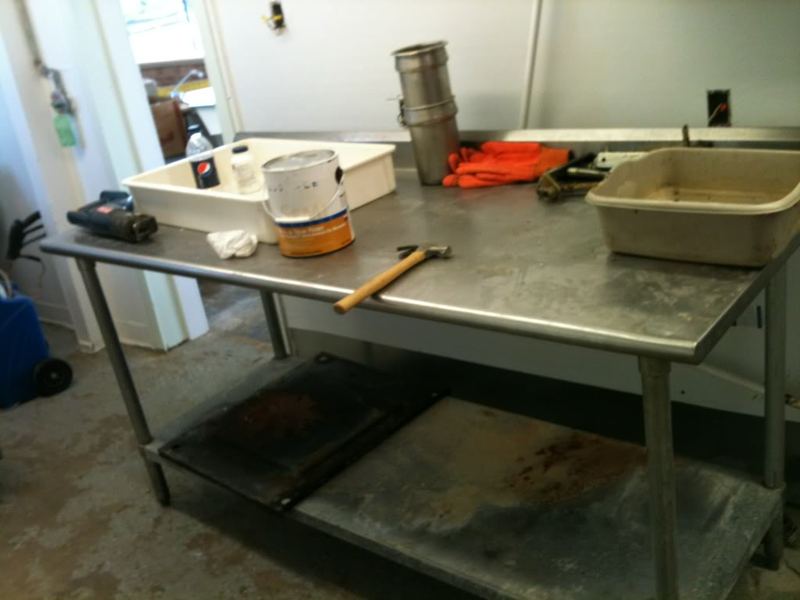

I have a new custy who is reopening a restaurant that has been closed for over 3 years.
It was closed for failure to pay their taxes. Needless to say, the previous owners didn't clean up the equipment.
The new owner has tons of stuff for me to do, one of which is to clean all the stainless steel in the kitchen:
2 tables
1 oven
1 stove
1 sink
1 ice maker
and a 2' x 16' upper shelf.
After sitting for 3 years, some of the grease is pretty caked-on and stubborn.
What is the best product to clean stainless with?
I'm starting the job on monday, so what can I use that I can buy locally?
And, how do I charge for this?

Yes not all stainless is equal, and I would never use it in a residential setting without precautions, but lets keep this in perspective in regards to his pics....theres nothing to be maintained esthetically. Commercial restaurant equipment can take it, and I would think that if there's any chance at making some money on this, it would be to break out the big guns.
Dilute, rinse well, nothing to worry about, done did it before.
