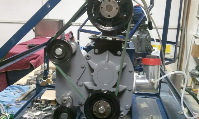

the concentrics are not a tensioner per se......better
they keep the belts tight lik they should be.....PLUS you can change the belts in about three minutes.....

THIS is the proper way to tighten yor belts...
a BRACKET with two concentrics.....
i've got templates for most 45's and 47's
i believe this is Chris' machine
That is Awesome!
Yes this is my machine and lemme tell ya
It is sweet to be able to tighten the belts. I run the covers for posterity, still takes me about 2 min to tighten either or both belts, routine maint thats a habit now.
Thanks for Everything Bawb!
Friggin Luv U Dude : )
Yea he had it all re-done at the local distributor. Re mounted on a plate with slide holes for adjustment. But I thought they had said it wasn't necessary they had a solution. ???

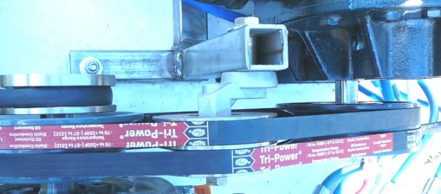

Here is our new ball-bearing stainless tensioner design:
Long lasting & Easy to adjust.

The slotted plate is simple and cheap, and is a very common way to tension belts. Every belt-driven machine in our shop uses a slotted plate to adjust belt tension.
A spring-loaded tensioner is a good thing though, if you're willing to spend a little money and have the room, since you can change belts more easily.
If you find it terribly difficult to change belts you might want to try a link belt. If they stretch, take out a link.
